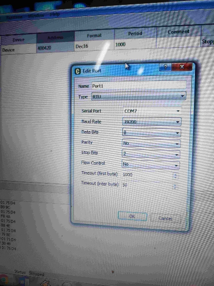

Hello, I am trying to read the spindle load using Modbus. It works fine with the Windows program, but with Linux and mb2hal, it does not. The problem occurs when I attempt to read address 420—it does not return any value, only increments the error counter. Some addresses can be read, but others cannot. What am I doing wrong?Here is the configuration, along with a screenshot of the working Windows setup.
ps now working! i just changed this parameter MAX_UPDATE_RATE
