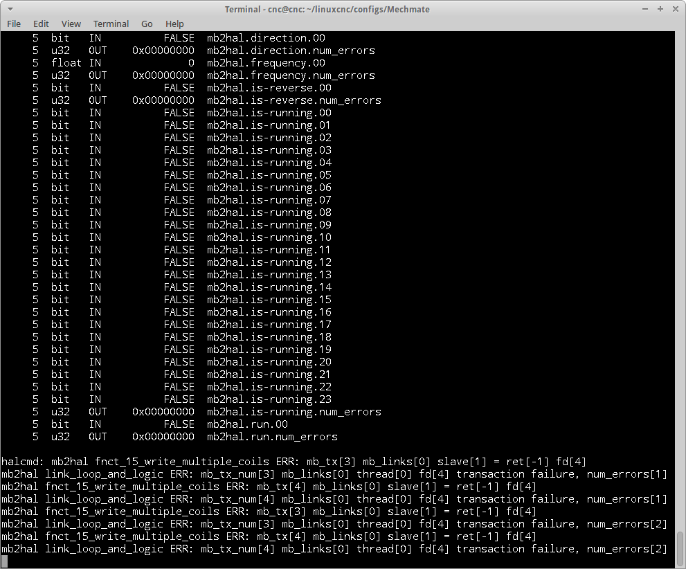

27 Jun 2015 16:14 - 27 Jun 2015 16:15 #60185 by racedirector
Replied by racedirector on topic Modbus Help - MB2HAL
OK, found I I can't load mb2hal in the named format, fails to load. That is unless I am doing something wrong.
I have another problem. I am trying to read a bunch of coils to give me information on the status of the drive. I am using fnct_15_write_multiple_coils as none of the others seem to fit. In the coil list a few posts above I am looking at:
0003h External Trip
0004h Trip Reset
000Eh Run/Stop Status
000Fh FW/RV status
0010h Inverter Ready
0014h Alarm Signal
0018h Frequency Arrival Signal
Based on my previous success at numbering the elements I am assuming the following:
0003h -s element 2, 0004h = 3, 00Eh = 12, 00Fh = 13, 0010h = 14, 0014h = 18, 0018h = 22
which I set up in my ini file (attached). However I am getting errors coming back from mb2hal for those settings. I am also attaching a screenshot of a couple of the errors. Oh, and al the pins are there because I was trying something different but the errors remained the same.
Does anyone know what is possibly going wrong?
Cheers
Bruce
Last edit: 27 Jun 2015 16:15 by racedirector.

29 Jun 2015 17:07 #60253 by VNR
Replied by VNR on topic Modbus Help - MB2HAL
0003h External Trip
0004h Trip Reset
000Fh FW/RV status
0014h Alarm Signal
You cannot "read" using "write" functions
use fnct_02_read_discrete_inputs for single (true/false) status
or use fnct_03_read_holding_registers for registers containing values
