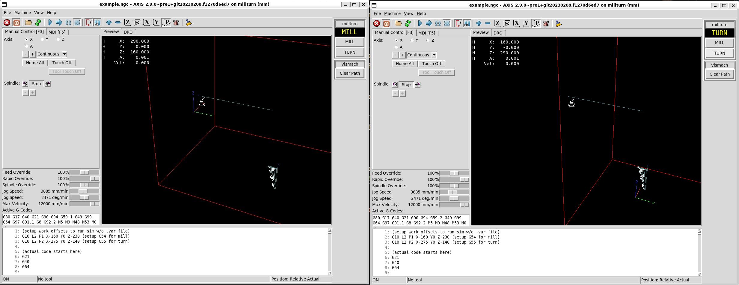

could you use Switchable kinematics ?
for example you can run the millturn configuration - it rotates the Z axis on 90 degrees.
linuxcnc.org/docs/html/motion/switchkins.html
linuxcnc.org/docs/html/man/man9/millturn.9.html
