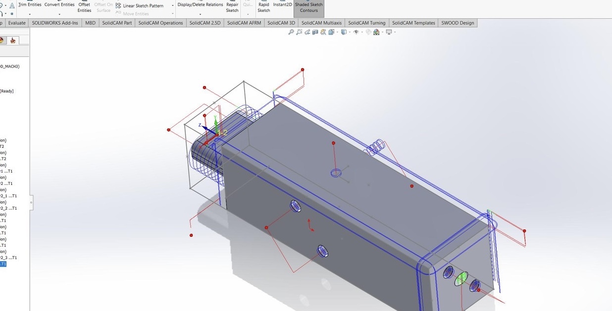

I don't know the way, maybe working on the postprocessor itself would help.
youtube.com/shorts/fRpVFvaf_1Y?feature=share
if you use solidCam, i have one that has the possibility of programming side drilling, milling, milling at a fixed angle.

I manually did that to finish the job, but it doesn't address the behaviours like tool length offset which are associated with Z.
