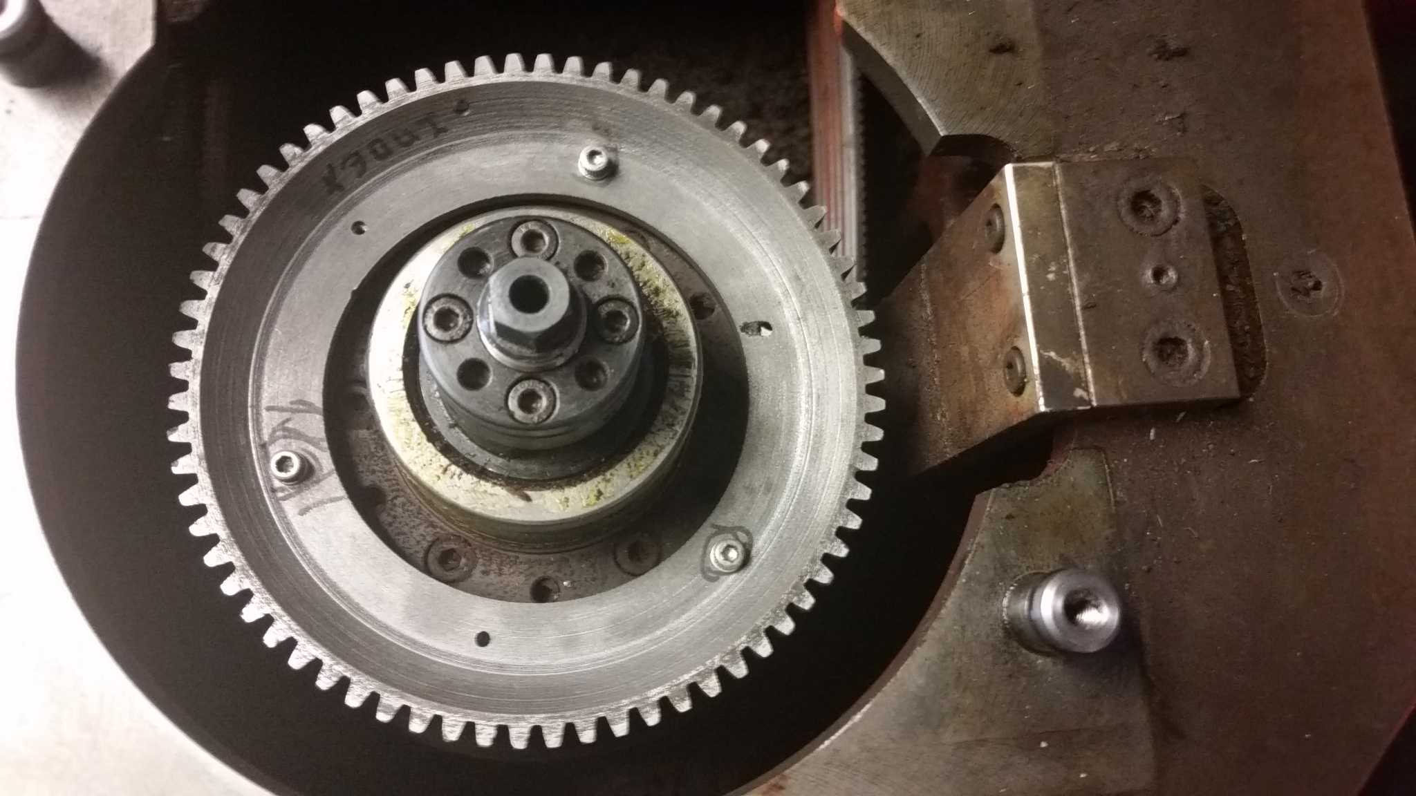

We purchased this machine a couple years ago. It is an early 80's model with a mx1 control. The servo and spindle drives work just fine so we are planning on re-using everything that we can.
Going with mesa (of course)
We lucked out an all the axis encoders are 5v differential (some had 12v)
The setup is going to be
That will give me
-6 axis of analog out/differential encoders
-72 i/o
-panel interface MPG's and i/o
-expandable

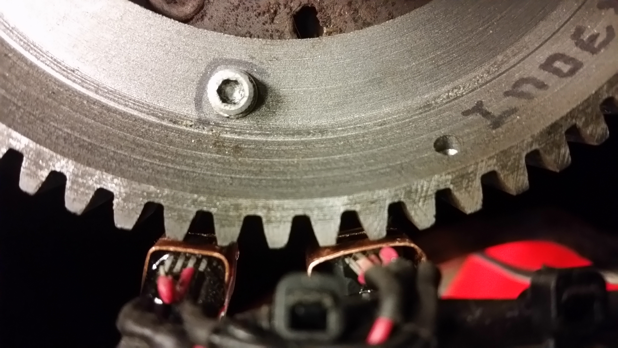

Currently We just started and only have worked on getting a basic spindle encoder installed. It doesn't have one and we would like to be able to rigid tap.
We are using gear teeth sensors to do the quadature+index (they are not mounted yet)
This is a 69 tooth gear.
This will be slow going as I will only be able to work on it a few hours a week.
sam

Nice gear install.
Are you using a 7I80HD-16?
Which Opto22 cards do you use?
JT
JT

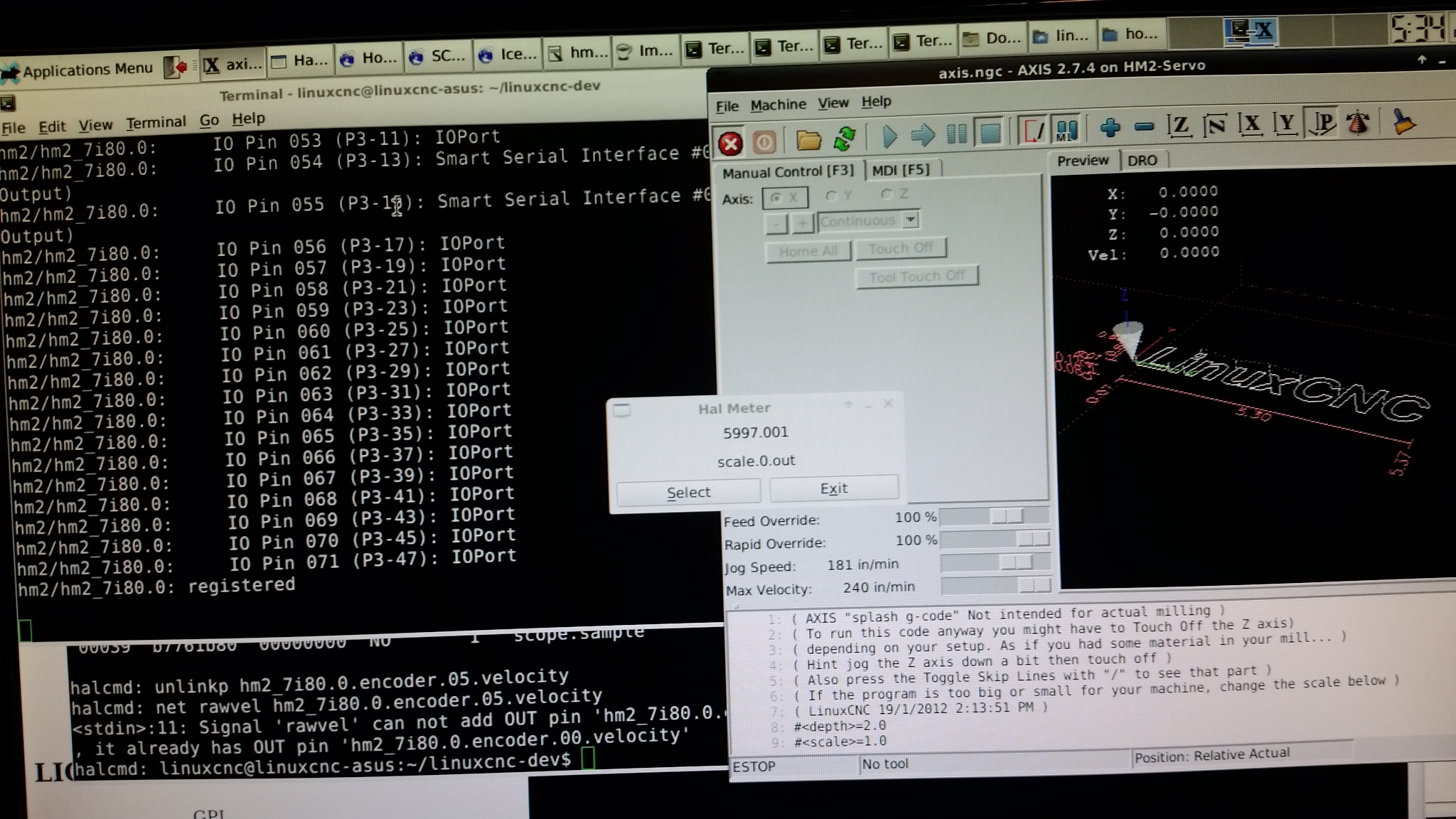

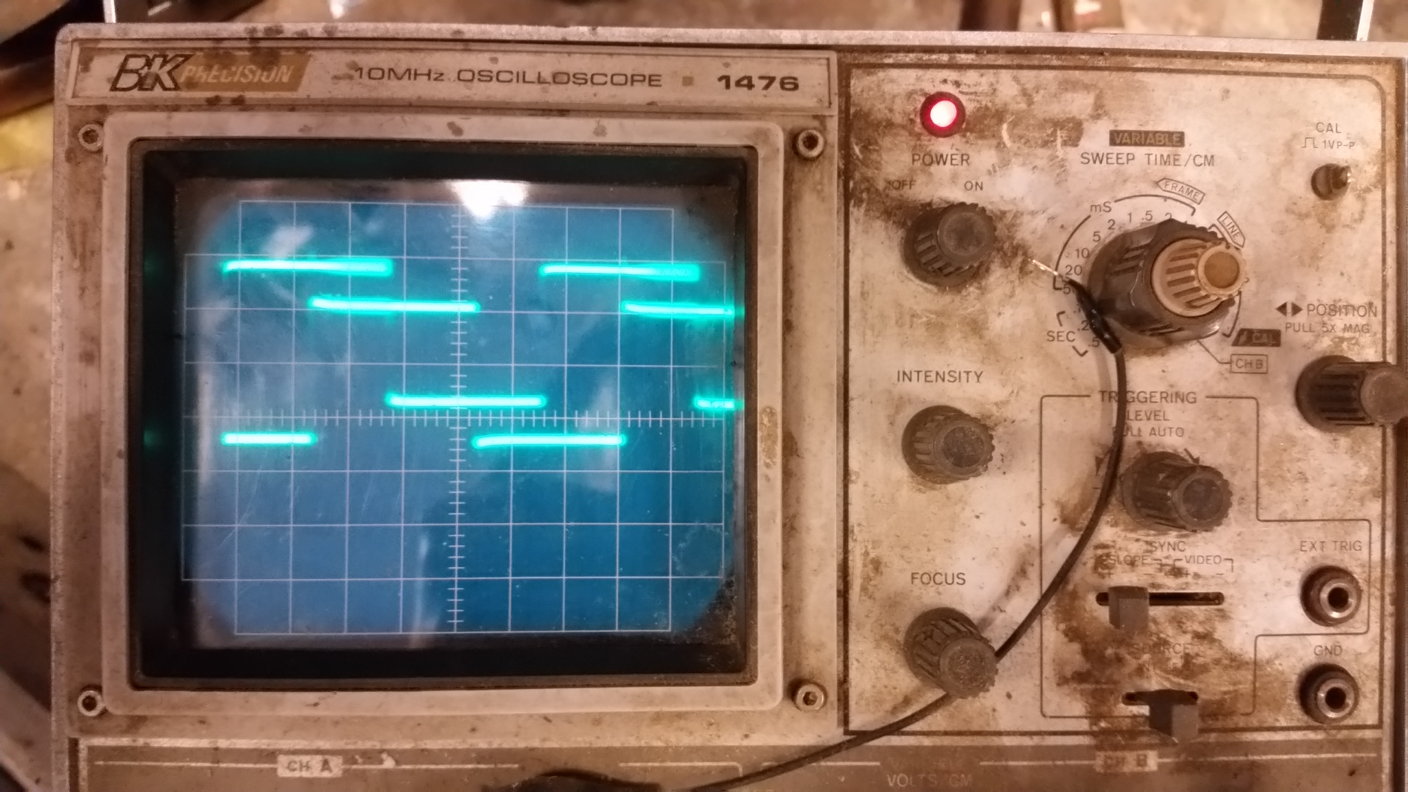

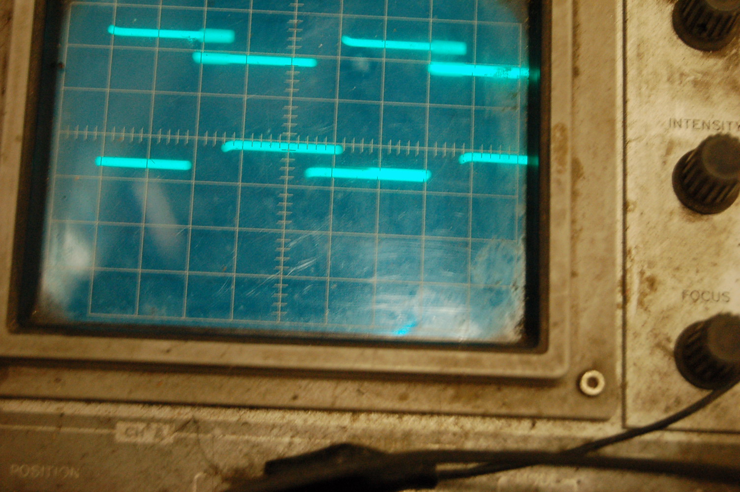

04 Apr 2016 18:21 #72733
by skunkworks
Replied by skunkworks on topic Matsuura Mc 500v2 retrofit.
hooked the spindle encoder into the 7i48. seems to count and sees the index.
