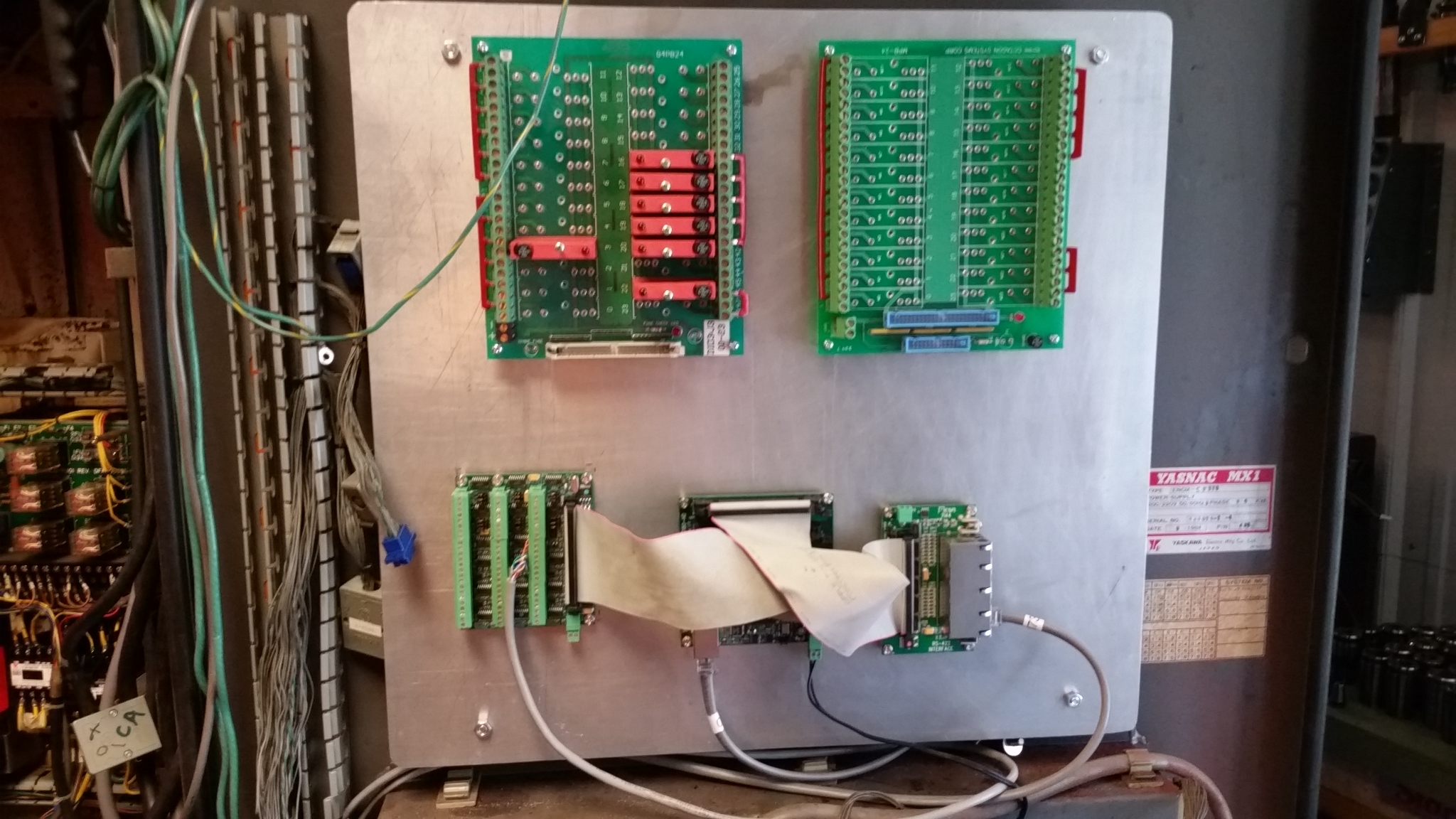

Looking good!
I have an Opto22 and it has two terminals marked + and - do they power up the Opto22 board?
JT

I have not gotten back to figuring out the opto22 boards.. Soon.. IIRC - you can either externally power the logic side of the boards or you can power them from the 50 pin cable (mesa) Which is the way we are doing it on k&t. again - iirc. also I think on some of our opto22 board I had to solder a jumper to make the cable power work.

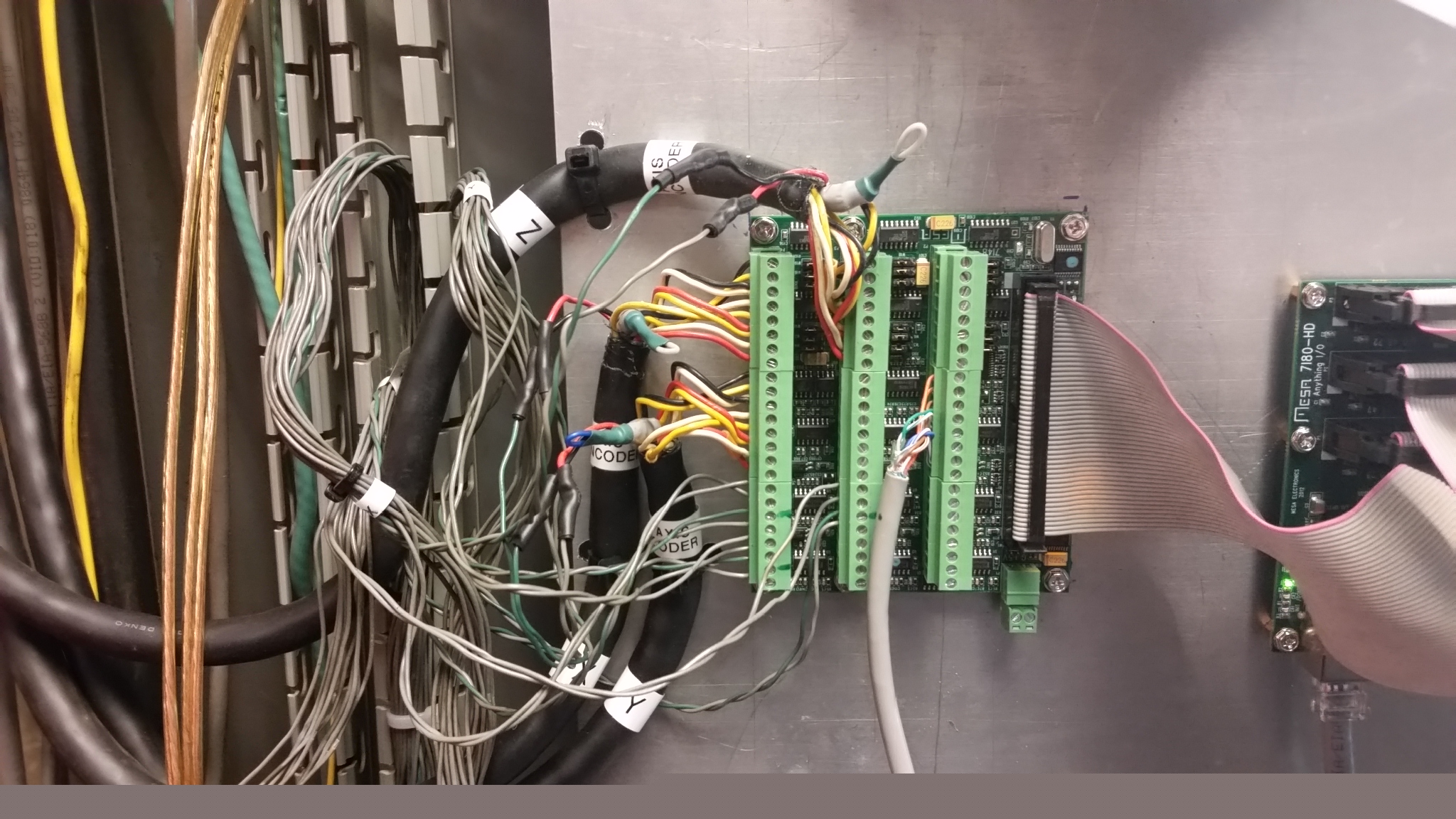

Counts per inch on all axis seems to be 25400 (micron - .001mm)
(encoders are hooked in and counting)

Got the spindle drive hooked up. Still have to tune the servos - it came up and ran without a following error - it has been fine for testing.

up to 300ipm each axis (15in/s^2)

working my way through the tool change logic..

Replied by emcPT on topic Matsuura Mc 500v2 retrofit.
Hello,
What do you use to label your wires? It is retractable tube with printed labels? If so, how do you do it?
That machine is quite a good machine. Congratulations.
