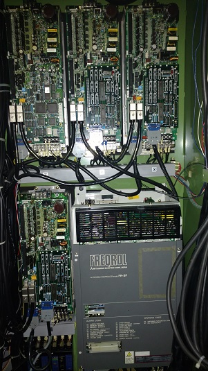

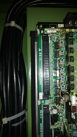

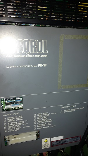

IBAG is a brandname of a spindle manufacturer. Apparently the last owner of this machine replaced the spindle in 2004. They went to OKK for a replacement, and there was not one available, and OKK was not going to build another one so they went to a third party to provide a replacement spindle. It still uses the Mitsubishi spindle drive, but not a Mitsubishi motor anymore.
Andypugh - I believe the drives are analogue-voltage controlled, but I have attached pictures of the drives for clarity.

From a Google search the RG101 cared fits on a Meldas Drive.
Not found a lot more than that yet, though.

The Mitsu drives seem to be very expensive. However I don't think that their motors work with other drives.
Do you have part numbers for the motors? Perhaps there is a more affordable and more "open" drive available that can work with the existing motors.

The x axis motor is a HA200C AC Servo Motor. Says MFG DWG. Z653193.
I was under the impression that the Mesa interface boards would be wired to the existing servo amplifiers to control the motors. Would this not be the case?

Yes, this would be the normal solution. But you seem to be saying that the drives are broken and are with Mitsubishi, and that you are not optimistic that they can be fixed.

The Meldas control is at Mitsubishi, not the Amp Drives. The Amp drives appear to be functioning properly.
