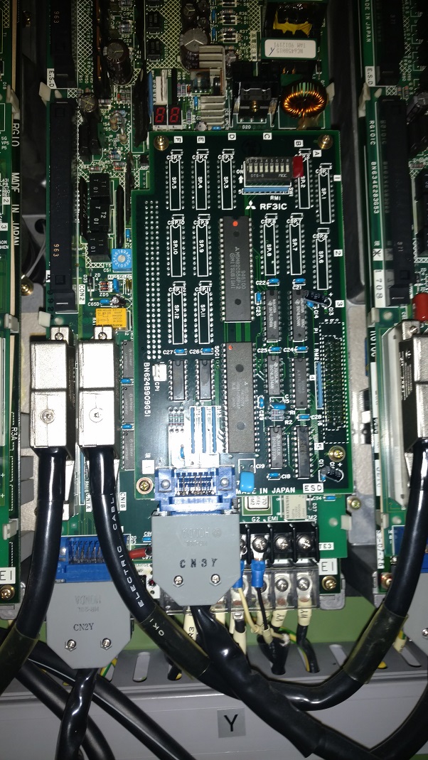

The connections to the servo amp are as follows...
(looking at the Y axis drive)
CN2Y = feedback from the motor encoder
CN3Y = Feedback from glass scale
the 6 heavy wires below CN3Y are 3-phase in/out
The two smaller wires I am unsure of at this time, but possibly tachometer?
The two large silver connectors to the left go from the Medlas control and daisy chains from drive to drive. There is a dip switch on the top board of each drive that you set to assign it which axis it is controlling.
I hope that is clearer than mudd. I really appreciate your help and feedback about this project. I do have all the original manuals for the machine, which is promising, but it does not have things like information about the breakdown on the IO of the servo amps themselves, I will have to start digging deep and see if I can find something.

You might trace the black and white wire out and see where they end up an if that sheds any light on the connections.

I suspect the servo drives are these ones ((MR-S11 xxxx)
Here's a link I found:
s3.amazonaws.com/Icarus/DOCUMENTS/Mitsubishi_Manuals_1060.pdf
Unfortunately these are smart drives that use some kind of serial or parallel bussed connection
to the controller (they are neither analog nor step/direction) so will be hard to drive.
There might be some hope if the interface protocol/register map was documented somewhere

Good eye PCW! I looked a little closer, and behind the 3-Phase power connections I found the model number sticker for the whole drive unit. Looks like the Z uses MR-S11-300-E01 amp, X and Y use MR-S11-200-E01, and the 4th uses MR-S11-100-E01.

The manual PCW linked shows the black and white wires to be the motor thermostat for overheat detection.
