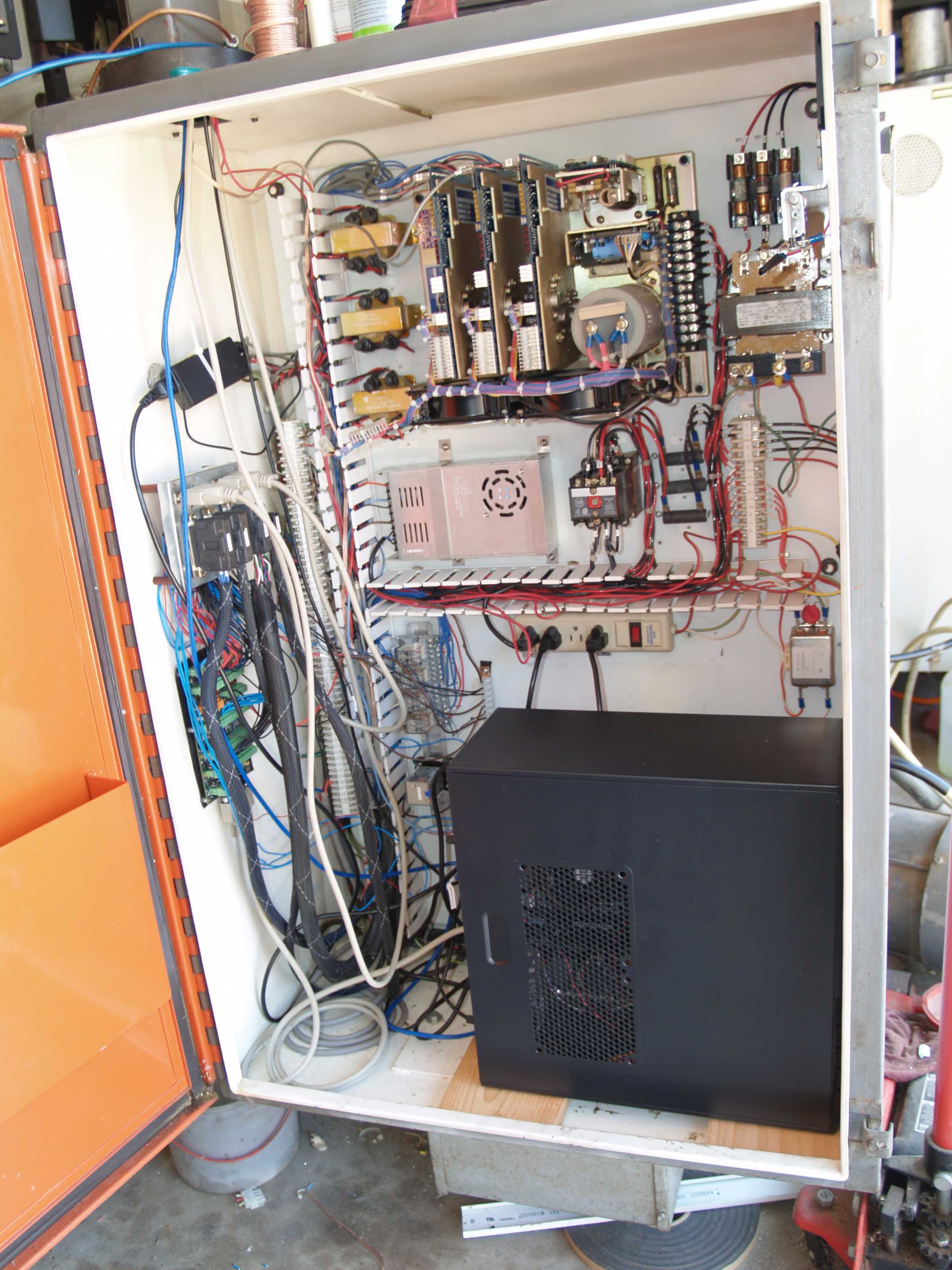

Did you get a chance to review the hal file? Did It look ok or is the low voltage due to something else?
If the problem is the board then I would like to get a RMA so I can get going on finishing my retrofit.
Thanks.
Thanks.

The hal file looks OK (though its only part of the hal file)
I will issue a RMA on Monday

Sorry about the missing information. Since we were talking about changes to the hal file with the setp commands in it, I assumed that was the file you wanted.
Attached is a zip file containing all of my configuration files. If it is something that I am doing wrong in the setup, I would like to avoid wasting yours and my time RMAing this board.
I would also be amenable to running any sort of test hal file that you may have which could help troubleshoot the problem. As you can see in the following photo, I designed my installation in a very modular configuration so I can easily unplug the connectors on Panel B, and this completely isolates the 7i77 board (A) from my entire system other than the 24VDC supply power going to connector TB2.
I am more than willing to put in whatever effort I can to get this board up and running.
