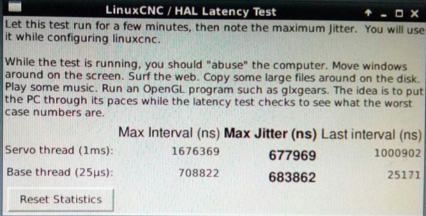

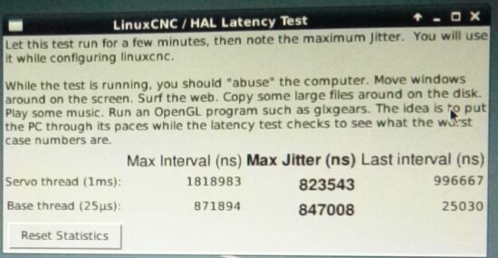

also tell me about the latency test, which type of system i would buy to have max jitter less than 15-20 ms
i tired four of my systems they go above 110-220 ms, according to manual that doesn't give best performance. !!
08 Sep 2016 20:08 #80248 by andypugh
The systems you have may be capable of improvement, There are things you can do in the BIOS, for example, and in the grub boot options.
What was the latency of your 2.4 system? Why not just upgrade that?

10 Sep 2016 07:29 #80286 by boy777
got some images from 2 of the systems, all aren't uploading
it variate much, [ 677969, 30039 , 26280 , 674047 , 2189 , 51214, 823543 (ns) ]
why it variate much ? what you recommend ? how can i improve ?
