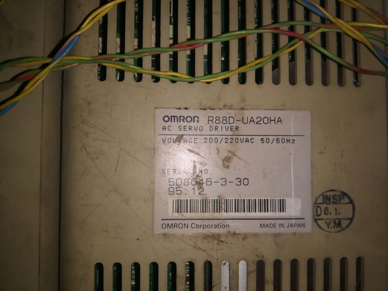

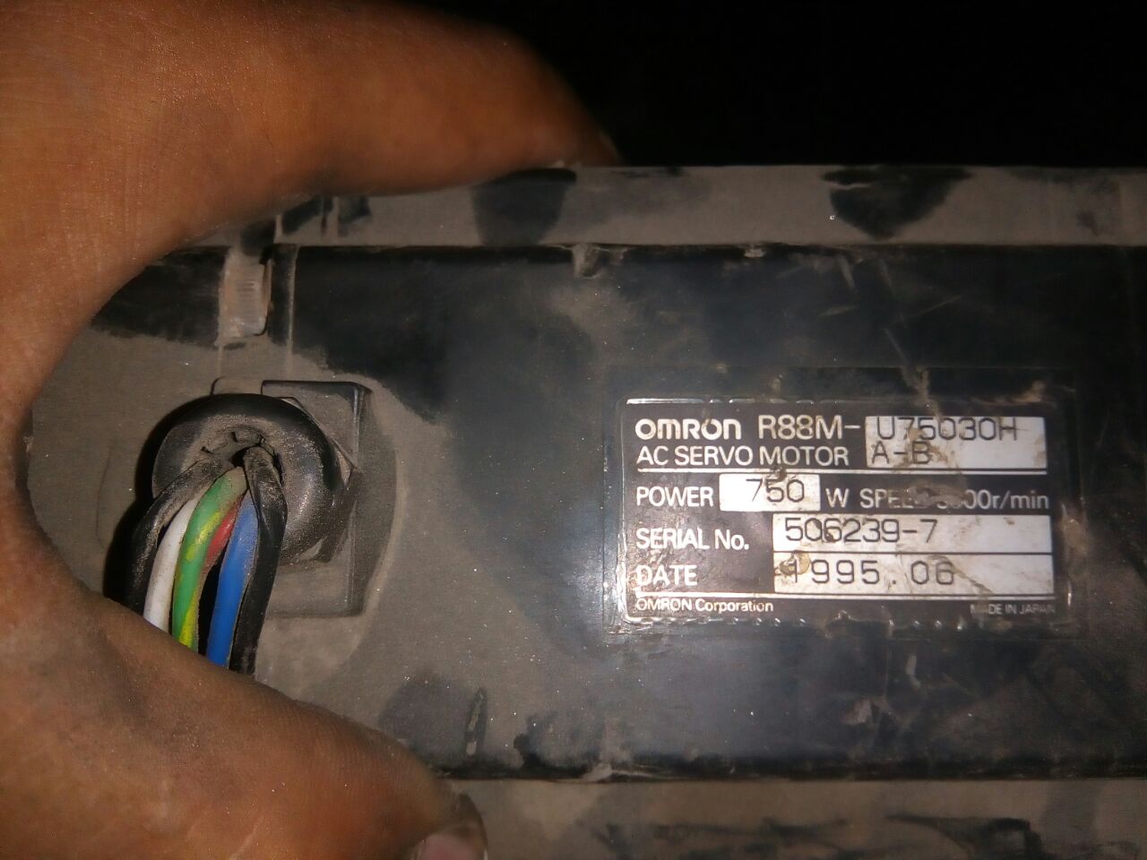

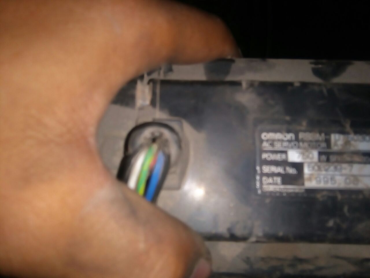

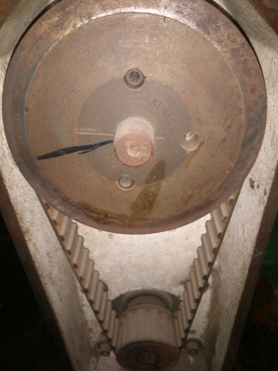

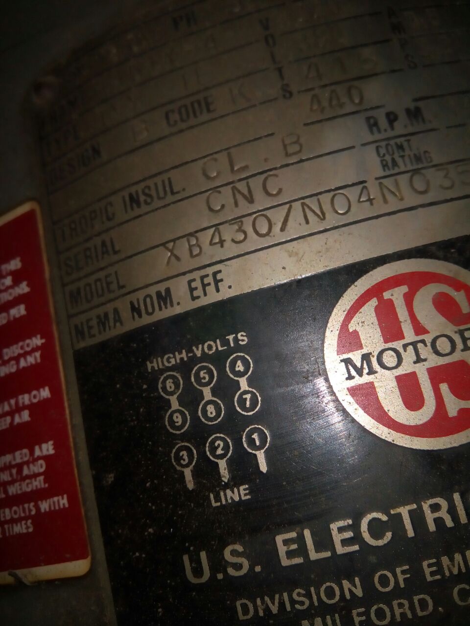

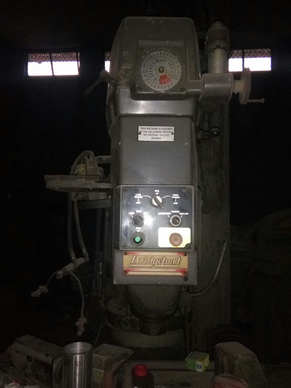

I was in some problems.
These are the pictures and the configs I already sent.
Inform me about it .
Issues occuring . Tired much but not solved
Replied by boy777 on topic Cant it be solved ? LinuxCNC slows down even dead
What machine type, drives, motors, ballscrews, belts, rack and pinion, etc.
Pictures would help, attach the config files, if possible.
Regards
