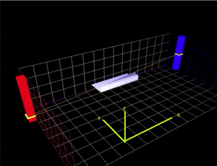

Hello ,
I am building a 4 independent axis hot wire CNC (like picture) for my graduation project and try to use linuxCNC because it supports 9 axis.
The problem is that i can't modify the (HAL and INI) files so that linuxCNC supports YZ and VW planes insteads of XY and UV planes.

I want to follow the standard axis order :
: so that when using a CAM software it didn't conflict

i don't know how to change in cam post processor but when i read about LinuxCNC and saw it's 9 axis ,then i can use yz and vw .
the machine could use rotational axis about Z (axis C) So any changing in orientation of standard axis it will be messy.
I found foam setting in axis but it doesn't run motors ?!! and stepconfig doesn't have foam or xyuv (just xyz and xyza)

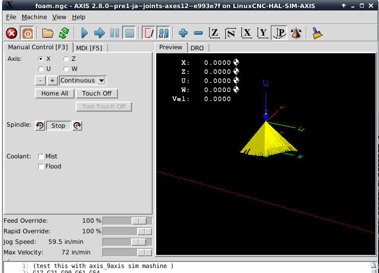

Yes, the "sim" configurations are simulators, designed to show what a machine would look like.
(Some even include a 3D model of the machine, look under sim/axis/vismach for those examples).
You are right, stepconf can't make a foam cutter config.
However, you can make an XYZA configuration and hand-edit the HAL and iNI files to make it into a FOAM configuration.
If you look at the sample foam configuration you can probably work out the differences.
The main changes are, in the INI file [DISPLAY] section
I tried to set up an XZUW machine, and it can be done, but Axis doesn't know how to display it, so I suggest not doing it:
GEOMETRY = XY;UV
FOAM = 1I tried to set up an XZUW machine, and it can be done, but Axis doesn't know how to display it, so I suggest not doing it:

i changed the ini file like you did and there is no changes in axis !!
i saw in the internet some people build robots !! how it's done ?
28 Oct 2016 17:42 #82198
Replied by andypugh on topic foam hot wire CNC YZ VW planes
Are you sure you changed the correct ini file, and that you put the new lines in the correct section?
- hosa200
- Posts: 10
28 Oct 2016 17:44 #82199
by hosa200
Replied by hosa200 on topic foam hot wire CNC YZ VW planes
yes , i opened stepconif and after finishing i edit the ini file and save it then opend the shortcut in the desktop and n changes
28 Oct 2016 18:17 #82201
If you change the "MACHINE" name in the INI then you will see that in the header bar of the Axis window (<filename>.ngc Axis <version> on <machine name>). That is one way to be sure that you are opening the config file that you think you are opening.
It might be easier to be sure by starting LinuxCNC from the CNC menu.
