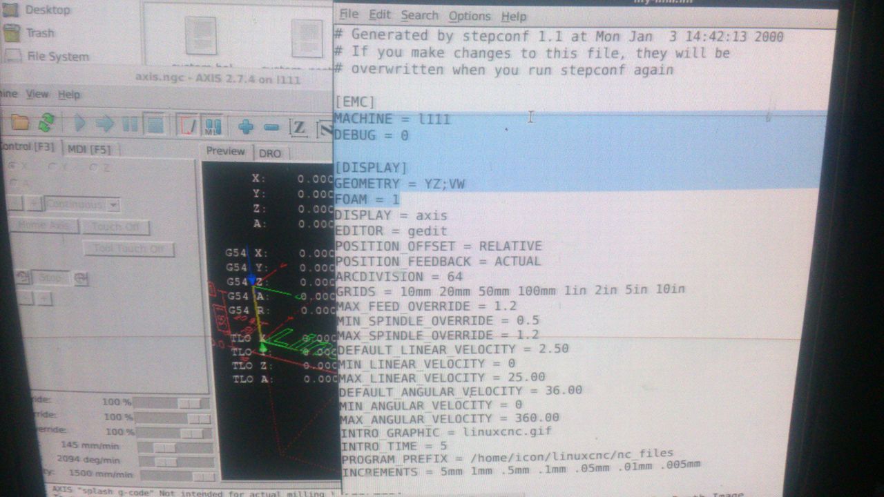

how to edit the simulation of foam machine so that i use it to control the machine in real world
Last edit: 28 Oct 2016 18:46 by hosa200.
28 Oct 2016 20:11 #82209
That's actually a fair bit harder than changing a config that does turn motors into a foam config.
If you look carefully you will see that your Axis screen is actually now a FOAM one, you have two coordinate origins, XY and UV.
The reason that the DRO still says XYZA is due to a separate setting that needs to change [TRAJ] COORDINATES
Replied by andypugh on topic foam hot wire CNC YZ VW planes

In this case I will tend to agree with you a bit, because the FOAM setup options are not well documented.
But, also, you are trying to do something difficult.
Zip up your XYZA config (assuming it moves the motors correctly) and attach it, I will convert it to an XY:UV config. (I don't think that XZ:UW can be made to display properly)
why it's too hard to deal with linuxCNC !!!!!

there are edm wire machines in real world that uses planes like what i want and with rotational axis and so one
28 Oct 2016 20:40 #82213
Yes.
You can certainly use XZ:UW planes, there is no difficulty there. But you will not be able to visualise the cuts properly in the Axis preview. The Axis FOAM view only works for XY:UV
Yes.
