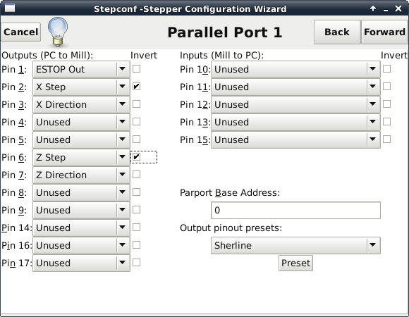

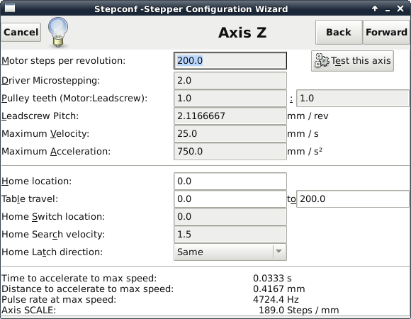

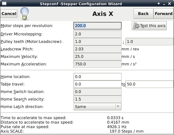

I am new to Linuxcnc.
I am using a DB25-1205 BOB with a DQ542MA Driver. I know that it works because I can use it with Mach3, but when I switch over to Linuxcnc the motors will charge and hold but will not move with the “test this axis” in the setup.
Latency Test = 16116ns
Step Time = 5050
Step Space = 5050
Direction Hold = 500
Direction Setup 500
X Step (Actie Low) = Pin 2
X Direction = Pin 3
Z Step (Active Low) = Pin 6
Z Direction = Pin 7
Any help would be greatly appreciated.

You will have to make the step time and space 15000, dir hold and set 20000.
Thsoe BOB's are way to slow, you can get much faster step/dir times if you wire them directly to parallel port.

It is parallel port card. The terminal is showing PC-style at 0xa400 (0xa000).
I do not have any home or limit switches hooked up just yet. I can hear the motors energize and they are difficult to turn by hand so I know there is at least some power going to them. I have also checked the wires to the motors with a multimeter and everything appears fine.

and I have my port address set as 0xa400

Edit your hal file, where it says
loadrt hal_parport cfg="0x378 out "
and change that to
loadrt hal_parport cfg="0 out "
save ad restart Linuxcnc

To no avail. Still not even a hint of movement.

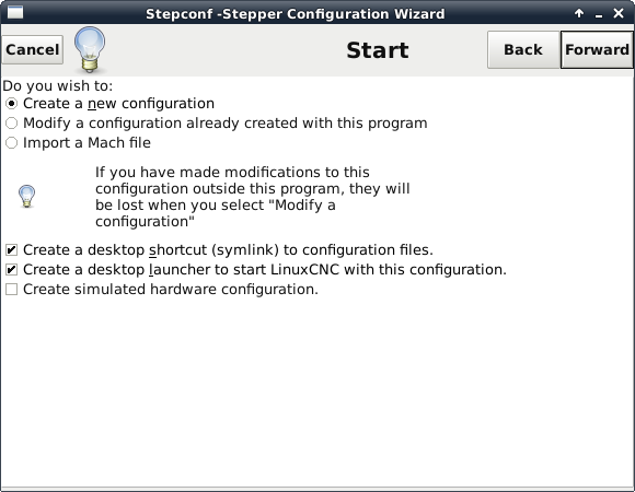

Did you increase the step timing in stepconf? Increase it even higher say 30.000 and test again, you can also change the port address in stepconf as it will override any changes you made manualy.
Also please remove the check in front of "create a simullated hardware......." in the second page of stepconf.
