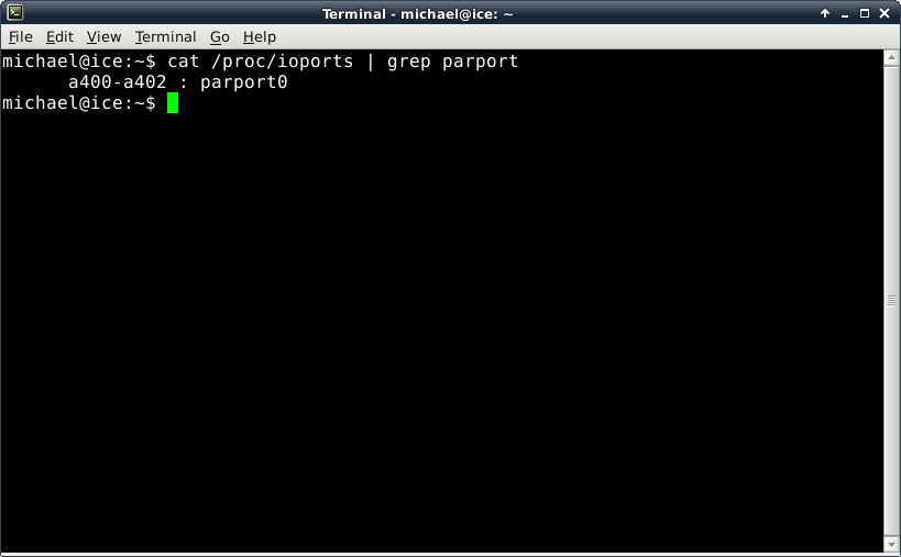

From a command prompt try this command, to double check your parallel port address.
cat /proc/ioports | grep parport
Then show us the results and a copy of your hal file.

- Posts: 21985
- Thank you received: 7485
06 May 2017 17:01 #92748
Replied by tommylight on topic Need Help with Setup
A400 is the address.
Edit the loadrt parport in hal. Also set the base thread to 100.000 in the ini, anything less and that bob will not work.
