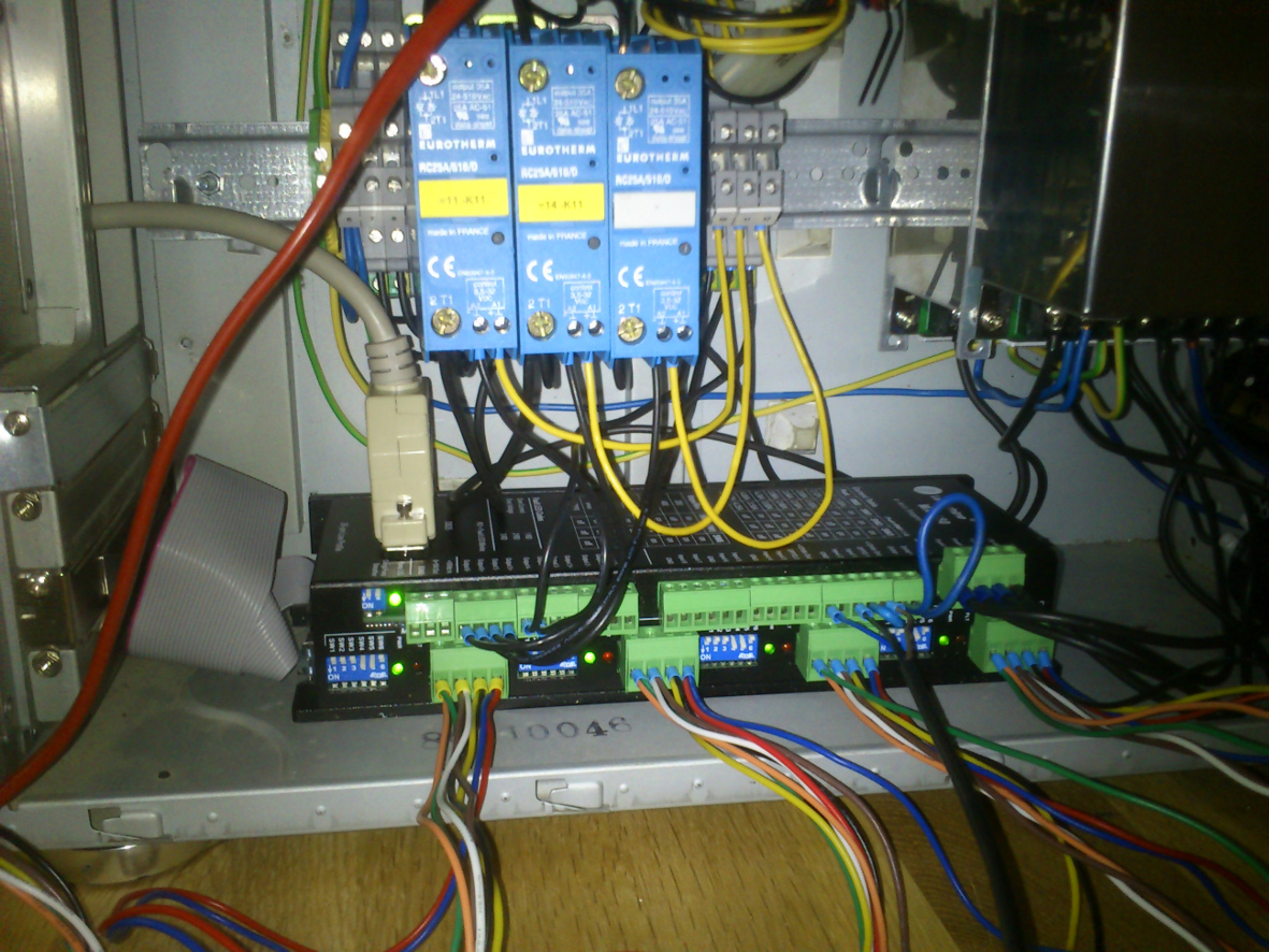

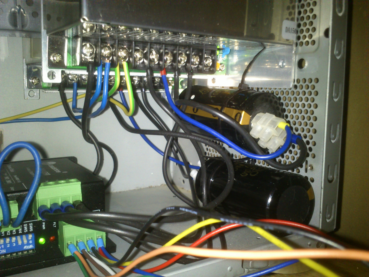

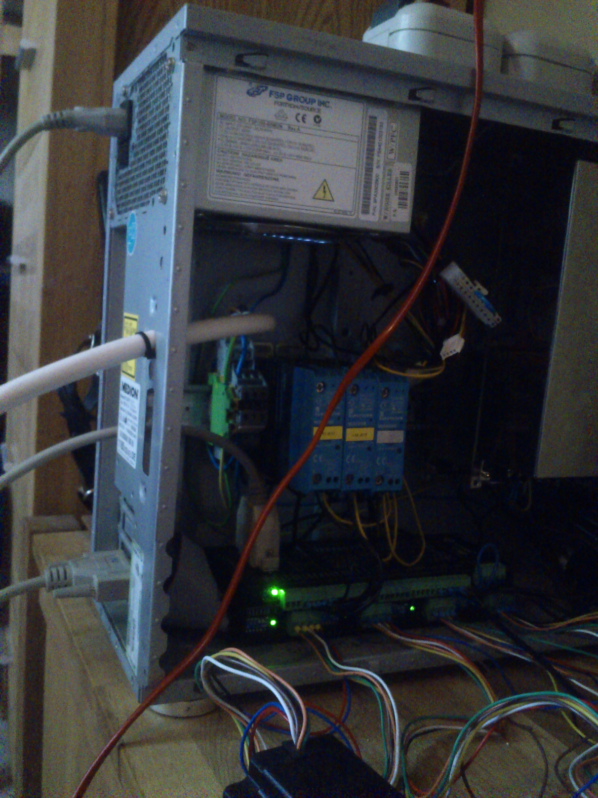

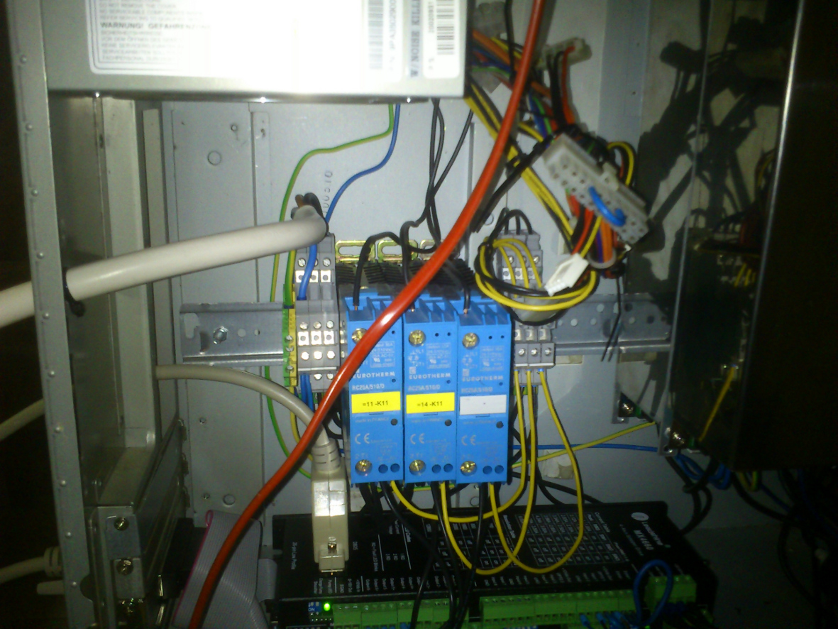

I just want to update you about my progress and the new questions that arose. First some pictures of my switch cabinet. Maybe its not high end, but we are very proud of it!
We wired the motors and 1 of the 4 proximity switches. The problem is now, that I want to have the cleaner, the vacuum pump and the spindle controlled by relays. But when I turn on the Linuxcnc Computer first, it sends a high signal to the Output connection, that means, the relays stay tuned until I start Linuxcnc itself. Have you got any idea how to keep the signal low?
After connection all the hardware, we will try to put our hands on the refinement of the configuration. the idea here is, to have the y-switches at the back of the machine, the x-switch at the left side, and the z-switch on top of the z-axis. Furthermore I would like to home all axis in the back left corner of the machine and measure the toollength as well there.
I will attach the pncconf and hal. If you have any advice, it would be great!
