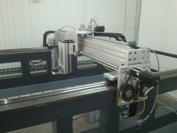

Im back again with some questions. We assembled the Y and X axis and tried to run the first time the machine to measure the work area. There is the first problem: It moves, but very very slow. Could you give me an advise how to get the desired jogging speed of at least 10m/min? In the next days I want to touch the configuration of 3 Axis and 4 joints for the Y. If anyone has a configuration to have a look at, It would be great.
Thanks a lot
Mathias
P.S. attached some pictures of the machine itself...
Thanks a lot
Mathias

Open the .ini file with a text editor ( gedit or mousepad or nano ) and look for max_velocity and max_acceleration, edit them as you need for each axis ( not before finding the right ratio or scale ), save, reload Linuxcnc and test.
Set the scale first.

When I open up the .ini file, there are a lot of VELOCITIES...
The first one is in the DISPLAY area. At the moment at 16.666667. The documentation says something about machine units? Is it in mm, s or rpm? The next velocities are in the joints sections. The values are MAX_VELOCITY = 500.0 and MAX_ACCELERATION = 800.0. At the moment its for all three axis the same, but only X and Y have the same hardware. They have both a rack and pinion drive.
The calculation is: pi x 2mm (modul 2) x 12 (number of teeth) x 0,53125 (gear with 34 and 64 teeth) = 40,0553 mm per revolution. At the moment I have the switches for the microstepping set to 1/10. Thats 2000 steps per revolution and 0,02 mm per step. The Scale I use at the moment is therefor 1/0,02 = 49,93 steps per mm. Is that right?
Thanks a lot and regards
Mathias

Replied by rodw on topic mesa 5i25 and mx4660 installation and configuration
Your calculations look right to me
The jog speed is set by DEFAULT_LINEAR_VELOCITY in the ini file
See
forum.linuxcnc.org/49-basic-configuratio...ge-default-jog-speed
Assuming you have set the default units to be metric, all of the velocities are in machine units per second so 10 m/min gives 10000/60 mm/sec = 166.66667
I think you are running at 100 mm/min (16.66667)
See
