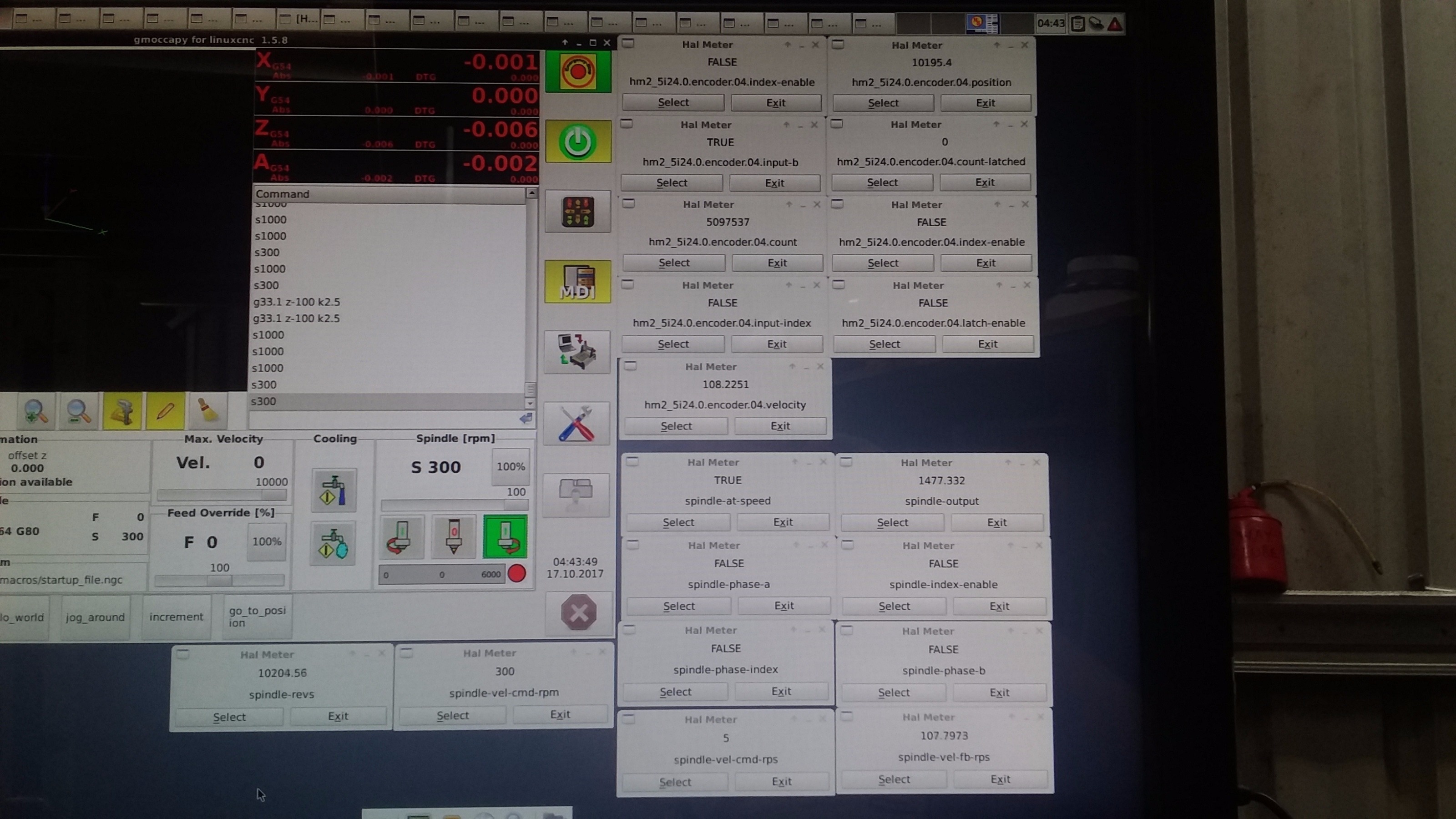

Andrew was able to get the spindle to run correctly in open loop and thus we went back to see if we could then configure the spindle correctly for closed loop (we thought we were having a win, which is why we quickly jumped ahead to ask questions about rigid tapping etc before you and others in other parts of the world went to bed i.e. your night being our day...).
As it turns out though, closed loop didn't pan out and we spent the entire day chasing our tails. Regardless of tuning, we get a spindle which is either running at a steady speed or slowly climbing in RPM, but in either case never locking on to the commanded speed.
I have taken some photos with numerous HAL meter and HAL signals on the screen with the spindle running to help diagnose and will also attach HAL and INI files to provide as much collective diagnostic detail as possible in one place.
Firstly though, just a quick recap on the setup. The motor drives the spindle with a 2:1 pulley ratio (spindle RPM 2 x motor RPM). The encoder is on the motor. The proximity sensor is on the spindle. The encoder has A+,A-,B+ and B- going into a 7i47s. The proximity sensor is being used as the index pulse so we have it attached to an ENC 422, to output as Z+,Z- and this then goes into the same 7i47s. The 7i47s feeds back to the spindle VFD for speed control. The 7i47s connects to a 5i24. One of the questions we have is what parameter Linuxcnc uses as the target for RPM for closed loop? spindle-revs / spindle-vel-fb-rps / spindle-output / hm2_5i24.0.encoder.04.velocity etc??? And whichever one it is, which 7i47s datum does it use i.e. Z pulses, A pulses, all pulses etc??
Even though there is a gearing ratio going on, regardless of what we try we cannot close the loop and have linuxcnc lock the spindle onto a commanded RPM or a logical ratio of the commanded RPM (i.e something which would relate to gearing ratio or encoder count etc...) As mentioned, in fact subject to settings the spindle may experience an ongoing acceleration. Interestingly as well, the spindle-at-speed HAL signal is always "true" throughout.
If I had to guess I would hint at an addressing issue, i.e. there is a parameter we are not bringing into the HAL or have linked the incorrect parameter into the closed loop, expecting to maintain a commanded speed, but with an incorrect or incorrectly addressed parameter hence the attachment of the HAL file and the question as to which feedback parameter is referenced to target for speed control.

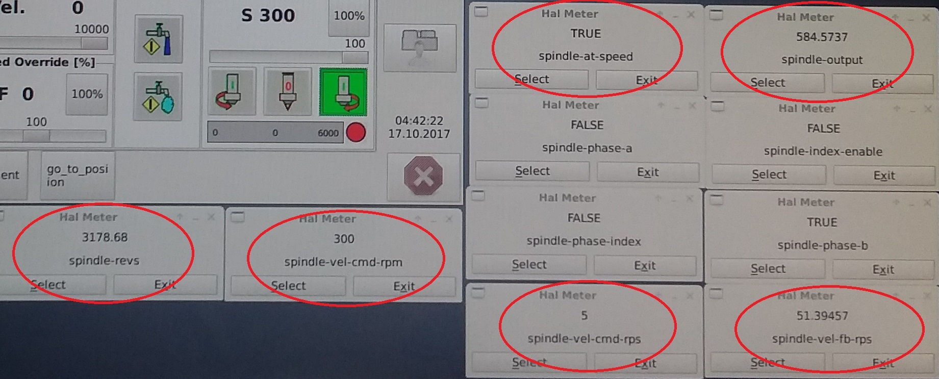

I've included a picture called Spindle Hal Disagree showing HAL meters indicating command RPM of 300 (5 RPS) but spindle feedback at 51 RPS, spindle output at 584 and spindle revs at 3178. As such, it apparently "sees" the feedback exceeding commanded speed, but does not act upon it. In this case, the spindle had a gradual acceleration beyond the commanded speed.
Either way, your help is much appreciated given we really seem to be chasing our tails on this one.
