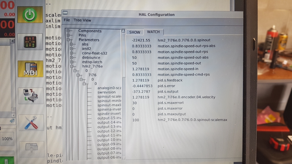

19 Nov 2018 09:47 #120982
by Nitram
Replied by Nitram on topic Spindle control woes
Hi Andy.
I've taken a look at HAL WATCH and seen that pid.s.output is opposite in sign to either M3 or M4 compared to the commanded speed.
Please see attached HAL WATCH pictures.
I also think I have two problems. Specifically I am having a hard time getting my head around where the hm2_7i76e.0.7i76.0.0.spinout pin should go. Ref the mill I have done in the past with PWM control, the output is a "value" and goes to spindle-output (the pid.s.output) i.e.
net spindle-output => hm2_5i24.0.pwmgen.04.value
whereas spinout is seemingly a commanded RPM value, scaled to the range of the motor/VFD. I am having trouble seeing where exactly into the spindle section of the HAL it should go to make sure it is being correctly influenced by the PID loop. I have tried with hm_2 pin spinout-scalemax either commented out or not. The spindle performs differently, but nothing that represents and form of control.
So, given your earlier post I tried to invert the output of pid.s.output (signal spindle-output) by trying a few things.
1. Put a negative sign before the encoder scale. No change.
2. Use a mult2 and multiply by -1 to see if hm2_7i76e.0.7i76.0.0.spinout would reduce its commanded output to the spindle. With some configurations I got very limited success and the spindle would try to reign itself back but it would always end up overspeeding. Also, the value of hm2_7i76e.0.7i76.0.0.spinout would only ever increase steadily, never decrease to reign in the spindle RPM. That said through, it would increase, but the spindle speed would hunt and try to reign itself back in but would ultimately overspeed.
3. Tried to mult2 x60 the pid.s.output (to change the output to RPM) and net it back into hm2_7i76e.0.7i76.0.0.spinout. Again, no luck.
The idea of the pid command going into the negative looks like it does manifest itself as some of the HAL WATCH attachments will hopefully show. Also shown is the constant increasing of hm2_7i76e.0.7i76.0.0.spinout. Is this pin not the primary pin which commands the spindle? In my case the VFD connects to the 7i76e via the psuedo potentiometer spindle control on the card.
Lastly, and not sure if there is any relationship, but from the bottom of the watch window, the spinout-scalemax was set at 100. I have no idea where that came from? The only way to circumvent that was to un-comment the original spinout-scalemax line in the HAL file. Similarly the .ini file has no reference to a scalemax of 100??
setp hm2_7i76e.0.7i76.0.0.spinout-scalemax 2500
setp hm2_7i76e.0.7i76.0.0.spinout-maxlim 2000
setp hm2_7i76e.0.7i76.0.0.spinout-minlim 50
OK, I better go call it a day... I've spent 11 hours on messing with this one issue, I'm pooped...
Thanks again!!!!

- Thank you received: 4654
19 Nov 2018 13:49 #120990
Replied by andypugh on topic Spindle control woes
What is happening here is quite interesting, and not all that uncommon.
For whatever reason the initial spindle speed is a little higher than the requested, and the PID component is reducing its output to bring the speed down.
Unfortunately, once the PID output is negative the spindle drive continues to run positive, and there is a miss-match in sign between pid output and pid feedback, causing a runaway.
Does your spindle actually have the ability to run in reverse? With those outputs the spindle should be running backwards (at 22,000 rpm!)
It would be nice if pid had a "minoutput" setting to prevent it from going in to the negative region, though that is normally not needed for most pid loops.
If your spindle ran in reverse for negative commands then the problem you are seeing would not happen.
The sserial docs should answer your second question, and provide a solution to the problem that you are seeing.
linuxcnc.org/docs/2.7/html/man/man9/sserial.9.html
(say "should" as the wording is a little vague and confused)
...scalemax is the input value that leads to maximum output value. So if full-scale spindle speed is 2500 rpm then you might want to set the scalemax to that.
It is _probably_ easier to work in revs-per-second throughout, though.
(To answer another question, scalemax defaults to 100, you definitely do want to set in the HAL file to the correct value)
So, set the scalemax to the maximum _spindle_ revs-per-second (you earlier said that the max _motor_ rpm was 2500? That would be 41.7 rps) Where is the encoder?)
Then set the spinout-maxlim to +41.7 but set the spinout-minlim to 0 (or, possibly, some positive value). That means that if the pid goes negative then the dive sees zero speed, rather than a large control voltage corresponding to a negative speed.

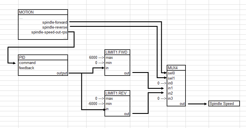

21 Nov 2018 12:31 #121116
OK, so you are saying that the problem lies with your spindle drive, in that it doesn't respond to a direction command once it has started?
Is this configurable? It's not a great feature, and might make rigid tapping impossible. Perhaps this is a configuration setting in the drive?
There are ways to work round this in HAL, I feel sure.
My first idea would have been to use a pair of mux2 to set the limits of a limit1, but that won't work as the limit1 limits are parameters not pins.
So the answer is probably to use two limit1 components, one for forward and one for reverse then choose between them using a mux2.
In fact it might be better to use a mux4. Then connect sel0 to spindle-fwd and sel1 to spindle-rev. That means that you can setp the output to zero on the unused (0 and 3) outputs too.
