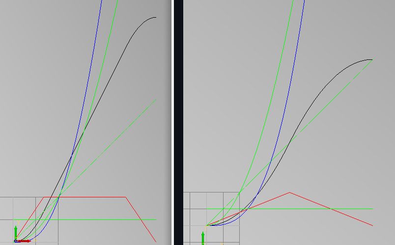

Today i want to show what the benefits of using a scurve with lineair transition period could be.
Picture on the right side:
Scurve with no lineair transition period.
Conventional lineair result:
Picture on the left side:
Scurve with lineair transition period.
Result:
It looks like the scurve with lineair transition period increases the machine displacement with factor 1.57
The scurve algoritme is suited with a "gain" value instead of "velocity begin and velocity end" value's that are
original used by the sientific papers.
I integrated this modification to simplify the scurve algoritme.
When "gain" value = 0 it outputs a conventional straight acceleration period.
When "gain" value > 0. It outputs a s-curve. (magic happens).
If gain value > 2*velocity it outputs a full scurve without lineair transtion stage. (like ruckig's output).
If gain value < 2*velocity it outputs a curve with lineair transition stage.
So it is a fact, this new algo is more efficient than the ruckig algoritme that has no lineair transition period.
- time tot:10
- velocity tot:10
- displacment tot:50
- time tot:10
- velocity tot:10
- displacement tot:50
- time tot:6.35
- velocity tot:6.35
- displacment tot:20.16
- time tot:6.35
- velocity tot:10
- displacement tot:31.75
Result:
