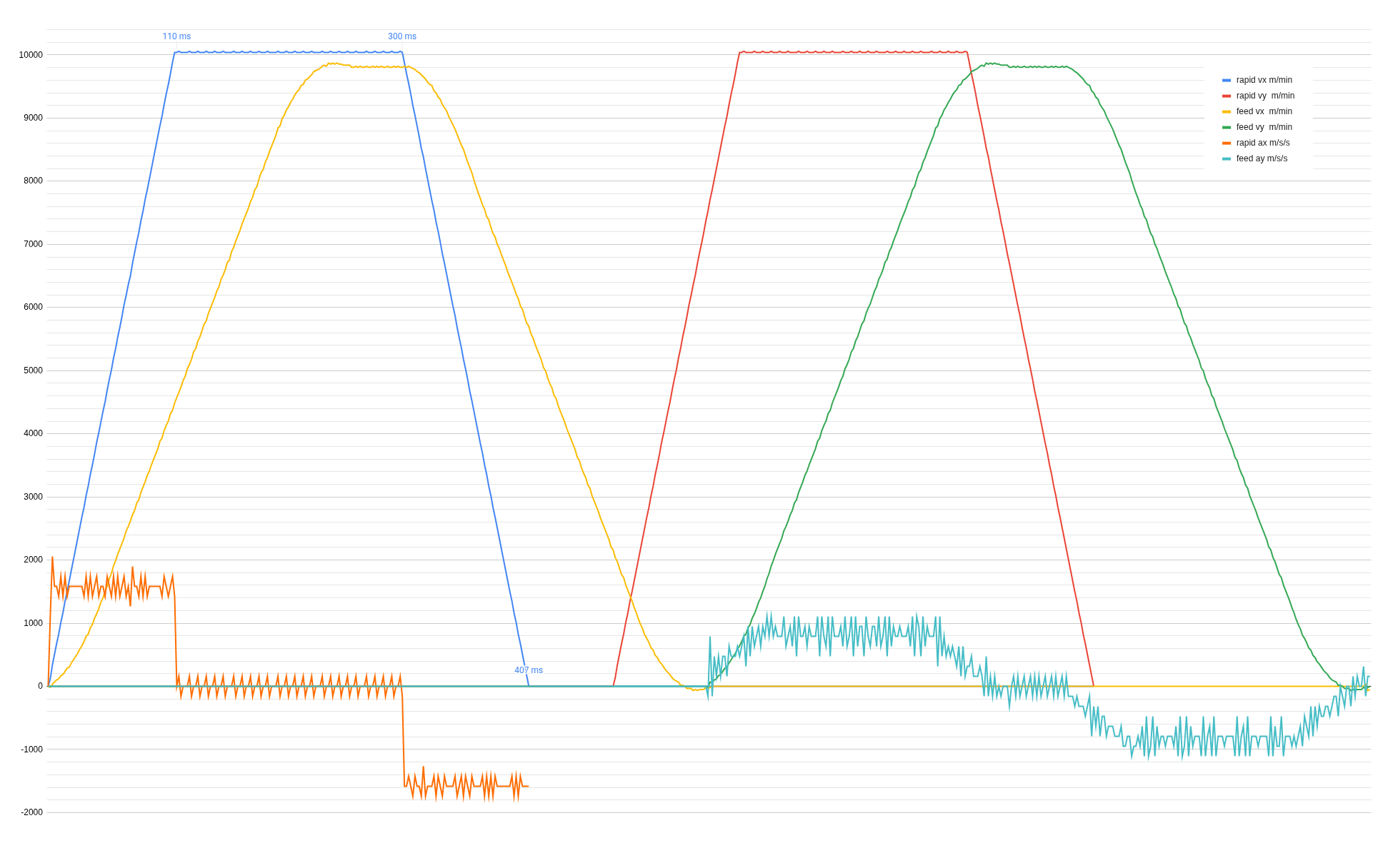

25 Aug 2026 09:09 #348994 by dm17ry
Replied by dm17ry on topic LinuxCNC S-Curve Accelerations
took a log of servo drives commands on a deckel dmc 70v, MELDAS 500 circa 1992, 25MHz 68040 CPU. runs at 1.77(7) ms servo cycle. rapids use trapezoidal velocity profile, cutting feed is s-curve. interestingly, the later overshoots target position up to 20 um and backs off...
