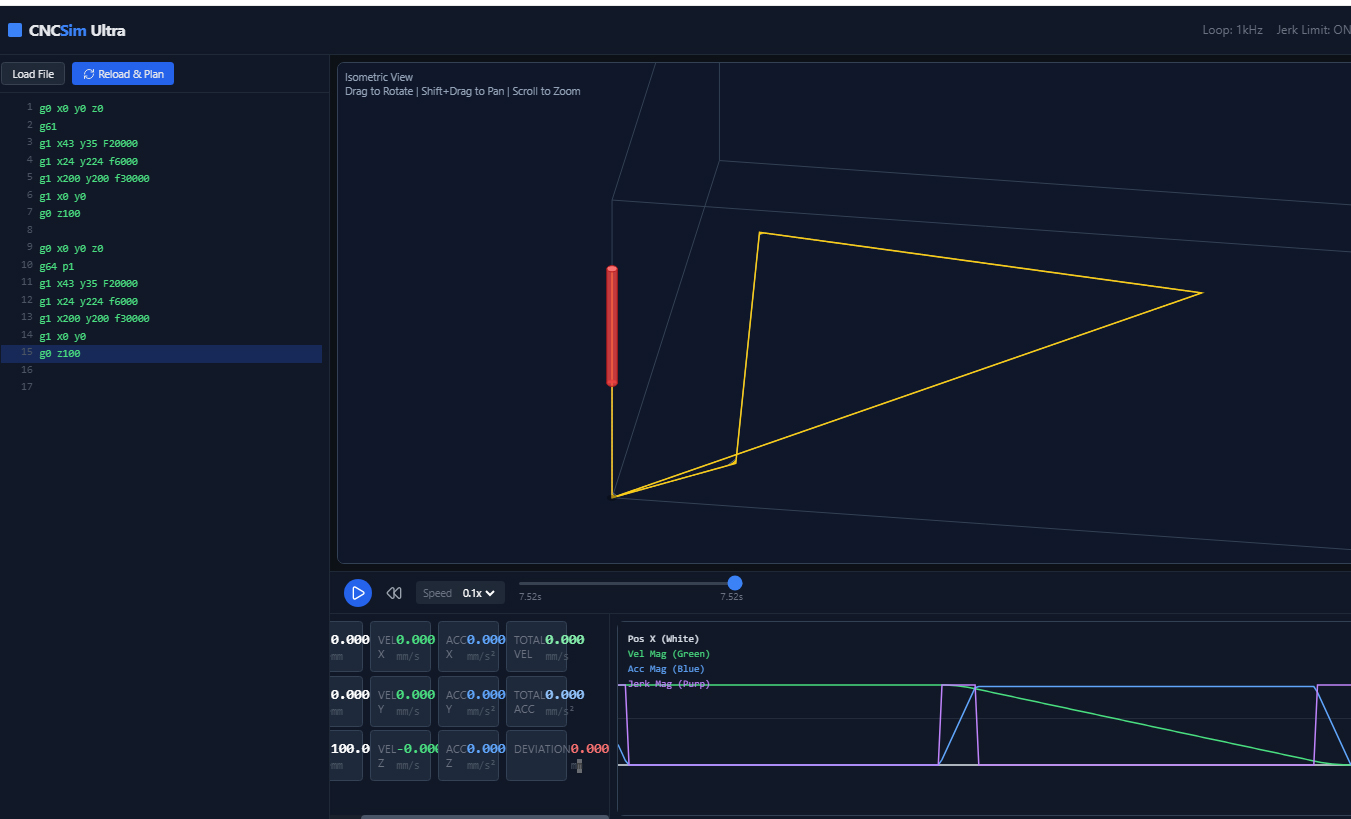

Side diversion, "I" just vibe coded a (very) basic control simulation with jerk limited motion including g64. That's the first actual success I have had with it - prior attempts gave me nonsense trajectories.
How this can be applied to linuxcnc... not sure yet. But it's neat.
