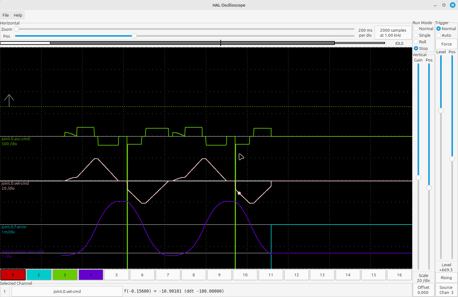

I've been trying to test this on real hardware using Mesa but I cannot seem to get the new planner to work at all.
- [TRAJ] section has 'MAX_LINEAR_JERK = 1000.0'
- both [JOINT_0] and [JOINT_1] have 'MAX_JERK = 1000.0'
- ini.planner_type = 1
Yet running this code in G61.1 mode
I get this:

What am I missing?
G21
F5000
G0 x0 y0
g1 x20
y20
x0
y0
m2I get this:

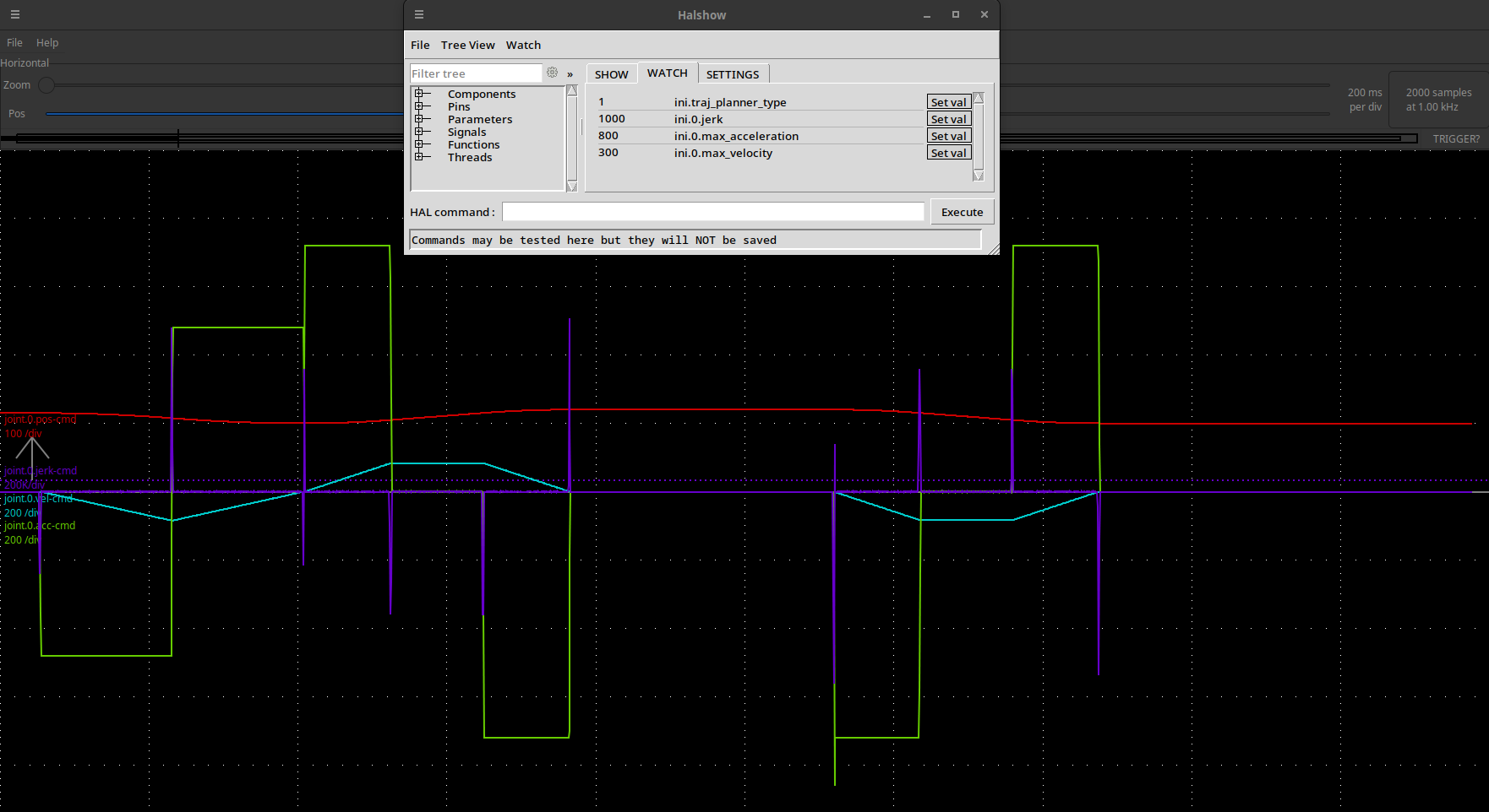

A word of caution to anyone testing the new planner on real hardware:
I would strongly recommend to NOT activate the new planner in the ini file.
I dropped my homing velocities to 20% and my real hardware setup still runs into the hard stops on homing.
Users should leave ini.planner_type = 0, home the machine and use halshow to set ini.planner_type = 1.

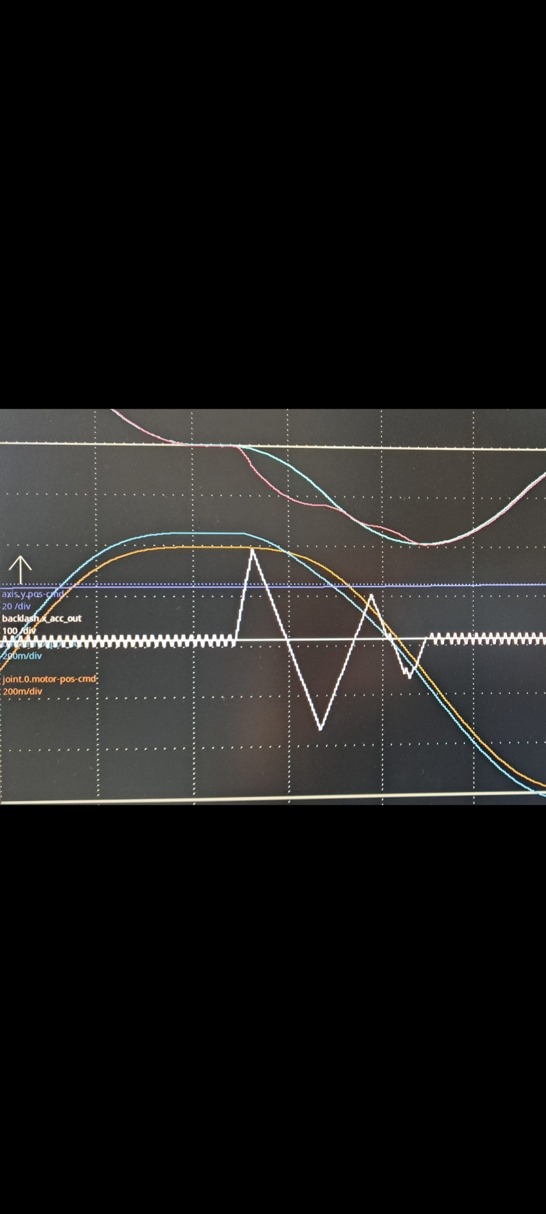

I do not want to talk about ethercat here .. we have separate space, but in reality it is lagging 2cycles because at hardare layer it writes command first and then it reads the slave status... then next cycle it write command by last status and then cycle it reach real status datas ... (Martin Rostan (Chairman ETG group) - when I was with him at last time at conference in Bratislava)
SDO 0x60C2 is configuring the timing of internal stuff of interpolationn of synchronized movement by subindex 01 and 02 .. most drivers it has to have it at same time of master command tick but we knows some which do not as Beckhoff AX5 series
I am at second computer and I will update picture later this weel but during movement in 15m/s it can produce lag of 0.2mm with timing 250us ... which sound terrible 0
I did compensation component which add posCmd = position command + compensation during vcommand != 0 and every lag was gone ... it was purely for testing but solution is clear
positionOutputCompensated = positionOutput;
if(fabs(vel_cmd) > 0.001)
double leadCycleLocal = lead_cycles;
const double Ts = periodTime;
const int L = (leadCycleLocal < 1) ? 1 : leadCycleLocal;
const double LTs = (double)L * Ts;
double lead = (vel_cmd * LTs) + (0.5 * acc_cmd * LTs * LTs);
double ferr;
ferr = (positionOutput - pos_fb_from_incremental);
double comp = (kff * lead) + (k_err * ferr);
posCompensation = comp;
if(fabs(ferr) > fabs(fErrorOld) || fTopError == 0.0)
fErrorOld = ferr;
fTopError = fErrorOld;
else
posCompensation = 0;
positionOutputCompensated = positionOutput + posCompensation;
if(ui_delayFinal > 0)
ui_delayFinal--;
//drv_target_position_incremental = (int32_t)(positionOutput * pos_scale * incremental_pos_scale);
drv_target_position_incremental = (int32_t)(positionOutputCompensated * pos_scale * incremental_pos_scale);

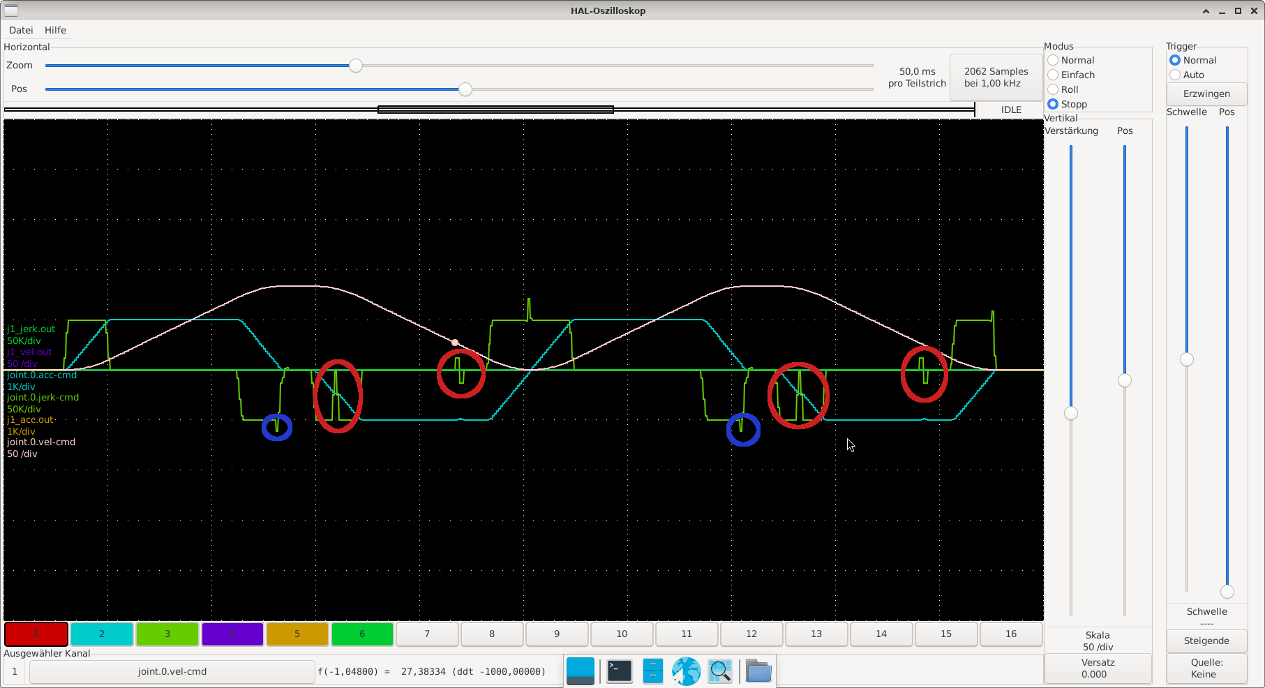

I would echo this warning for the latest master changes
1. Jerk does not seem to be limited nor acceleration:
2. Commanded position may take off on random tangents"

@grandixximo
During further testing, I noticed the following:
A sudden drop in jerkiness during acceleration build-up and deceleration, and a jerk greater than zero where there should be no jerkiness (red circles).
Cause?
tp.c
line 2836
"int need_decel = (margin <= TP_POS_EPSILON) || (dx - moveL <= dlen2);"
A brief exceedance of the maximum jerk value when acceleration ends (blue circles).
Cause?
sp_curve.c
lines 490 to 499
"if ((deltaV < 0 && targetV < v && v + deltaV < targetV) ||
(0 < deltaV && v < targetV && targetV < v + deltaV)) {
//nextA = (targetV - v) / t;
nextA = 2.0 * (targetV - v) / t - a;
if(nextA >= maxA){
nextA = maxA;
targetV = (a + nextA) * t / 2.0;
//printf("############################ FIXED nextA to be: %.14f \n", nextA);
v = targetV;"
I cannot say what is incorrect in the previous calculations.

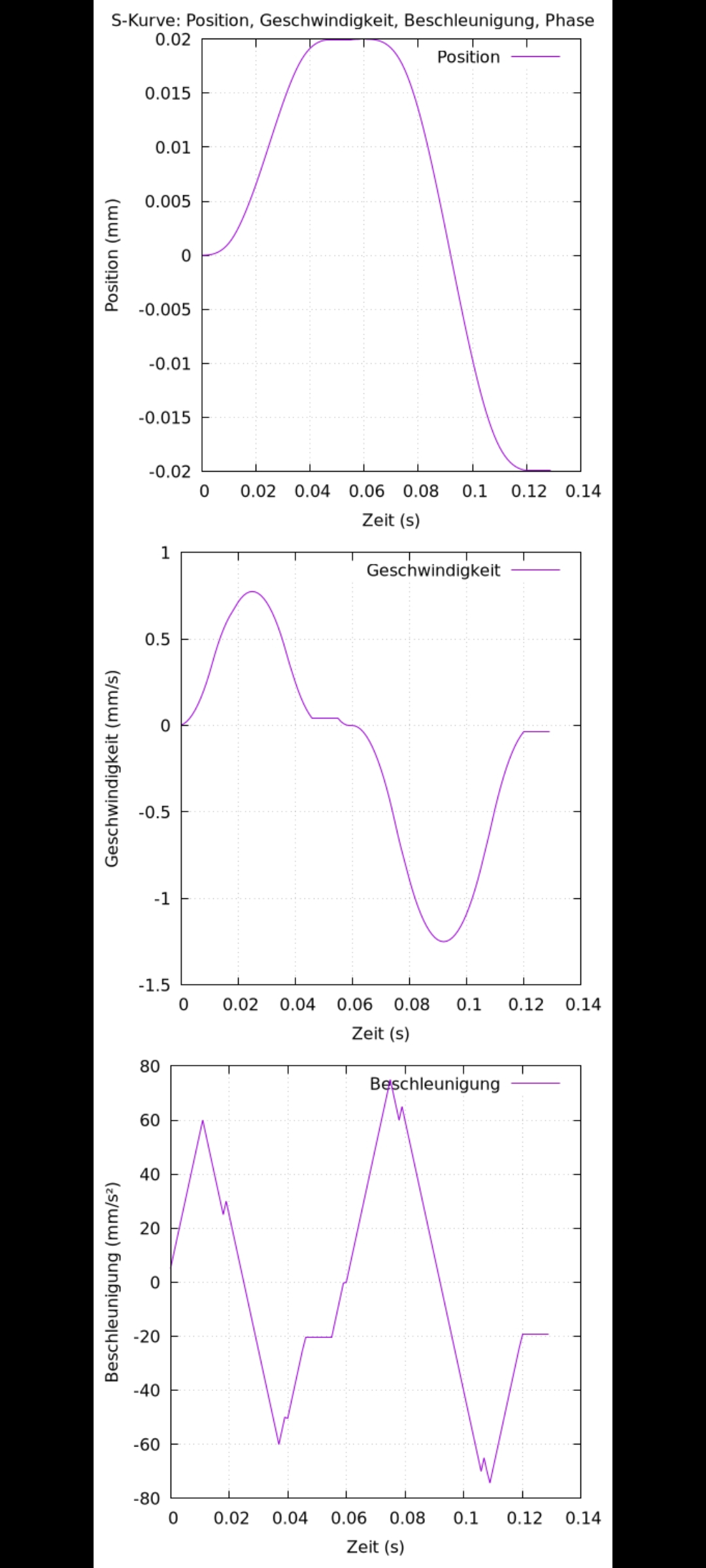

I had the same things happining a while ago when I tested Michels s curve. In the end theese (exactly like your situations) were just "calculation errors" and he solved it by adding allowed dwviations. Pos_out got a allowed deviation of 1e-4 I think.
Like you see in my pictures he had imperfections too. Michels s curve code tested outside linuxcnc when I implemend s curve backlash compensation as a proof of concept.

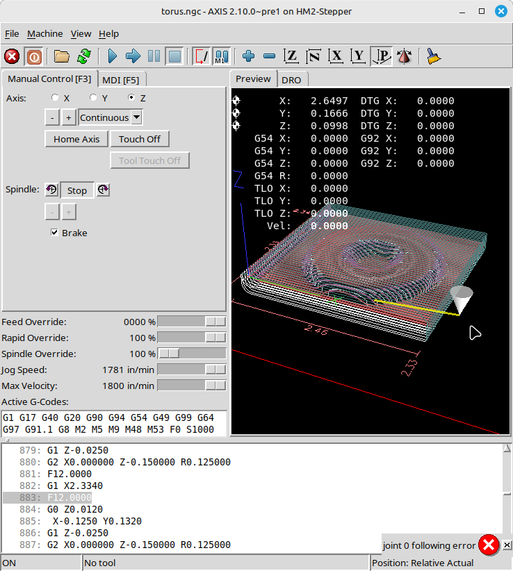

Do you think this is related to the 0000% feed override? how many multipliers of feed override have you set?
I tested with my configuration can complete torus no problem but I only did 200%
can you zip your config folder? I also don't use inches, that could be a factor.

Axis Max Jerk ?I've been trying to test this on real hardware using Mesa but I cannot seem to get the new planner to work at all.
Yet running this code in G61.1 modeG21 F5000 G0 x0 y0 g1 x20 y20 x0 y0 m2 I get this: [attachment=74126]Screenshot from 2026-01-27 10-31-48.png[/attachment] here is my ini file: [spoiler] # This file was updated with the Mesa Configuration Tool on Nov 25 2025 13:43:50 # Changes to most things are ok and will be read by the Configuration Tool [MESA] VERSION = 2.1.8 BOARD = 7i95 BOARD_NAME = 7i95t [EMC] VERSION = 1.1 MACHINE = test_setup DEBUG = 0x00000000 [HM2] DRIVER = hm2_eth ADDRESS = 192.168.1.121 [DISPLAY] DISPLAY = axis PROGRAM_PREFIX = ./nc_files POSITION_OFFSET = RELATIVE POSITION_FEEDBACK = ACTUAL MAX_FEED_OVERRIDE = 1.2 MIN_LINEAR_VELOCITY = 0.0 DEFAULT_LINEAR_VELOCITY = 150.0 MAX_LINEAR_VELOCITY = 300.0 CYCLE_TIME = 0.1 INTRO_GRAPHIC = emc2.gif INTRO_TIME = 0 OPEN_FILE = ./square.ngc EDITOR = gedit DEFAULT_ANGULAR_VELOCITY = 18000 MAX_ANGULAR_VELOCITY = 36000 MIN_ANGULAR_VELOCITY = 1 [KINS] KINEMATICS = trivkins JOINTS = 2 [EMCIO] CYCLE_TIME = 0.100 TOOL_TABLE = tool.tbl [RS274NGC] PARAMETER_FILE = parameters.var [EMCMOT] EMCMOT = motmod COMM_TIMEOUT = 1.0 SERVO_PERIOD = 1000000 [TASK] TASK = milltask CYCLE_TIME = 0.010 [TRAJ] COORDINATES = XY LINEAR_UNITS = mm ANGULAR_UNITS = degree MAX_LINEAR_VELOCITY = 200.0 PLANNER_TYPE = 1 MAX_LINEAR_JERK = 1000.0 DEFAULT_LINEAR_JERK = 500.0 [HAL] HALFILE = main.hal [AXIS_X] MIN_LIMIT = 0 MAX_LIMIT = 300 MAX_VELOCITY = 300 MAX_ACCELERATION = 800 [JOINT_0] CARD = 0 MIN_LIMIT = 0 MAX_LIMIT = 300 MAX_VELOCITY = 300 MAX_ACCELERATION = 800 MAX_JERK = 1000.0 TYPE = LINEAR SCALE = 252.65 STEPGEN_MAX_VEL = 360.00 STEPGEN_MAX_ACC = 960.00 DIRSETUP = 10000 DIRHOLD = 10000 STEPLEN = 4000 STEPSPACE = 4000 ENCODER_SCALE = 200 FERROR = 1.5 MIN_FERROR = 0.25 DEADBAND = 0.01 P = 1000 I = 0 D = 0 FF0 = 0 FF1 = 1 FF2 = 0 BIAS = 0 MAX_OUTPUT = 0 MAX_ERROR = 0.0127 HOME_OFFSET = -0.75 HOME = 0 HOME_SEARCH_VEL = -5 HOME_LATCH_VEL = -5 HOME_FINAL_VEL = 2.5 HOME_IGNORE_LIMITS = YES HOME_SEQUENCE = 0 [AXIS_Y] MIN_LIMIT = 0 MAX_LIMIT = 300 MAX_VELOCITY = 300 MAX_ACCELERATION = 800 [JOINT_1] CARD = 0 MIN_LIMIT = 0 MAX_LIMIT = 300 MAX_VELOCITY = 300 MAX_ACCELERATION = 800 MAX_JERK = 1000.0 TYPE = LINEAR SCALE = 252.65 STEPGEN_MAX_VEL = 360.00 STEPGEN_MAX_ACC = 960.00 DIRSETUP = 10000 DIRHOLD = 10000 STEPLEN = 4000 STEPSPACE = 4000 ENCODER_SCALE = 200 FERROR = 1.5 MIN_FERROR = 0.25 DEADBAND = 0.01 P = 1000 I = 0 D = 0 FF0 = 0 FF1 = 1 FF2 = 0 BIAS = 0 MAX_OUTPUT = 0 MAX_ERROR = 0.0127 HOME_OFFSET = 0.25 HOME = 0 HOME_SEARCH_VEL = -5 HOME_LATCH_VEL = -5 HOME_FINAL_VEL = 2.5 HOME_IGNORE_LIMITS = YES HOME_SEQUENCE = 0 [/spoiler] What am I missing?

Try with max_jerk and default_jerk to 10000 or more, 1000 was more for showcasing the curves, not to run on actual hardware, already planning to change the showcase ini to 10000
