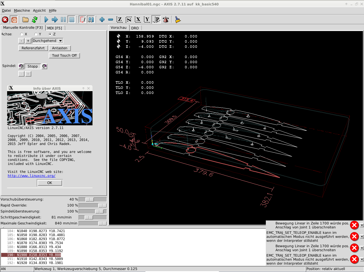

01 Jan 2018 10:22 - 01 Jan 2018 10:24 #103929
by cki61
Replied by cki61 on topic Getting error "can't do that (EMC_TRAJ_SET_TELEOP_ENABLE) in auto mode"
I'm running for the first time in the same error. I admit that I didn't run the software with mill 1,5 years before without any errors.
Since then there where several updates.
Nevertheless: I start LinuxCNC after having loaded the data-file (appended). I runs till line 190 and stops.
No touching a keyboard or mouse. This happened every time at the same position.
I had no time to test my old files that already succeeded. I append the screenshot, so you can see the messages and the error.
I'll try later on to have a test run on a simulation machine.
Any hints or solutions are welcome.
All the best for the new year 2018!
Regards,
cki61
Regards,
cki61
