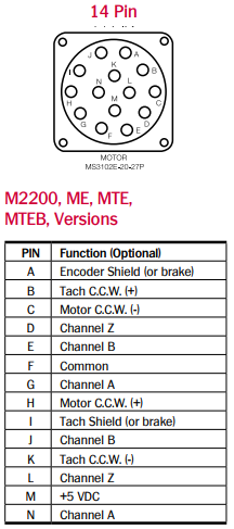

I am in the process of bringing a 24-year-old Hurco VMC back to life. The control has a bad hard drive and that as good of an excuse as any to upgrade to something nicer. I've used LinuxCNC in the past, the name used to be different, on a stepper based machine. This time around I would like to use a Mesa card and reuse the current motors from the machine, at least initially. They are Baldor DC Servos. From my understanding, these are just basic dc motors with 2500L encoders on them. The label on the side reads:
CAT NO. MTE-4535-SPECIAL
SPEC NO. FME0204B-00
MFG. CODE S3/94
TORQUE STALL 40 LB-IN
MAS SPEED 4500
MAX VOLTAGE 180
VOLTAGE CONT. 32.0
CURRENT CONT. 16.4
CURRENT PEAK 70.2
TACHOMETER 7.0
ENCODER 2500 L
I am looking for some guidance as to whether or not I can use these servos and the best way to go about doing so. I do plan to purchase new servos for the machine just not right now. For what its worth the one I plan on upgrading to are 120-DST-A6HS1 from www.dmm-tech.com/ac_servomotor_main_a1.html#jmp1 .Thank you in advance for any help or direction anyone can provide.
EDIT: Attached photo of pinout on motors.

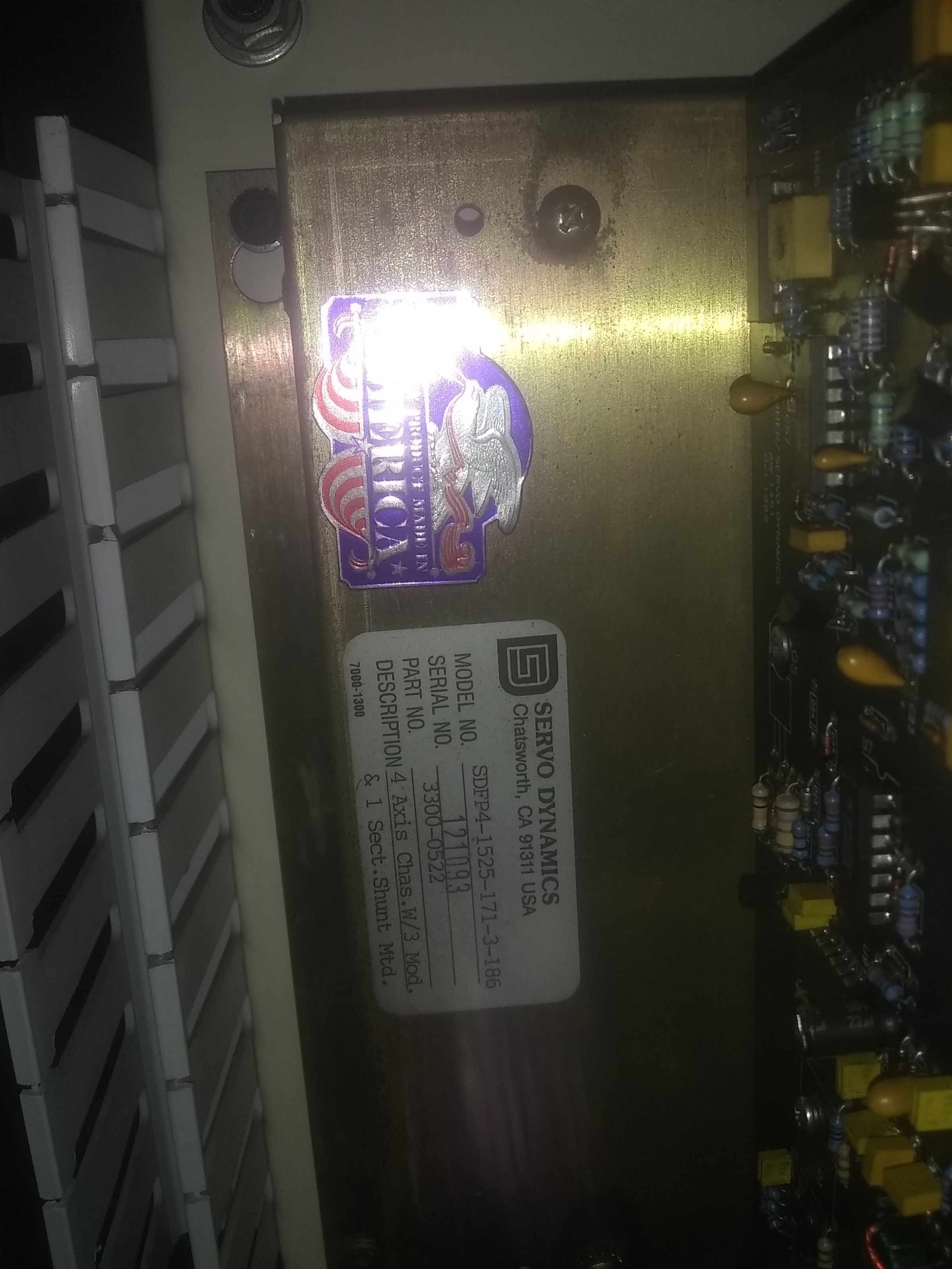

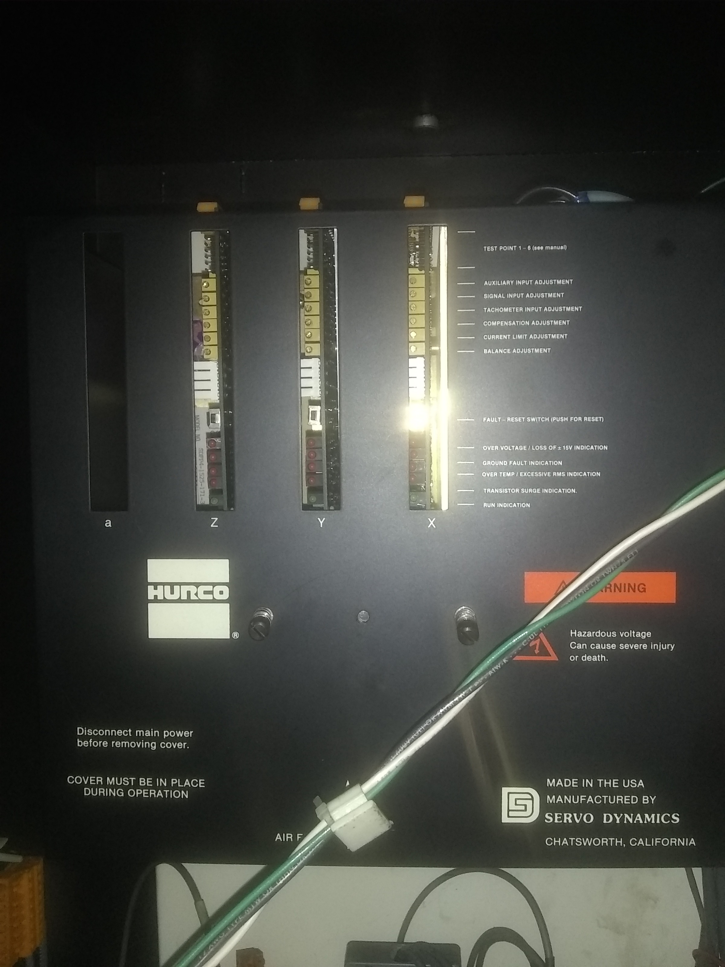

03 Apr 2018 20:49 #108342
by biqut2
Replied by biqut2 on topic Hurco Hawk 5M Retrofit w/ existing motors
Yes, I do however I do not know how to properly interface with it. Its a 4 axis unit with 3 motion cards installed. Attach is a picture of it inside the control cabinet. I am awaiting a reply from the manufacture of the servo drive unit but they may or may not be any help.

03 Apr 2018 21:10 #108346
Replied by PCW on topic Hurco Hawk 5M Retrofit w/ existing motors
Look like the rather common SD1525 Analog servo drives or a variant, you can download a
manual (that should be close) here:
www.servodynamics.com/manuals/

03 Apr 2018 21:17 #108347
by biqut2
I'm assuming you mean this one? www.servodynamics.com/wp-content/uploads...DS1015-10_manual.pdf
none of the ones with pictures look anything like mine and the 3300-0522 number doesn't seem to match up unless I'm overlooking something.

03 Apr 2018 21:29 - 03 Apr 2018 21:34 #108348
It looks like a SD1525 (or rather three SD1525s) but older ones than shown in the manuals
the 3300 PN is probably the 3 axis multi drive chassis
The model SDFP4-1525 is a clue
diagramasde.com/diagramas/aires-acondicionados/SD%201525.PDF
looks like your model (single drive)

03 Apr 2018 21:35 #108352
by biqut2
Okay, in that case, I am looking at the www.servodynamics.com/wp-content/uploads...0/1525brs_manual.pdf manual. It indicated two modes, both of which accept a +-10vdc control voltage to control the speed and direction of the motor. So the control loop would involve tapping into the encoder signal to count pulses and stop the motor when the commanded position has been reached? And I'd need an i/o card capable of multiple +-10vdc signals and inputs to accept each of the encoder outputs. As I'm typing all this out it sounds a lot more complex than a simple step/direction system that I'm used to.
- Posts: 18122
- Thank you received: 5337
03 Apr 2018 21:52 #108354
Yes, this is a standard analog velocity mode servo, something that
LinuxCNC is well suited to control (and has advantages over step/dir systems)
including the ability to disable the drives without losing position and homing to index
(index is the Z pin on the encoder)
