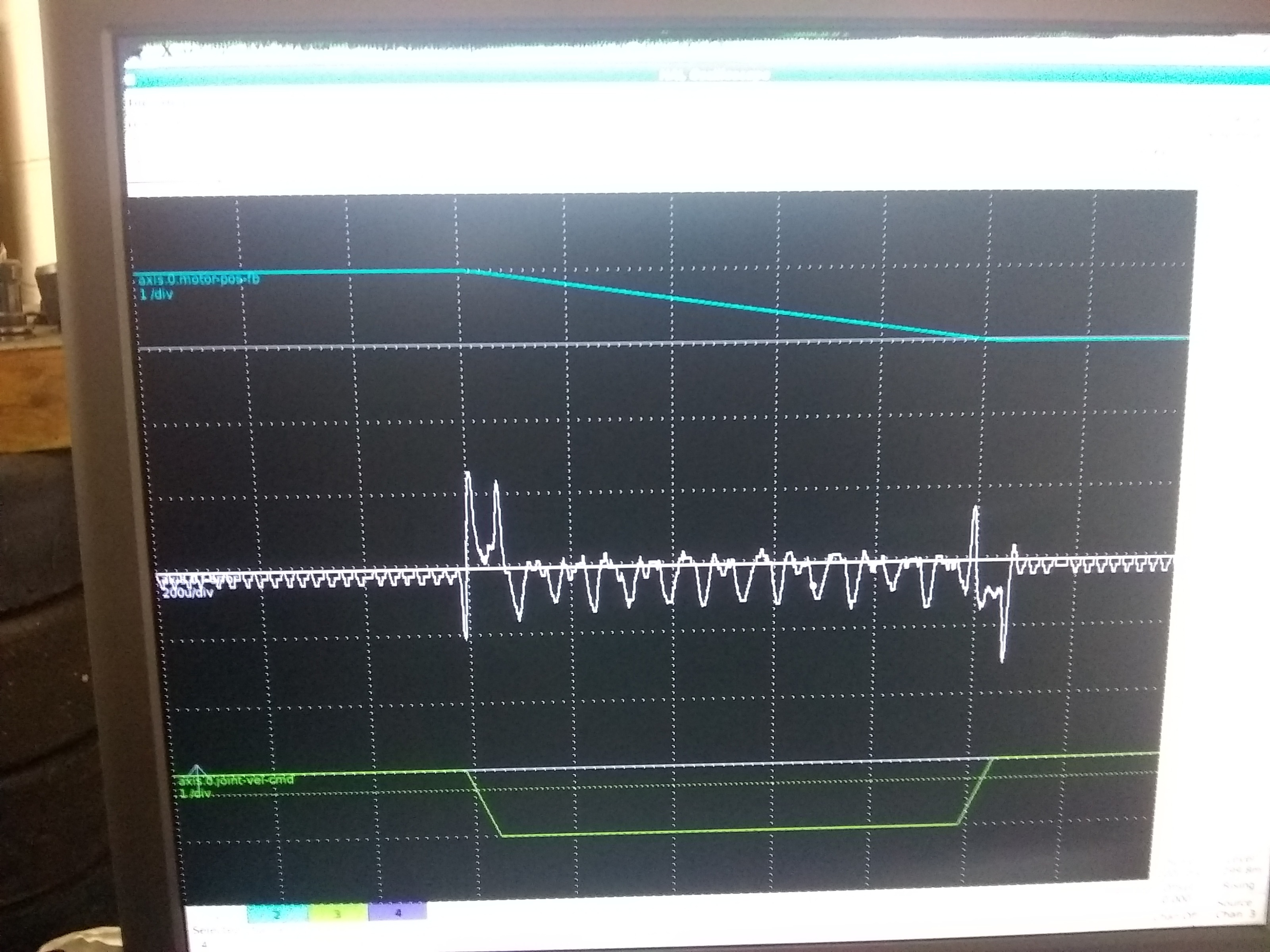

15 Apr 2018 20:27 #109109
by biqut2
Replied by biqut2 on topic Hurco Hawk 5M Retrofit w/ existing motors
Just posting a quick update and big thank you for patiently answering my stupid questions. I've yet to map the ballscrews but tunning looks good to me anyway. I got it to a little better than .0002" which is good enough for the work I do. I read in one post on here that the best case scenario is 2 encoder pulses.Was wondering what you guys thought? Is it good or should I still keep tweaking?
