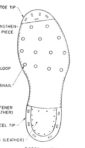

14 Jan 2019 06:22 #124138
by AnjaBird.AKB
Plz any one can do a puma 560 simulation for this attached shoe bottom shape.i only need go through the margin of this bottom. it is very helpful for my work.if any one can plz send me a short video for mentioned description.
thank you.

- Posts: 19897
- Thank you received: 4652
14 Jan 2019 14:04 #124154
Replied by andypugh on topic How To add robot arm model into linuxCNC
Are you asking someone to convert that bitmap image into G-code and then make a video of the Puma560 Vismach model tracing out the shape?

15 Jan 2019 02:18 #124216
by AnjaBird.AKB
Replied by AnjaBird.AKB on topic How To add robot arm model into linuxCNC
exactly andypugh.could you please make a video and send it to my email ???
