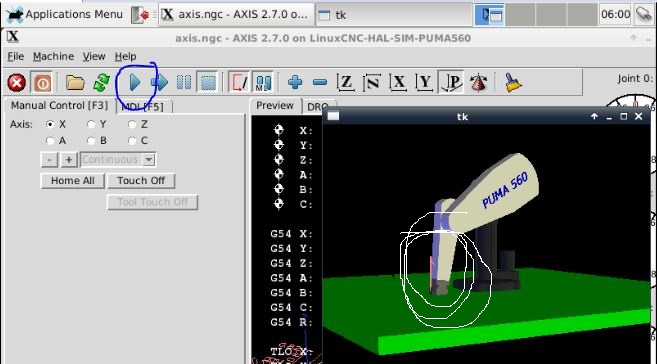

Replied by AnjaBird.AKB on topic How To add robot arm model into linuxCNC
after i attached a default linunx cnc model it works like this?? why is that ?
21 Jan 2019 13:39 #124531
Replied by andypugh on topic How To add robot arm model into linuxCNC
What does the G-code say? it looks like a linear move in the Z axis.

21 Jan 2019 14:02 #124539
by AnjaBird.AKB
i dont know,after i load the model and press the simulation button it works like this,but in other window cone like end top goes correctly
21 Jan 2019 14:13 #124541
Your picture does not make it clear what " it works like this" means. Or what you think is wrong, or what you consider "correctly"
You haven't even said which G-code file you are running.

23 Jan 2019 05:26 #124646
by AnjaBird.AKB
i worked with default linux cnc letters g code.could you please tell me how to start a simulation in preview window of puma robot step by step,i think wrong is happed there.it willbe very helpful
