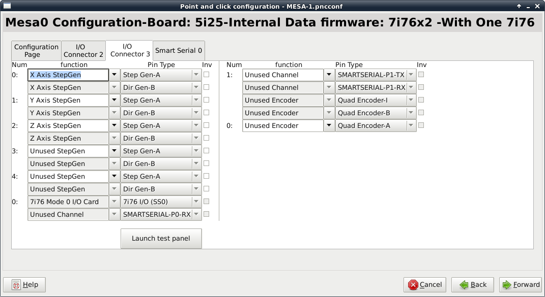

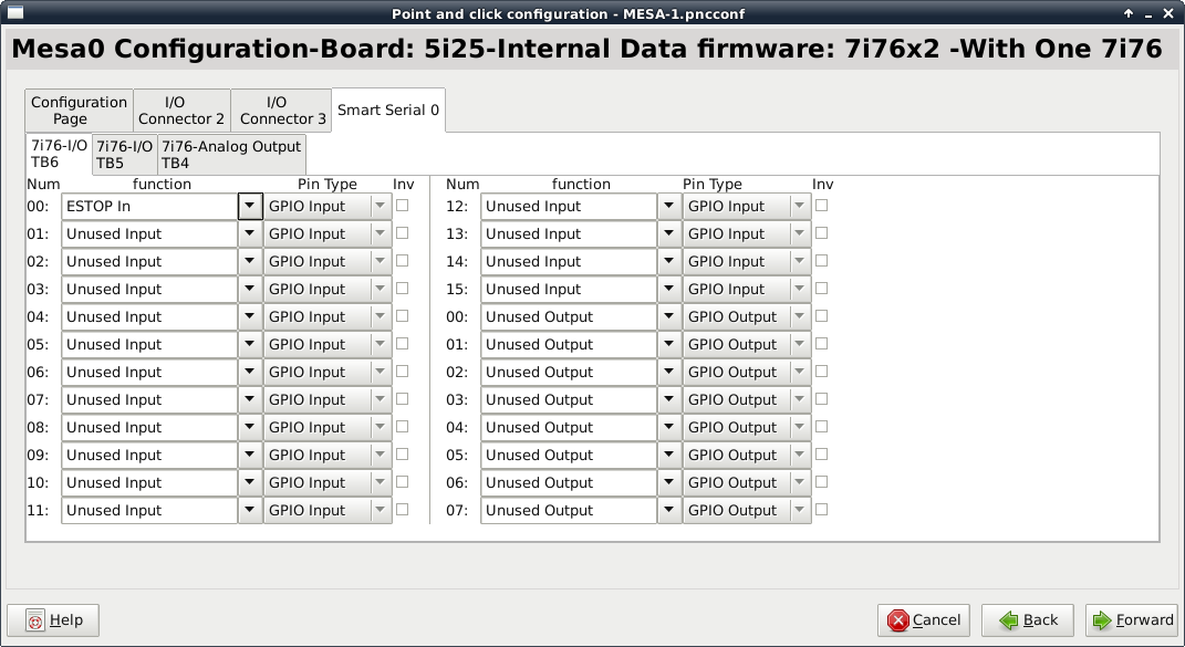

I have the 6i25 default (so it thinks it's a 5i25 card) and I have a single 7i76D attached.
The 7i76D has 6 terminal strips attached... and I'm having some issues with getting pins configured properly...
In PNCCONFIG it references the step generators as 0 through 4... and I can see that this spans TB2 and TB3 of the actual 7i76D card.
I understand that... it's odd... but I can set up the X / Y / Z just fine.

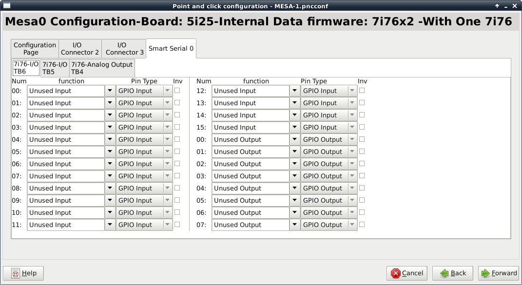

Now TB5 and TB6 are set up for a bunch of inputs and outputs... very useful for things like ESTOP-IN for example.
If I don't specify anything... it runs just fine... signals working, etc.
As you can see above... it shows the terminal strips... in this case TB6. But... here is the thing... if I go to TB6, PIN-00 and select ESTOP-IN... it saves it just fine. I would expect to run the machine, apply signal, and get ESTOP results.

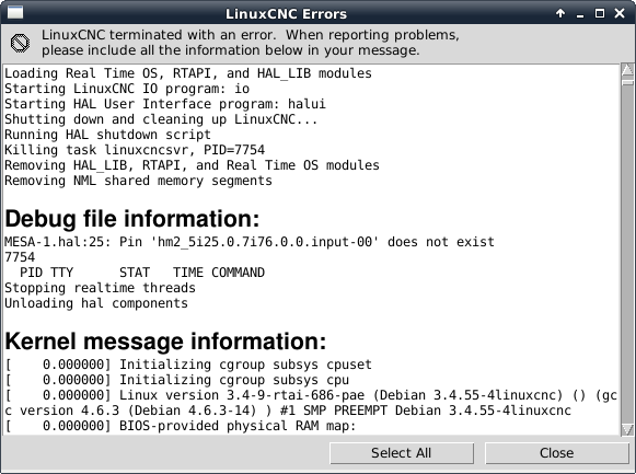

But if I try to actually run that configuration... it fails...
So what is going on? Why won't it let me connect a pin that is clearly on the board???

29 Jun 2018 08:17 #113065 by cmorley
Replied by cmorley on topic MESA 6i25 and 7i76D PNCCONFIG Issues
Do you have field power applied to the 7i76?
The I/O pins won't be available if field power is missing.
Chris M
29 Jun 2018 12:27 #113087 by andypugh
Replied by andypugh on topic MESA 6i25 and 7i76D PNCCONFIG Issues
I think Chris has it. The GPIO is a smart-serial device powered from the field-IO voltage. Smart-serial devices are queried at startup and the pins are made on-the-fly to suit what is found. If the 7i76 GPIO section has no power it won't be found and there won't be any pins.

There are 2 power supplies involved, the 5V logic power (and for a 7I76/7I76D its easier if this comes from the FPGA card) _and_ the field power (typically 12 or 24V), which is supplied to the 7I76/7I76Ds TB1 (the orange connector).
Both power sources must be present for the 7I76/7I76D digital I/O to be found
