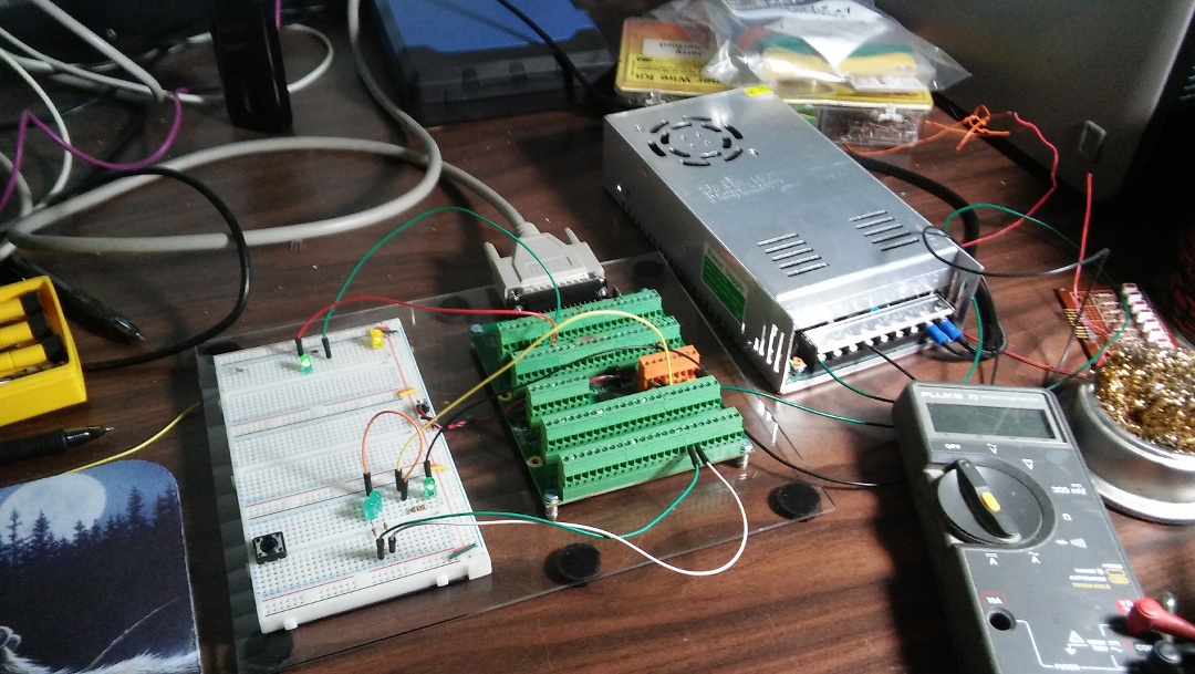

Just a follow-up for anyone else...
I set it up as described above, no issues, and it is working perfectly.
I have the 7i76D board which SINKS current instead of providing voltage... so here is the difference...
7i76 (standard)
Outputs
0 V = OFF
24v = Active
Inputs
FLOAT (0v) = OFF
24v = Active
FLOAT (24v) = OFF
0v (shorted) = Active
Corrections by PCW
7i76D (Sinking)
Outputs
Floating (24v) = OFF
0v (Ground) = Active
Inputs
FLOAT (0v) = OFF
24v = Active
Now onto programming and other things like the GPIO... another thread.

The 7I76 and 7I76D _inputs_ are identical, ( +input = true ) only the outputs are different

Not really... on the 7i76 you connect a switch between the GROUND and the INPUT. Closing the switch registers a change. If you do that with the 7i76D nothing happens.
For the 7i76D you connect the switch between FIELD POWER and INPUT. Closing the switch brings the input off GROUND above the 9-ish volt threshold to register.
I just proved that with my breadboard setup.
Last edit: 06 Jul 2018 17:12 by Askjerry.
- Posts: 18105
- Thank you received: 5328
06 Jul 2018 16:54 - 06 Jul 2018 16:58 #113588
Replied by PCW on topic MESA 6i25 and 7i76D PNCCONFIG Issues
That's not correct, the 7I76 and 7I76D have _identical_ input circuits, you must supply a input voltage > 60% of VFIELD to be registered as true (and below 40% of VFIELD to be registered as false)

Huh... I thought only the 7i76D used sinking for input.
I thought the 76i67 was like a parallel port... floating high and being pulled low to register.
For clarity, I corrected the posts above, with credit to you.
