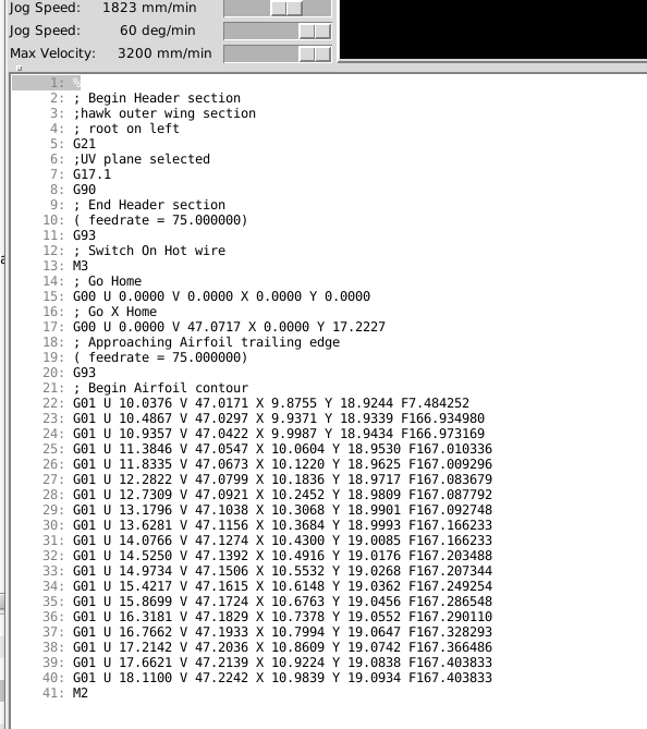

- Posts: 19902
12 Nov 2018 20:21 #120524
Replied by andypugh on topic A head scratcher for me
I have run out of time tonight, but this is close.
In the INI file add this to the [FILTER] section
Now save this at that path as filter.py
Now any gcode file with a .foam extension will run through that filter, example output:
It probably needs work, I am not sure that my G93 feedrate calculation is correct, but the structure is there.

print "M2"Now any gcode file with a .foam extension will run through that filter, example output:

by rcKeith
Replied by rcKeith on topic A head scratcher for me
Hi Andy
Just tested on the machine and it works fantastic. Thank you so much. You're a wizard.
Keith
