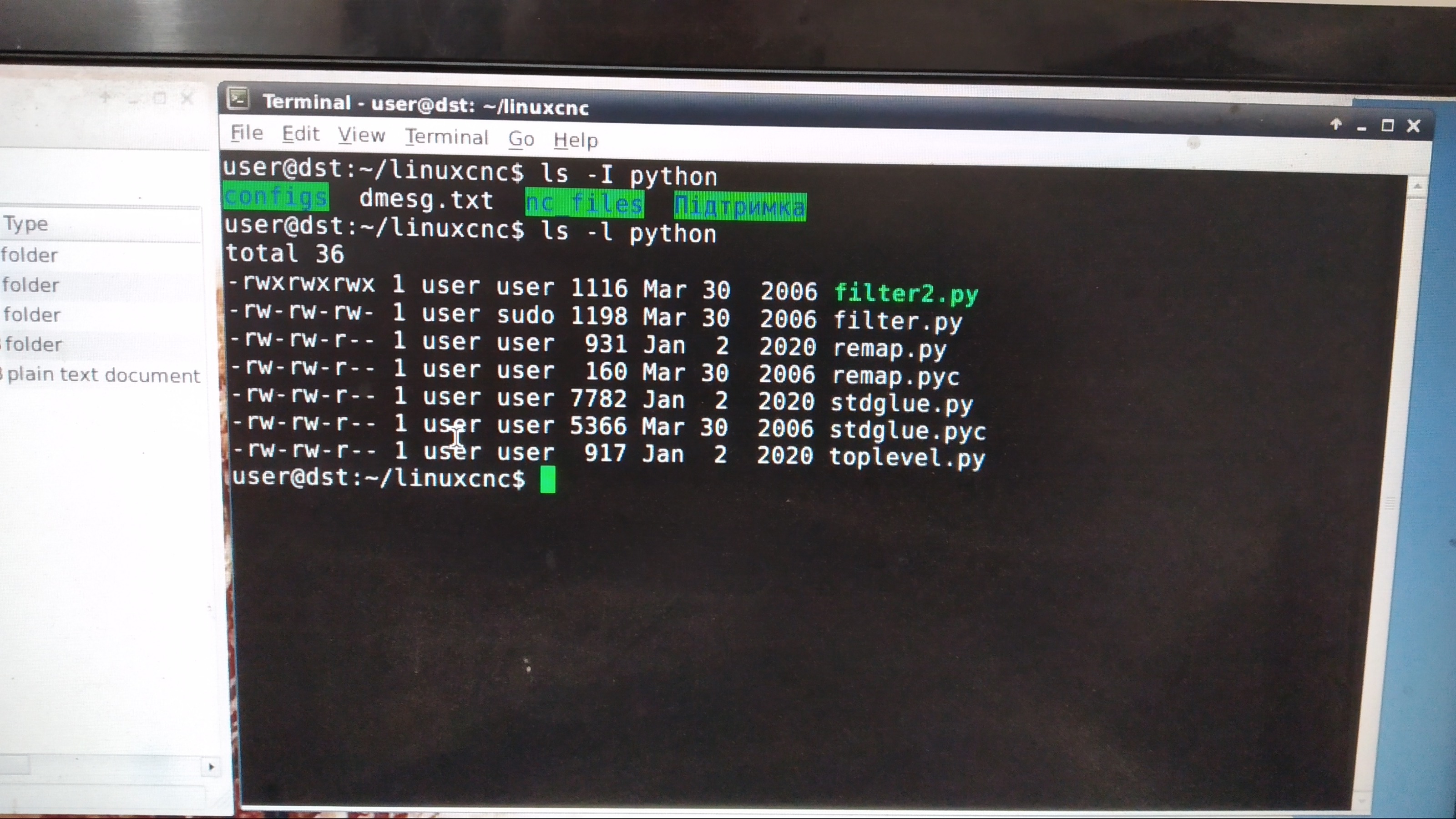

Replied by rcKeith on topic A head scratcher for me
If you open a terminal and
type
ls -l /home/user/linuxcnc/python
and then
Alt + PrtSc – Save a screenshot of the current window to Pictures
Then upload the screenshot
type
and then

At photo there is filter.py (original) and filter2.py (edited for axes X,Y,Z,A), no one is run.
- rcKeith
- Posts: 15
05 Jun 2020 18:04 #170297
by rcKeith
If you type ./filter2.py in the directory you have the filter in does it run?
It needs a g-code file as its input so if you type ./filter.py somefile.gcode
it should print out the altered g-code.
In the ini file the filter will work if it finds a g-code file with a .foam extension,
Give that a try
Give that a try

17 Nov 2022 11:02 - 17 Nov 2022 11:06 #256940
by slidinghawk
Replied by slidinghawk on topic A head scratcher for me
Tried to add too with an error.
code 126
sh: /home/cnc/linuxcnc/filter.py: Permission denied (((
PROGRAM_EXTENSION = .nc,.tap G-Code File
PROGRAM_EXTENSION = .foam foam
png = image-to-gcode
gif = image-to-gcode
jpg = image-to-gcode
py = python
foam = /home/cnc/linuxcnc/filter.py
code 126
py = python
Last edit: 17 Nov 2022 11:06 by slidinghawk.
- Posts: 19902
17 Nov 2022 16:55 #256976
Replied by andypugh on topic A head scratcher for me
Have you made the filter.py file executable?
chmod +x filter.py
chmod +x filter.py
