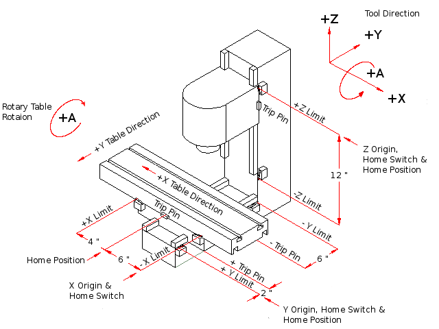

26 Aug 2018 12:45 - 26 Aug 2018 14:53 #116602
by MaHa
Replied by MaHa on topic Manual tool change problem
I think most Linuxcncmachines have G53/machine coordinate system Z0 at the most faraway position from the table,workpiece. Very good idea to avoid crashing the machine. If you are working with toollength compensation, G43, it needs to be activated with the first z-move after toolchange. After the last move in z, toollength compensation must be deactivated with G49, for toolchange. Most machines refuse toolchange, if you don`t. That time z retracted to G53 Z0 (z+ direction), has nothing to do with the tooltip at all, it is the position of the Z-slide. then there should be enough space for your tool.
The attched picture is from the manual, Important User Concepts, 6. Machine Configurations.
Last edit: 26 Aug 2018 14:53 by MaHa.
- derekmac
- Posts: 16
26 Aug 2018 15:08 #116607
by derekmac
Replied by derekmac on topic Manual tool change problem
My Taig mill is very small by most standards - very much Model Engineering rather than commercial
Max travel is X11, Y5, Z5 which immediately imposes contraints on what I can do
Add to that the fact that none of my tooling is fixed and can move up and down in the chucks
I have always used it with Z0 set to the top of the material, moving Z to 0.5 for tool change with a half inch block between tool tip and material
That way I adjust the tool within the chuck to suit. Changing the tool at higher altitude would be impractical as I would have no way of adjusting it relative to the material.
