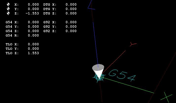

29 Aug 2018 03:57 - 29 Aug 2018 04:00 #116761
by curtisa
Replied by curtisa on topic Manual tool change problem

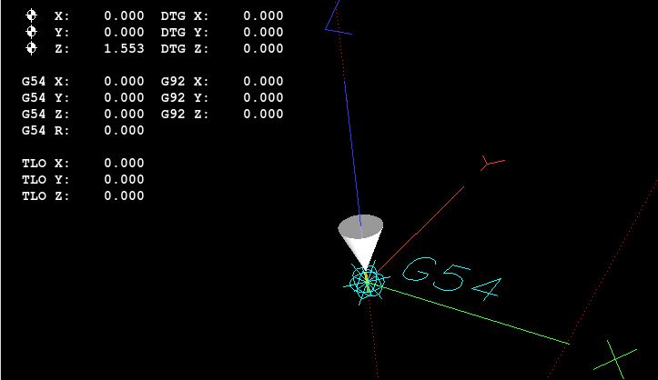

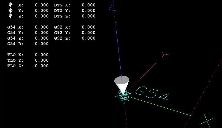

Here's some screenshots of what I'm seeing. Maybe if you can confirm it's the same behaviour you're experiencing.
1. Initial tool position, all axes zeroed, no offsets, no TLO, touchoff completed at X0 Y0 Z0. The assumption here is that tool length at this point is irrelevant. The tool could be 2mm long or 10 miles long. The tip of the tool is sitting at exactly Z0, both on the machine and in the backplot:
2. G43 H21 invoked to apply tool offset. Tool drops down Z axis by 1.553" in backplot (ie, the tool now has a defined length of 1.553" extending below the starting position). TLO reports Z=1.553". DRO reports Z=-1.553". Machine has not moved:
3. G0 Z0 command given. Tool tip raises to Z=0. DRO reports Z=0. Machine raises Z axis by corresponding 1.553", so tool would physically now be 1.553" above the actual Z=0 position:
4. G49 invoked. All offsets cancelled. Backplot now shows tool 1.553" above Z=0. DRO also reflects this reporting Z=1.553". Machine has not moved:
As far as I can tell this should be the correct behaviour provided the use of G43 H21 is not offsetting an existing offset introduced by the application of G54.
