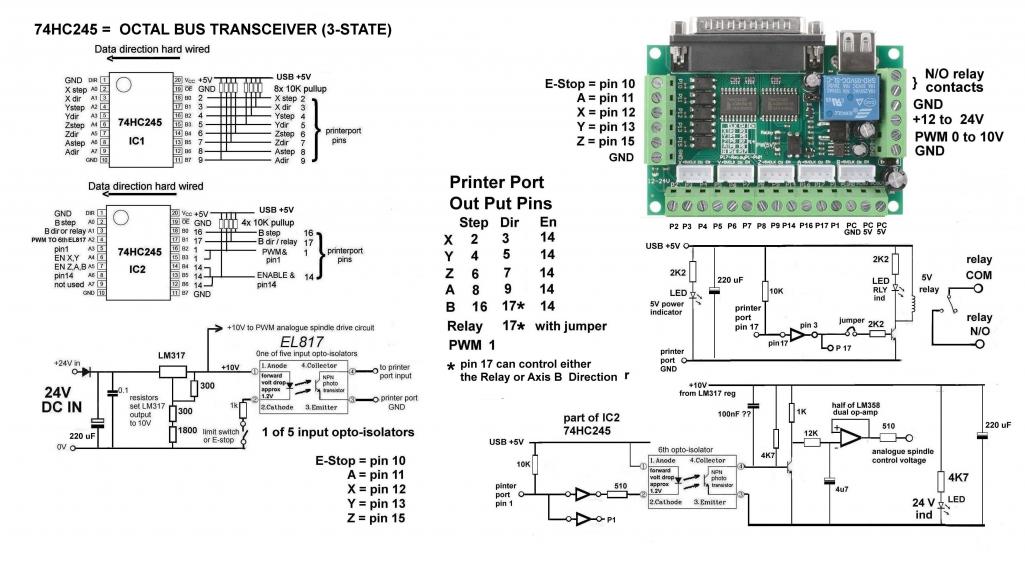

Actually I think this BOB does not have optos in the PUL & DIR outputs?
- Marcking
- Posts: 36
21 Dec 2018 01:07 #122669
by Marcking
Replied by Marcking on topic Finished parts ending like they were offset some how...
Update:
I think it is solved, running the stepper test on the X axis after 3000 times going back and for, it went back to the same position.
Due that I used a second xstep pin for the second X axis motor I forgot to do a reset on that pin example:
set parport.0.pin-02-out-reset 1
Tomorrow I will do a cutting test and let you guys know.
