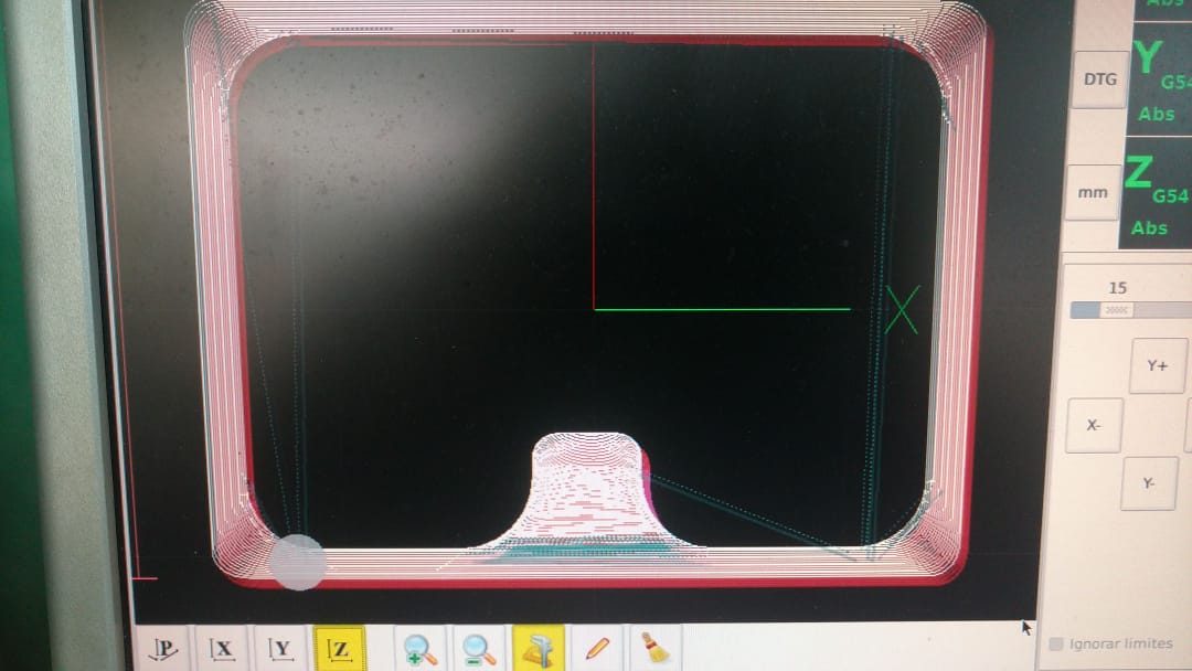

Finished parts ending like they were offset some how...

28 Dec 2018 18:29 #123026 by Marcking
Hello Guys,
Please see the attached file is the graphic screen after doing the machining it shows how the machining have being shifted and LinuxCNC knows about it! ??
Any suggestion?
Thank you!
