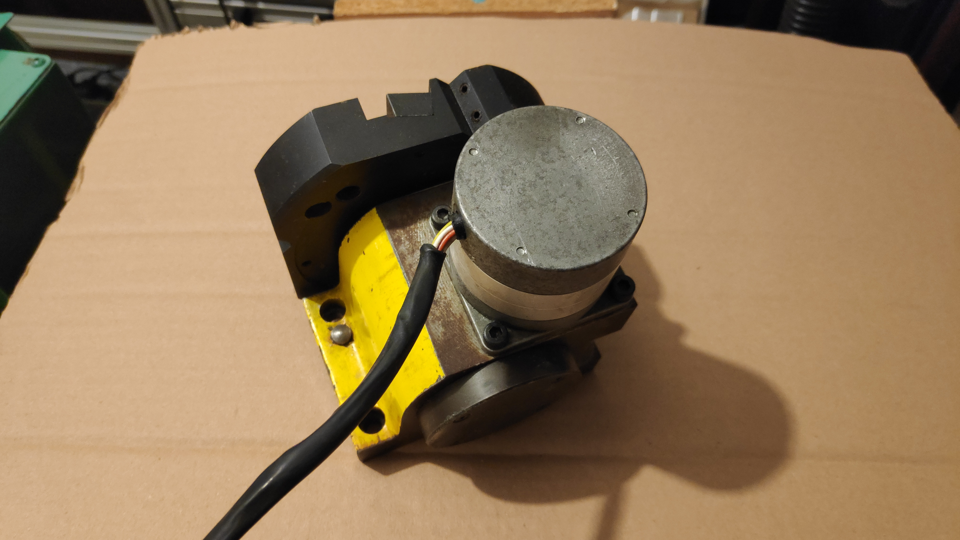

Hi everyone!
I have tool changer from BOXFORD 125 TLC And I found
wiki.linuxcnc.org/cgi-bin/wiki.pl?Contri...oolchanger_component
My problem is that just looking at README and other files in it gives me headache and I start to sweat
I was able to setup my lathe with stepconf, but that is as far as my knowledge goes
If it is no to much to ask, would it be possible to write me step by step guide where, and what to copy/alter?
I know I’m asking big favour here, sorry.
Regards Maros

This is what I tried so far:
I copied file toolchanger.comp to my linuxcnc/configs/Lathe_Orac folder
Then copied:
# .ini file for axis - ATC set up as axis A angular
[AXIS_3]
TYPE = ANGULAR
HOME = 0.0
MAX_VELOCITY = 2.5
MAX_ACCELERATION = 5
STEPGEN_MAXACCEL = 5
SCALE = 80.0
FERROR = 1
MIN_FERROR = .25
MIN_LIMIT = -99999
MAX_LIMIT = 99999
HOME_OFFSET = 0.0
to the end of my Lathe_Orac.ini file
Then I copied:
# example Hal linkages required:-
setp stepgen.3.position-scale [AXIS_3]SCALE
setp stepgen.3.steplen 1
setp stepgen.3.stepspace 0
setp stepgen.3.dirhold 16000
setp stepgen.3.dirsetup 31000
## make sure accel and velocity are sensibly low or it will take off!
setp stepgen.3.maxaccel [AXIS_3]STEPGEN_MAXACCEL
### must unlink these 2 to access stepgen.3.position-cmd
### and prevent continual following errors if motor-pos-fb left linked
#net apos-cmd axis.3.motor-pos-cmd => stepgen.3.position-cmd
#net apos-fb stepgen.3.position-fb => axis.3.motor-pos-fb
net astep <= stepgen.3.step
net adir <= stepgen.3.dir
net aenable axis.3.amp-enable-out => stepgen.3.enable
# loading the toolchange component in .hal file
loadrt toolchanger
addf toolchanger servo-thread
net tool-change iocontrol.0.tool-change => toolchanger.toolchange
net tool-changed iocontrol.0.tool-changed <= toolchanger.toolchanged
net tool-number iocontrol.0.tool-prep-number => toolchanger.toolnumber
net tool-oldnumber iocontrol.0.tool-number => toolchanger.currenttoolnumber
net apos-cmd toolchanger.position-cmd => stepgen.3.position-cmd
net ahomed axis.3.homed => toolchanger.ishomed
In to my Lathe_Orac.hal file
I don’t understand this part:
Now when I try to run Linuxcnc I got this message:
/Lathe_Orac.hal:87: parameter or pin ‘stepgen.3.positio-scale’ not found

I do have Orac Denford Lathe without toolchanger+ toolchanger from Boxford 125 TCL driven by stepper motor.
Update:
I copied file toolchanger.comp to my linuxcnc/configs/Lathe folder
Then copied Header:
[AXIS_3]
to the end of my Lathe.ini file
Then I copied:
AND
loadrt toolchanger
In to my Lathe.hal file
Then I run terminal in my configs directory to compile:
sudo halcompile --install toolchanger.comp
(sudo comp --install toolchanger.comp) don’t work!
Still stuck Here when try to run linuxcnc
Update:
Then copied Header:
[AXIS_3]
Then I copied:
AND
loadrt toolchanger

Hi Andy! I have no idea what is “carousel component”, and how it would help me. Is there any guide I can follow to make my 8 position tool post driven by stepper motor works? Or if it is not too much to ask, can you guide me step by step please?

We would need rather more information on the nature of the feedback and control if the turret to help further.
- Posts: 19311
7 years 10 months ago #123289
It should be “position-scale”
Replied by andypugh on topic BOXFORD 125 TLC Tool Changer Setup
