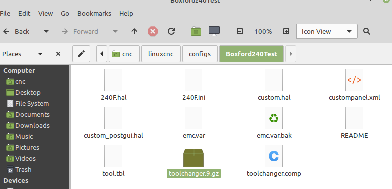

I am trying to load the Boxford 125 sim toolchanger wiki.linuxcnc.org/uploads/Boxford.tar.gz
from
wiki.linuxcnc.org/cgi-bin/wiki.pl?Contri...oolchanger_component
The instruction state:
You can simply copy the directory into your ~/emc2/configs and from inside the new directory run sudo comp --install toolchanger.comp
I have tried this and failed.
cnc@cnc-machine:~/linuxcnc/configs/Boxford240Test$ run sudo comp --install toolchanger.comp
Command 'run' not found,
I have never done this before and need my hand holding.
I am using Beagles 2.8 mint the files on the screenshot are 2011 vintage
Edit: Looking at this a bit more I have a lathe config V2.8 setup and working I just need toolchanger comp
I think the files hal,ini are probably 2.4 or 2.6 vintage in the above.
So am I better to concentrate just on the toolchanger part and not the sim as above.

Ok I have got a bit further and been able to change the 2.6 file for the A axis and now I can jog it with page up and down
There is a file called toolchanger .comp in my config folder. How do I compile it ? or have I got that wrong. It is from version 2.4 or 2.6

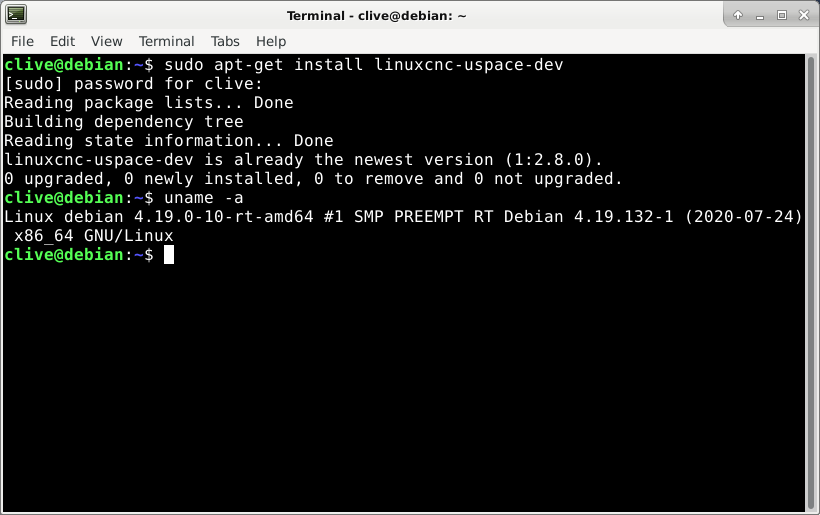

If you are using 2.8 there is no need for 2.9, just the dev version of 2.8
sudo apt-get install linuxcnc-uspace-dev

13 Oct 2020 05:05 #185954
by Clive S
If I do this will it write over my version? I think I need a bit more guidance before i do it.
All I am trying to do is install the toolchanger.comp
Replied by Clive S on topic BOXFORD 125 TLC Tool Changer Setup

It will not change the version of LinuxCNC that is already installed, it will just add the dev stuff from the same version.

Thanks I have done that and it seems I already have it
So What don you think I am doing wrong with the compile

Nice, so you just do
Halcompile --install toolchanger.comp
