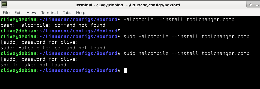

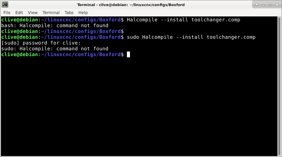

You asked me to do that A few post back. I have tried it again this is the result.
This terminal was opened in the linuxcnc config folder with the toolchanger.comp in it.
I do appreciate the help Tom

Replied by tommylight on topic BOXFORD 125 TLC Tool Changer Setup
Cr@p, lower case everything.
Sorry, habit.
Sorry, habit.

13 Oct 2020 14:49 #185987
by Clive S
Ok a bit nearer.
sh: 1: make: not found
Replied by Clive S on topic BOXFORD 125 TLC Tool Changer Setup
Sorry, habit.
Ok a bit nearer.

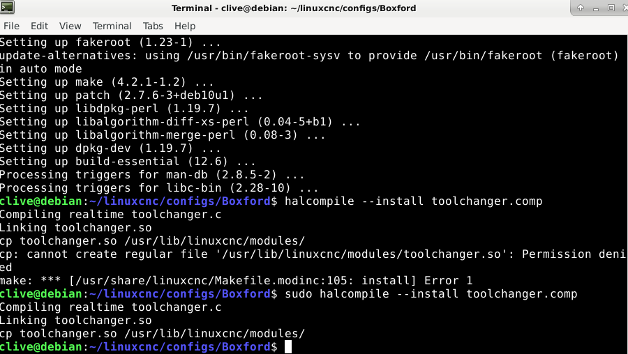

Seems like a missing compiler, no idea what or how.
Try
sudo apt-get install build-essential
Try

13 Oct 2020 15:06 #185990
by Clive S
Getting better does this look like it's done it
Try

13 Oct 2020 15:11 #185992
Yup, that is OK.
In hal,
loadrt toolchanger
addf ....
and link hal pins.
In hal,
loadrt toolchanger
addf ....
and link hal pins.

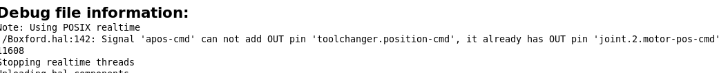

14 Oct 2020 11:49 #186088
by Clive S
Ok it seem I need the manual tool change loaded as well as it does have a manual jog
net apos-cmd joint.2.motor-pos-cmd => stepgen.2.position-cmd
net apos-cmd toolchanger.position-cmd => stepgen.2.position-cmd
The error is signal apos-cmd cannot add OUT pin "toolchanger.position-cmd" it already has OUT pin "stepgen.2.position-cmd "
So how do I solve this
