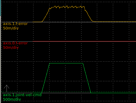

OK Guys here you go. I took a video showing a low P of 2 and zero'd everything else out. Both my X and Y axis behave the same way so I'm showing the Y in this video for you.
I increase my FF1 from .0001 all the way up to 5 or something like that in increments of 10x.
I'm really wondering if something else isn't going on here.
photos.app.goo.gl/oqbGoHKv87WvgT6G6

What sort of feed rate are you commanding and what is your acceleration set to in your ini file?
Whatever your commanded feedrate is, is that the value that is showing on the screen while the axis is moving? They should agree. If not, there may be a problem in the velocity loop rather than the positioning loop that your are working on. To put it another way, if you command a move of several inches at say 20 inches per minute, does the display screen show "Vel 20" ?? It should.
Reasonable values of FF1 would be in the range of 1 to 4 as a rough idea.
The halscope display changes are not what would be expected for reasonable values of FF1. Your problem does not appear to be related to tuning of the position loop, I think its elsewhere, possibly the velocity loop which is between the motor and its drive.
Have you verified and/or tuned the velocity loop as PCW suggest in a previous post? That has to be right or tuning the position loop with halscope is hopeless.

Hi Gmouer, Thank you for the reply. OK where to start!
First I did try the tuning that PCW first recommended, but it never said it was velocity tuning, it merely said tuning a velocity mode drive. So if you look back and see I was trying to ask the question of the group if I have velocity mode drives. So I was getting the impression that I do and therefore I was trying to do the tuning that PCW recommended.
Now to that Servo Tuning Tutorial from John T., he never says this is to tune your velocity loop, do this first then tune your positioning loop. He just speaks of tuning in general so it's great that you guys are finally saying do things in this order. That is not clear in either Tommy's tutorial or John's tutorial. -Maybe we can make that more clear with some edits.
So in John's velocity tuning tutorial, it gives me an equation for FF1 10/Velocity in units per second. My machine moves 98 inches per minute (yes I just verified this) giving me a value, if my math is right, of about 6.135 for my FF1. But am I setting FF1 right now to 6.135 then trying to find my max P? Or as in the other tutorial am I to set FF1 to a very low value at first to find max P?
Also am I to use a short jog as in Tommy's tutorial or a long jog? Furthermore am I to use a high velocity jog (long or short?) or a low velocity job as in Tommy's tutorial. -You see John's tutorial might seem great to everyone who does this stuff a lot, but to me just learning; it's leaving out some important details.
If you guys help me fill in these questions I just asked I think I can get it!
Then I suggest we fix John's tutorial up a bit for others. I'll be happy to then go through Tommy's tutorial with the same eye to detail and help call out areas where we can be more clear with instructions.
So the big questions on John's velocity loop tuning tutorial are:
- do I set P to max stiffness with
-A: FF1 set to 6.135 or
-B: FF1 set to .001
-And do I do a rapid long jog or a rapid short jog?
-Or do I do a slow long jog or a slow short jog?
Also, what the F is hand tweaking FF1? Does that mean using my hand controls on the machine instead of the servos? -And then again he speaks of that darn low P here which led me to trying the super low 2 in my P value for that video. -Hopefully this helps to clear up why I am so confused.
Thank you guys for taking the time to care enough to help me!

03 Jan 2019 21:22 #123430
All of the tutorials you've mentioned are referring to tuning the position loop in linuxcnc when using velocity mode drives.
When tuning, to start out, I would send a comand to move the motors at about half the max velocity, with a move long enough to have a steady flat cruse at that velocity so that you can easily see the servo settling at a steady constant speed.
(for the machines I've worked with about 1/2" is often a good distance. But what the best increment may be will depend on the velocity of the command and your acceleration setting. You also need to be certain that your acceleration rates are set to something that is actually achievable for your system.
I will often rough tune the P first, finding the highest value that doesn't osculate, both during the move and at rest.
Then for tuning the FF1, Set the P to about half of the above, and then set FF1 to the value that minimizes following error during the steady constant velocity part of the move (the flat top.)
Then use FF2 to minimize the following error during the acceleration parts of the move.
Finally go back and fine tune the P to the largest value that doesn't oscillate during the move and at rest.
None of this will work if you don't have the max acceleration (or max velocity) set correctly. The PID loop needs to have enough headroom to correct itself during acceleration. Watching the output of the PID loop when tuning, to make sure it never saturates is a good idea.
Your calculated FF1 isn't right. If your machine moves 98ipm (= 1.63333 inches/sec) when 10v is applied. The FF1 should be .163333. (but I'm not certain that will be right) What I am certain of is that you should probably have the max velocity in Linuxcnc set to about 1.3333ips (80ipm).
When John talks about hand tweeking FF1 he is talking about fine tuning the final value according to the real measurements in hal scope and not relying on a calculated value.

Hi Todd, thank you for the reply. My max velocity is set to 60 ipm on the machine, so I am surprised it does 98ipm. Again this is probably something set wrong and I need a more basic starting point. Perhaps my analog drives as I stated before. It may be that my TC and TAC are out of wack in some way. It seems hard to fathom that the machine would run so "well" if they are out of sync that badly but who knows? I need someone who's good with old servo drives to help me there possibly.
So yes maybe that needs to be my starting point but I might need some help/advice in that realm.
So thank you for the answer on how fast to set my speed (half my max) and far to move (perhaps half an inch, long enough to get a steady flat top on my F-Error channel?) -not sure which channel I'm supposed to watch, maybe velocity cmd channel?
Also you must forgive me but if John's tutorial is right he states: FF1 - Should be 10/Velocity@10V (velocity in machine units per second). We both agree my velocity is about 1.6315 ipm ...if that's the case then John's equation, as he has it written is (10 / 1.6315) which equals 6.129 in my case. But what you said is John's equation is backwards and should be: FF1 - Should be Velocity@10V (velocity in machine units per second) / 10. Which in my case is 1.6315 / 10 ( .163 ). So hopefully you guys can see what I mean when I state that there are some glaring problems we need to work together to fix if people are to follow these tutorials. I am happy to help fix them if you guys will just help me figure things out.
- hatch789
- Posts: 143
03 Jan 2019 23:23 #123440
by hatch789
Replied by hatch789 on topic PID issues or calibration help
So with Todd's help in figuring out that John's equation was inverted, I was able to achieve max stable P values of 65 with FF1 at .163
Now I'll start to see if I can (as Todd said) drop my P to 30 (about half) and start trying to tune FF1 as per the tutorials. Here's a screenshot of my Follow error with P at 65 and FF1 at .163 just so you guys have a reference.
- Posts: 18092
- Thank you received: 5324
04 Jan 2019 01:26 #123446
Replied by PCW on topic PID issues or calibration help
A FF1 tuning hint is that if the following error is in the same direction as the velocity,
you need more FF1...
