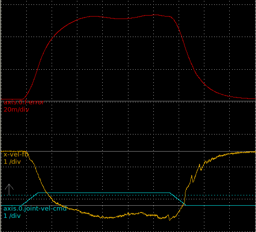

Sure thing OT!
OK Guys, I found how to read my voltage and it appears to be accurate as I checked it on my volt meter at the same time I was watching the screen reading in hal monitor.
When I'm moving in a positive X direction (to the right) my voltage is negative. In this screenshot it is -2.4v.
PCW said about using +10 or -10v to test how fast I'd travel but the most I am pushing right now is about 8.6v or -8.6v depending on which way I go. I'll need to figure out how I can increase that to +/- 10v. Then I can figure out the true ips travel I guess?

Replied by PCW on topic PID issues or calibration help
That does not look like a velocity mode drive,
Can you post the hal/ini files at the same time as the plot?

Remember I have resolvers, not encoders. Not sure if that makes a difference.
I just looked to verify and I had already posted my HAL and my INI files in the first message of this thread.

So where do I go from here? If my drives are not velocity mode drives can I still do some kind of calibration or am I just stuck? I'd like to think I can do some things to improve performance and accuracy. Please let me know what you guys think I should do from here...
Remember I'm using Servos with Resolvers here My old WestAmp Analog Servo drivers. I think these are A651 series analog drives. I attached the PDF (Spec) earlier in this thread if anyone wants to see it.

Your drives may be velocity drives that are not functioning properly. (If they are not receiving the tach feed back, or aren't configured correctly.)

Your drives are velocity mode servo amplifiers! These were very commonly used on machines the age of yours. The same design was sold as Baldor, Servo Dynamics, Westamp and maybe others over the years with very minor changes. Tune them using the instructions that are commonly available on the web and here then connect to LCNC and tune your PID components. If you just changed cards without transferring the personality header they are most likely NOT tuned to your motors or dynamics anymore.
Who build the original controller and what was the model number?
