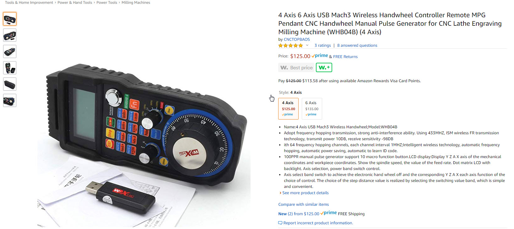

Looking to purchase a MPG for LinuxCNC would you recommend this model?
The got the WHB04B 4 axis model for $125 on amazon.

09 Oct 2019 16:10 #147573
by satiowadahc
Replied by satiowadahc on topic XHC-WHB04B-6 LinuxCNC not working
I'm currently working on updating the driver for whb04b-4 model. I currently have the pendant updating the hal pins correctly, I have a few issues on the return data to update the screen. If you use a machine kit varient you have the drivers but the current xhc-hb04 driver has a different usb protocol

10 Oct 2019 19:18 #147646
by satiowadahc
github.com/satiowadahc/linuxcnc/blob/2.8...er_comps/xhc-hb04.cc
Works with the simulator!
I'll need to check for a few more issues, such as it has to overwrite the old driver with out modifying the name. My next step from here is to refactor for a live machine running 2.7.
This is the first pendant Ive worked with, the machinists are using the xhc-hb04 but they're failing on the jog wheel. Give me a few more days and I should have better results

11 Oct 2019 13:21 #147701
by randypetersen
Replied by randypetersen on topic XHC-WHB04B-6 LinuxCNC not working
I am running "LinuxCNC Uspace 2.7.0 Debian 9 Stretch" because I have a MESA card. Will your driver be compatible?
Is this the MPG we are talking about:
www.amazon.com/Wireless-Handwheel-Contro...raving/dp/B07JN4P3YH
Just thought I would double check, looks like if I order it today, it'll be here next week tuesday.
If you think that's the one to get I will order it straight away.
Thanks for your help!

11 Oct 2019 20:46 #147721
by satiowadahc
I just set up a test box for it to compile over the weekend with LNCNC uspace 2.7 Debian wheezy. If it works on wheezy it *should* work on stretch.
I've tested it with
Kubuntu 16 - LNCNC 2.8, 2.7
Ubuntu 18 - LNCNC 2.8, 2.9
Debian Wheezy - In progress
Debian Stretch - In progress
I have it set currently for the 4 axis pendant but I can easily modify that for the 6 axis. The 4 axis seems to work really decent.
I've tested it with
