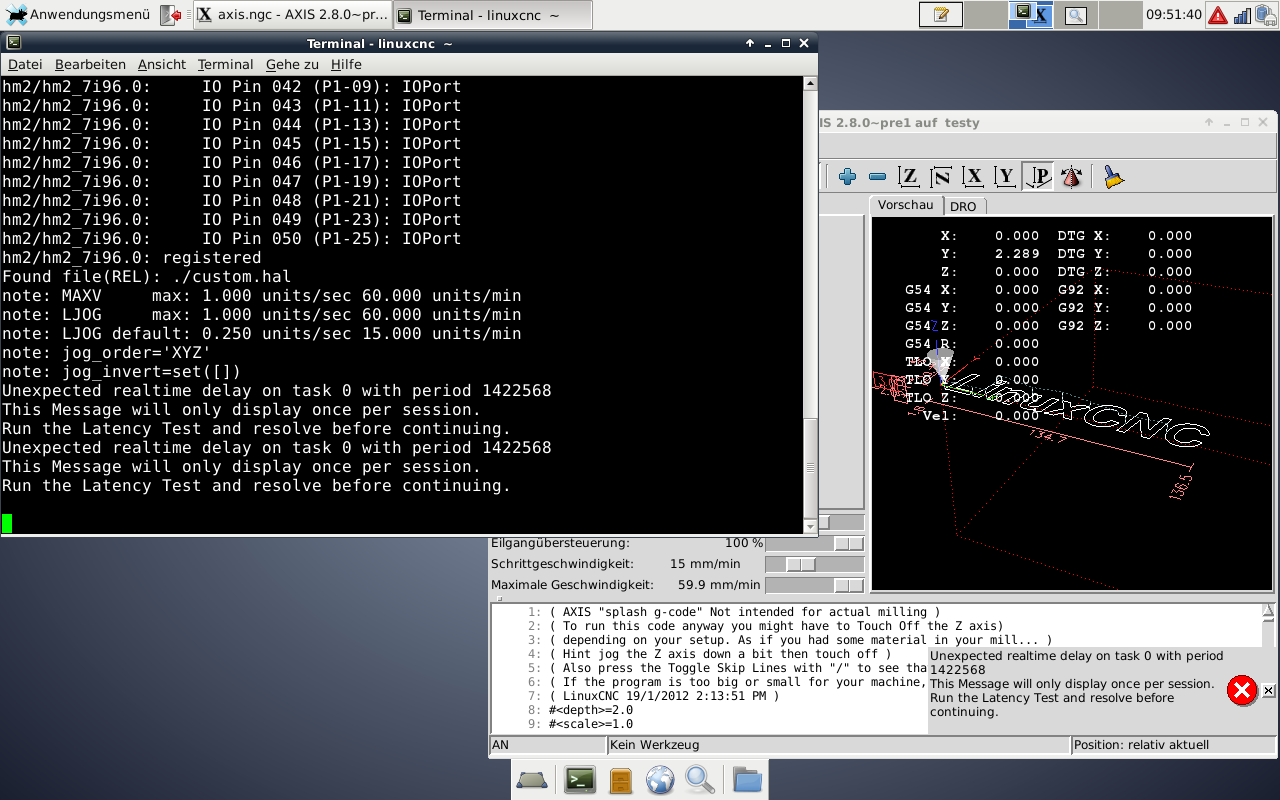

- Posts: 21986
- Thank you received: 7486
10 Feb 2019 12:16 - 10 Feb 2019 12:21 #126137
Replied by tommylight on topic Need help for school Project with mesa 7i96
There is something wrong with your config as a servo period of 1.4something milion is not right, and that shows that your computer has a very high latency that looks to be unusable.
Can you post your config files here so we can try to figure out what is going on.
Sorry just found them above.
The servo period should be 1000000 ( one million ), the display section for max_velocity should be something more than 1mm per second that is 60mm per minute and

- Stubenrocker3
- Posts: 8
10 Feb 2019 16:30 #126155
by Stubenrocker3
Replied by Stubenrocker3 on topic Need help for school Project with mesa 7i96
Here is my new conf
and I get a new error. It seems like he didn't like the 1000000 servo period
By the way thanks for your help, you are really saving me.

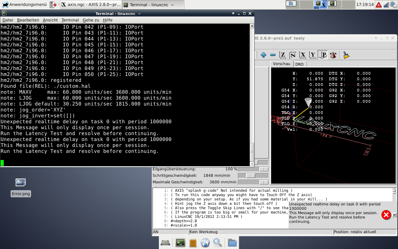

- Posts: 18105
- Thank you received: 5328
10 Feb 2019 16:33 #126157
Replied by PCW on topic Need help for school Project with mesa 7i96
A latency test would help determine your rough system latency,
but one thing that needs to be addressed is your Ethernet settings
The Intel Ethernet driver defaults to waiting in its interrupt service routine
for additional RX packets whenever it receives a Ethernet packet. This helps
thoughput for normal Ethernet use, since it eliminates the interrupt overhead
when multiple packets are received in a burst but its terrible for latency
To fix this you set a driver parameter called rx-usecs to 0. This requires the "ethtool" utility:
sudo ethtool -C eth0 rx-usecs 0
This will only set the parameter temporarily, to set it at system startup, follow the directions in the hm2_eth manual page
Note that your Ethernet port may not be named 'eth0' so change the
name in the command/ scripts to match the name of the ethernet device connected to the 7I96

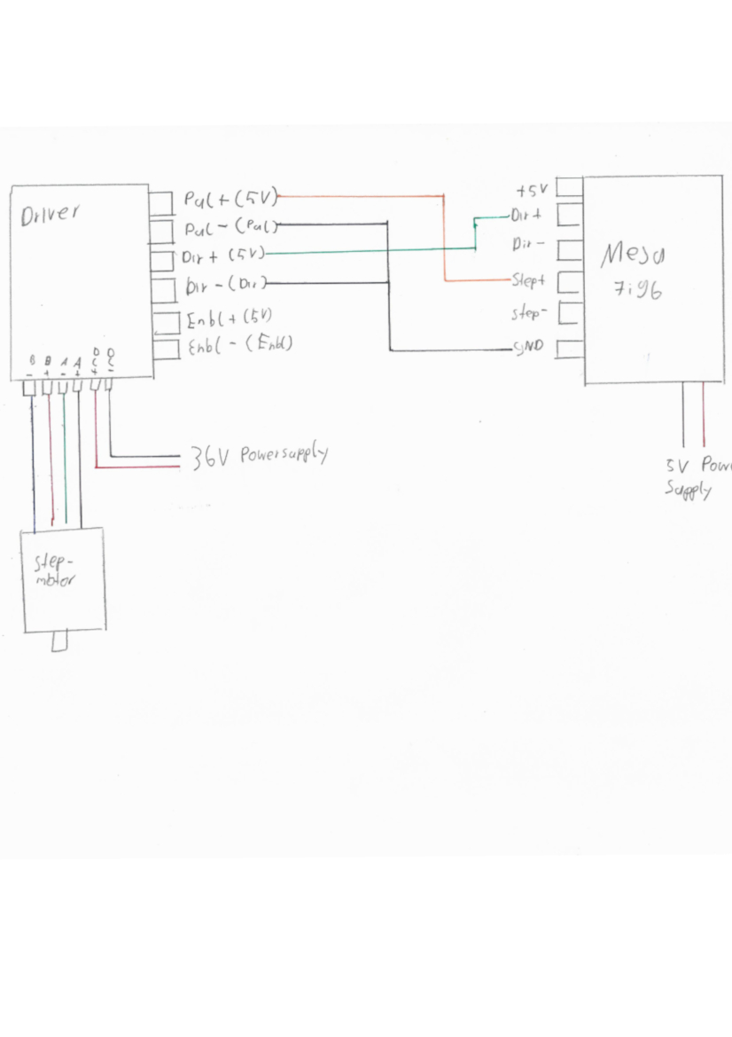

Okay I did as I was told. Now linuxcnc doesn't complain about the 1000000 servo period. The problem is my motor still isn't turning
Could it be that there is something wrong with my cabeling or is there still a major error in my conf? Furthermore do I need to configure the driversettings by flipping the switches? (all 8 are on off right now)
Edit: I messured the Step+ signal. Now I get something like 0.28V when I move the axis.
My cableing looks like this:
Last edit: 11 Feb 2019 18:13 by Stubenrocker3.
Wiring looks OK
Can you post your current hal/ini files?
