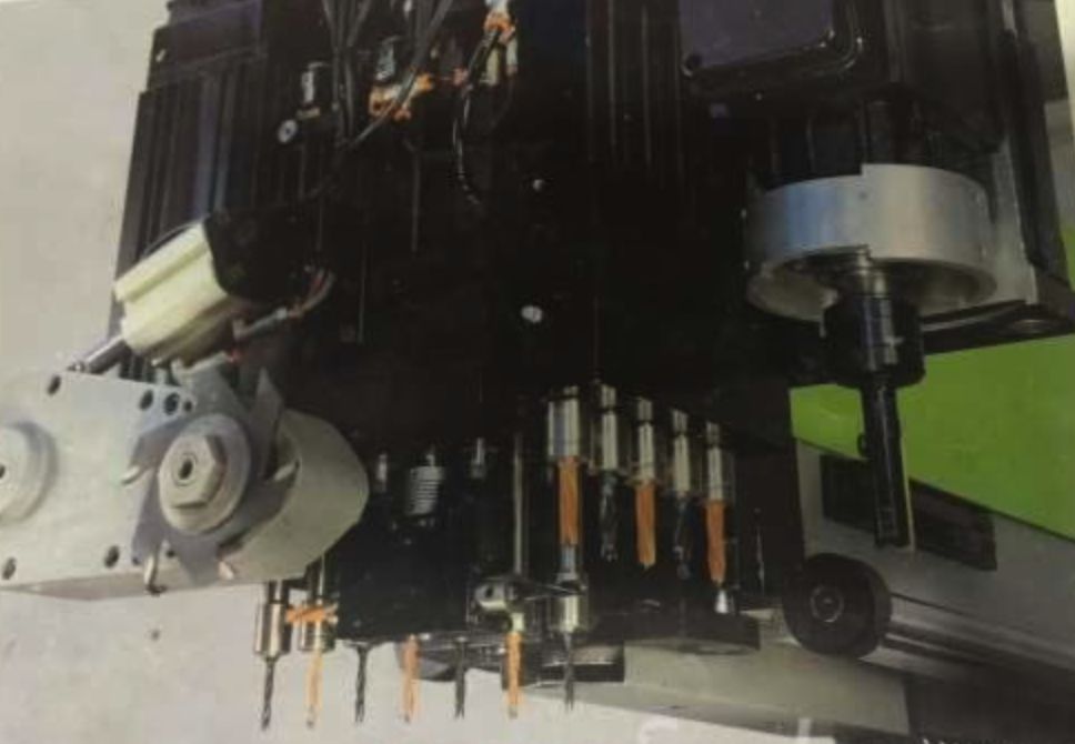

I'm new to Linuxcnc.
Currently I'm running LinuxCNC on a PC not connected to a machine.
I'm working on a retrofit with Mesa hardware.
My "old" CNC has a head with 18 different tools. (Biesse Rover 18)
Each tool is fixed on a pneumatic cilinder. This cilinder presses the toon down when selected.
So there is no tool change. Every tool has a fixed place on the toolhead.
My question is, If I change the X, Y and Z in the tool table in LinuxCNC for each tool, will this result in a "correction" so that the chosen tool is on the right location during milling?

How can I instruct LinuxCNC to use a different tool?
In the mean time I know that I can us T1, T2, T3, ... with an offset given in the tool table.
But my CNC needs to lower the correct tool by use of a pneumatic cilinder.
All the tools (I think 17) are fixed on one head. (see picture).
I need to tell LinuxCNC to lower the tool and use the correct offsets.
The pneumatic cilinders will be connected to an output on the 7I77.
I've read the LinusCNC documentation, but couldn't find the answer.
I'm new to LinuxCNC, and it looks like there's much possible, but much is hidden

09 Apr 2019 22:26 #130577
Replied by andypugh on topic Multiple tools on the CNC
I think you can do it all in HAL.
linuxcnc.org/docs/devel/html/man/man9/demux.9.html
You can (pretty much) just connect iocontrol.0.tool-number to the demux.0.sel-u32 pin.
The only minor problem is that the tool number is signed, to you need to convert it before passing to the demux.
linuxcnc.org/docs/devel/html/man/man1/iocontrol.1.html
linuxcnc.org/docs/devel/html/man/man9/conv_s32_u32.9.html
In the HAL file:
In the HAL file:
loadrt demux personality=18
loadrt conv_s32_u32 count=1
addf demux.0.servo-thread
addf conv_s32_u32.0 servo-thread
net tool-num icontrol.0.tool-number => conv_s32_u32.0.in
net tool-u32 conv_s32_u32.0.out => demux.0.sel-u32
net tool1 demux.0.bit-01-out => parport.0.bit-00-out
net tool2 demux.0.bit-02-out => parport.0.bit-01-out
net tool3 demux.0.bit-03-out => parport.0.bit-02-out
net tool4 demux.0.bit-04-out => parport.0.bit-03-out
