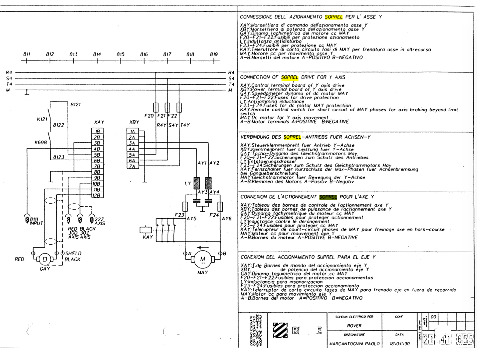

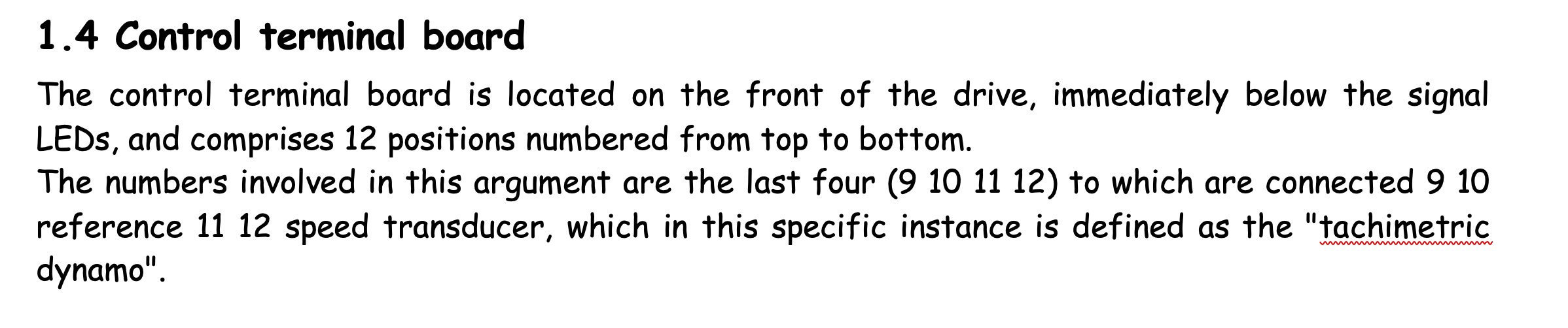

His is the schematic.
There are 2 connectors on the driver.
1 for the pover (nothing to change here)
and the other for the controls.
Pin 1B to 8B are connected to de enable, E-stop, ...
Pin 9B and 10B are connected to the controller
Pin 11B and 12B is the tachometer input
So I think, pin 9 and 10 are the +-10V input from the Mesa 7i77 (motor speed/dir)
The current controller has 16 inputs and 40 outputs (relais) wired.
But it will depends on how I want to use and rewire the machine.
Currently all the E-stops, driver enable, air pressure sensor, ... are in serie, and use only 1 input.
Maybe I'll seperate all this and use more inputs to make it more clear. All I have to do is learn Classic Ladder
