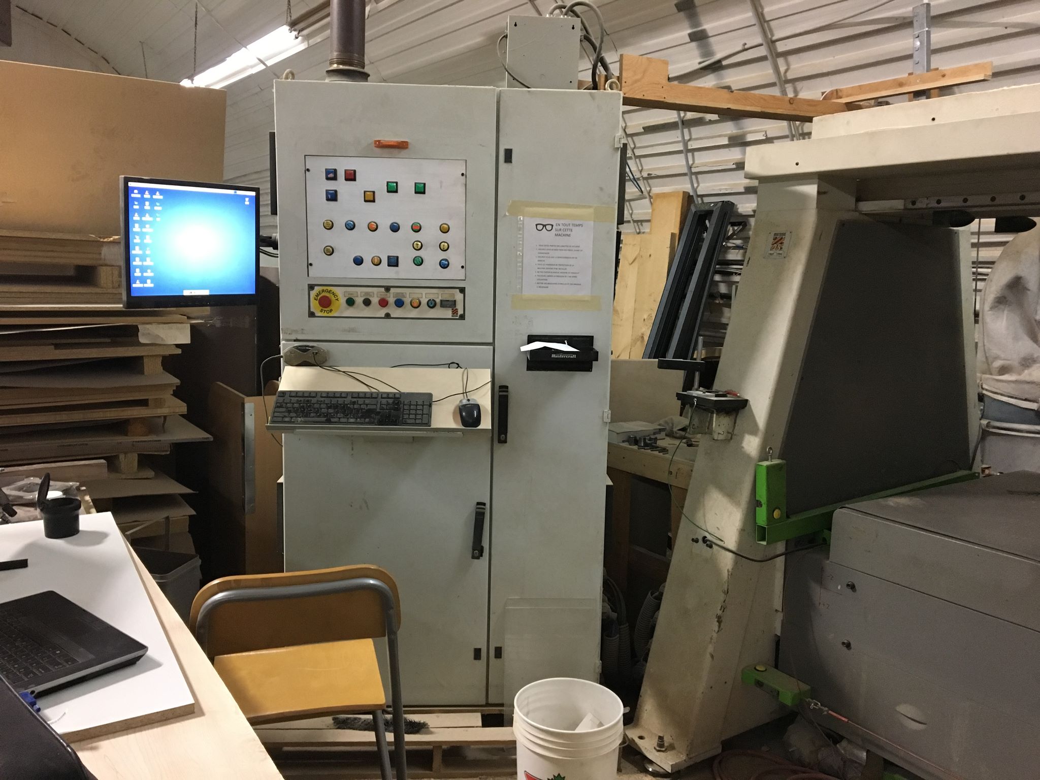

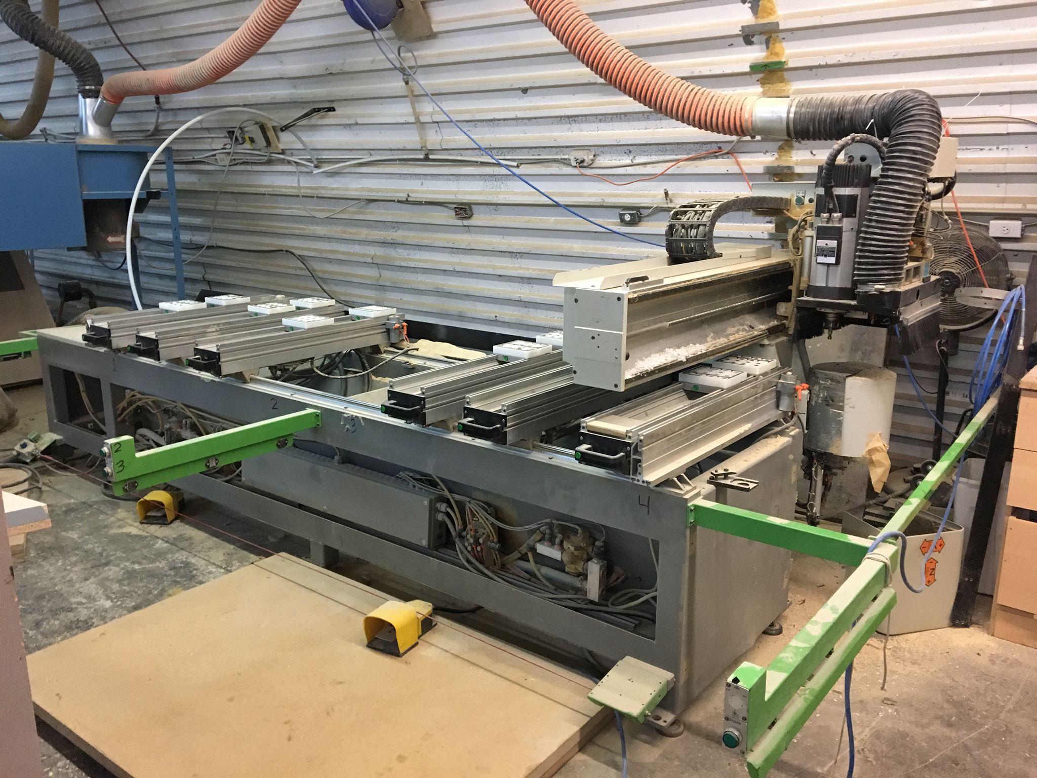

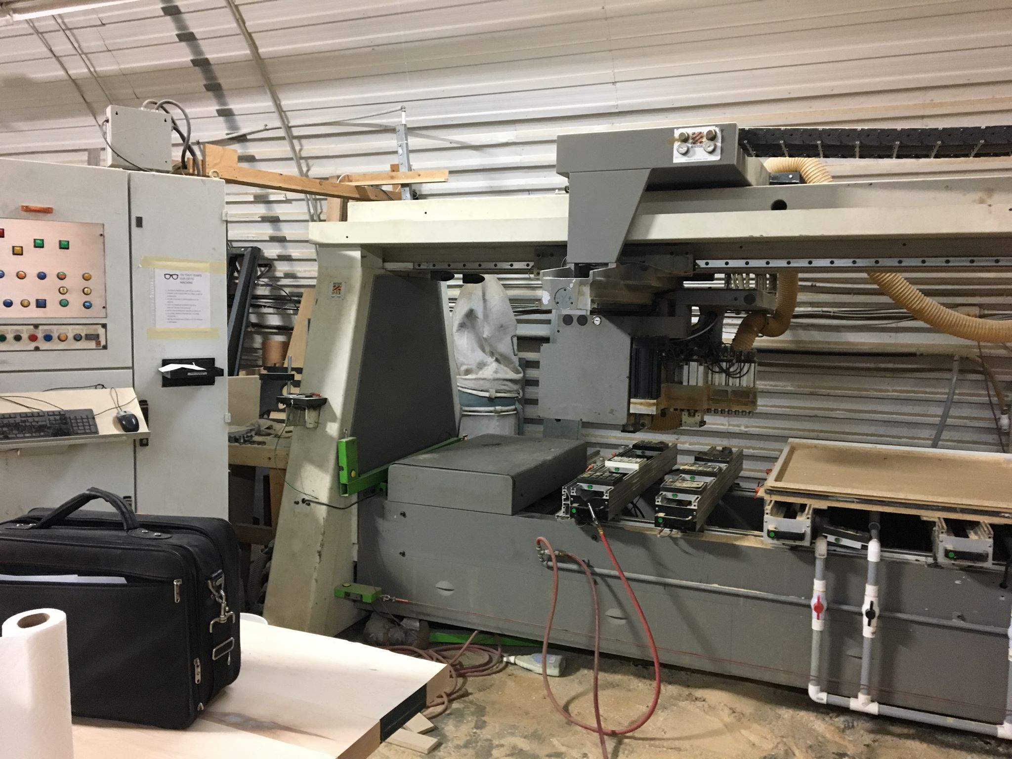

I have a Biesse Rover 346 with 40 drills and three spindles. I went with remapping M6 in python.
The code for my Biesse remapping is here. Biesse Rover 346 remap[ M6 in python
The machine is currently in production. All works including all side drillls, spindles and side aggregate for horizontal milling.
The Rover 18 I dont think has a tool changer. This would be kinda easy with a remap.
I have three spindles and one VFD and route the VFD signals through a contactor along with a spindle selector contactor so whatever spindle I command, I energize the contactor. For the gang drills, you need to energize the motor in the remap instead of the spindle, depending on tool_selected. So you should send your three wires going to your spindle through a contactor and you can select spindle or gang drill motor in the remap. Also because m3 is controlling the spindle, you need to shut off the gang motor when you get M5. I chose to remap M200, this shuts off gang motor and raises all tools and spindles.
One other thing is the pre logic for the Biesse, thermic switches, air etc... needs to be clear before you get a green lite. I left that logic there and ran the estop through that logic. So when power up, you use the same step, to get the green lite on the Biesse before you can clear the estop. IT works well.
Rover 20 in the shop about to do a retrofit on.
My Biesse Rover 346

Another way is to do an ngc M6 remap.
I seen a guy on here remap an mcode for every relay, and in his ngc m6 remap just use mcode for the relay you want to use.
You would have to learn 274ngc language. Its awkward to me and there is no manual that I could find that explains it all so I went with python.
