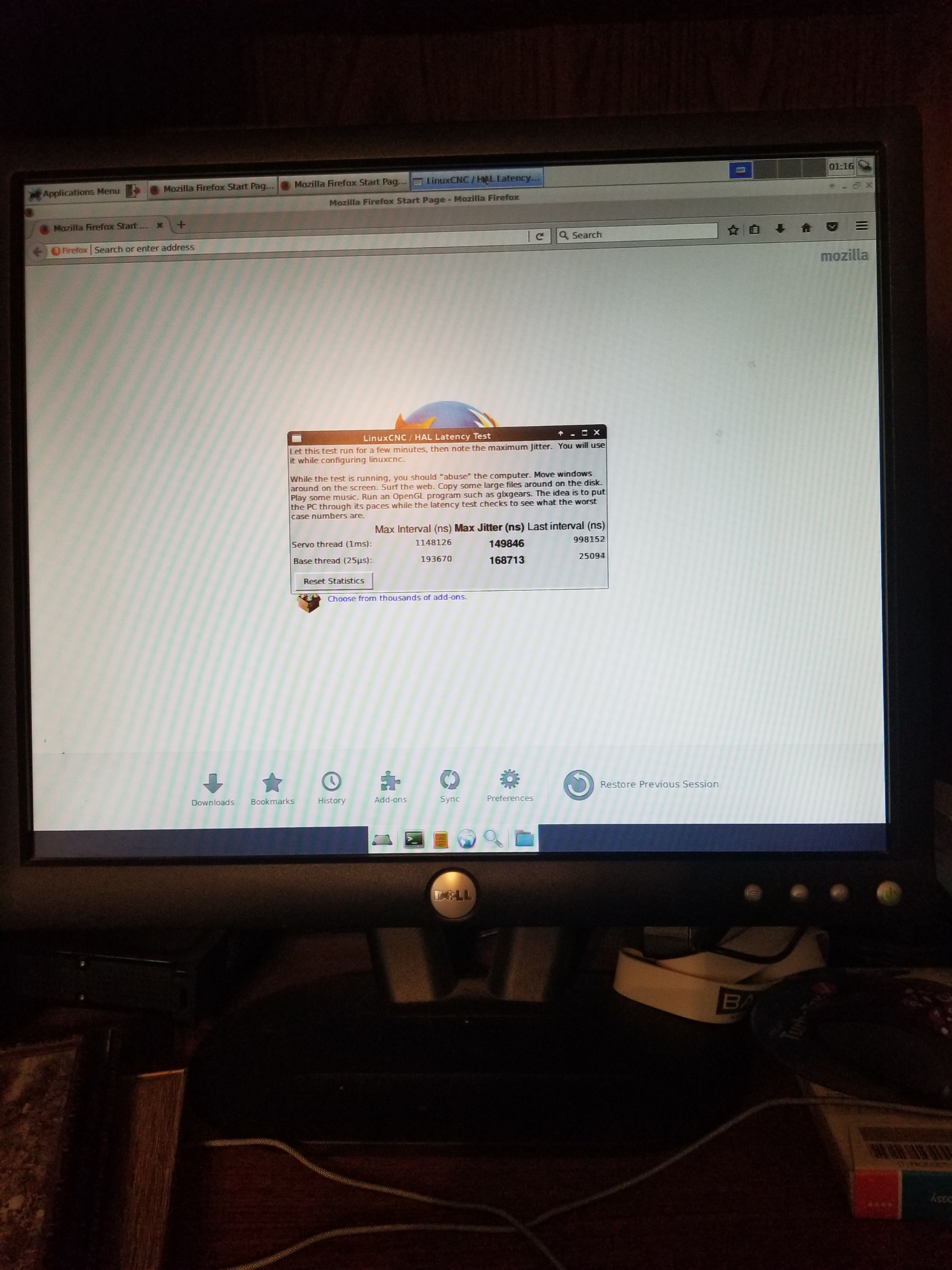

Just got a computer given to me. It was an Asus M2N-MX-SE-PLUS motherboard, AMD Athlon 64 X2 Dual Core Processor 5000+ 2.61 GHz, and 2 GB of RAM. I know this computer is approximately 13 years old. Am I wasting time with this unit?
Thanks,
JuniorC

What is a good range on the jitter

Replied by tommylight on topic Just Getting Started Have Servos Need Direction
For software stepping (parallel port) anything under 100k is ok, preferably under 50k. It can be used even with much worse latency for sure, but it does limit the maximum steps per second and subsequently the maximum velocity of the machine.
For Mesa boards, even 200k or more is usable and it does not impact the steps/s or velocity as the steps are generated by the hardware on the Mesa boards, preferably 100k.

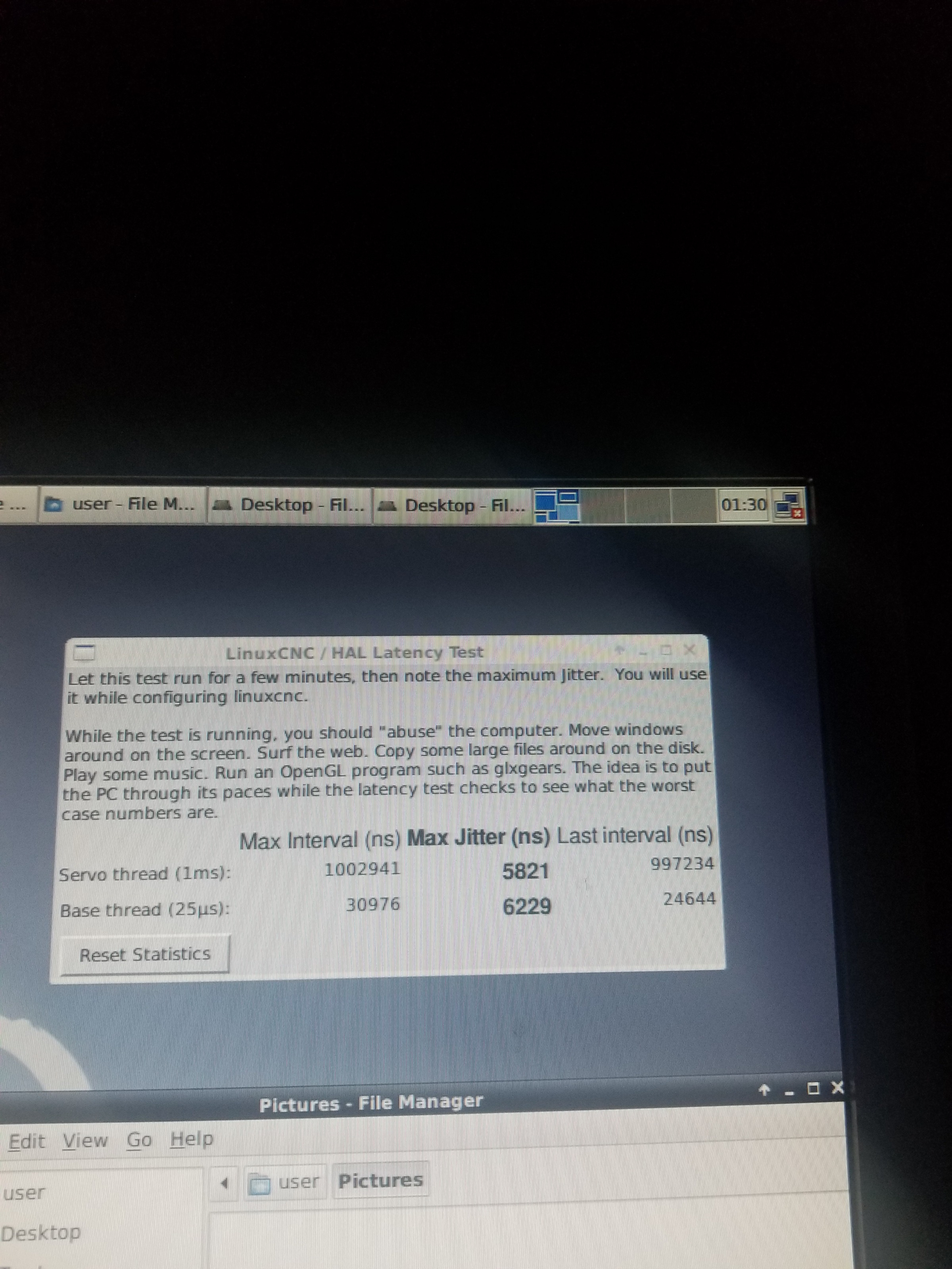

Thanks for the info. I'm just now getting LinuxCNC installed. The DVD drive wasn't ready my DVD. Had to change out the drive. I'll see how the computer does on the test.

I installed a wireless card and was able to the internet. I opened up several windows and the Jitter increased quite a bit.

23 Oct 2019 21:39 #148633
Replied by Todd Zuercher on topic Just Getting Started Have Servos Need Direction
its not unusual for a wireless networking card to have detrimental effects on latency.

Replied by JuniorC on topic Just Getting Started Have Servos Need Direction
I'll try another test using an Ethernet cable to connect to the router. All the little things like this is good to know. I greatly appreciate the help.
