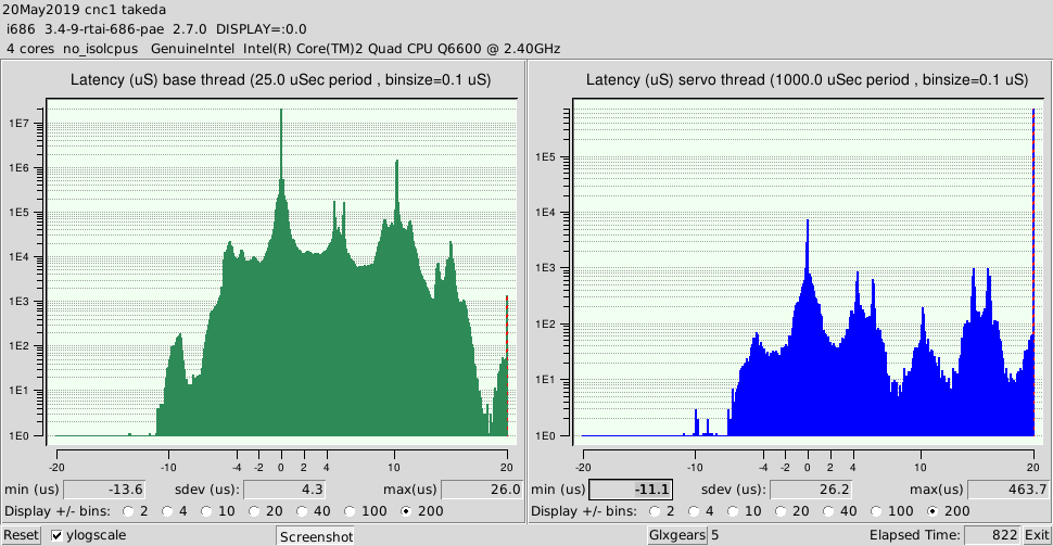

I have and old PC with the following CPU and onboard Graphics
- Intel Core2 Quad CPU Q6600 @2.4GHz
- NVIDIA Corporation C73 [GeForce 7100 / nForce 630i] (rev a2)
The motherboard is Gigabyte GA-73PVM-S2H (www.gigabyte.com/Motherboard/GA-73PVM-S2H-rev-10#ov)
According to what I read I should be getting low Jitter but I get
Max Jitter (1ms thread)
Max Jitter (25μs thread)
Before trying an external PCI-e graphics card (I can't any laying around) to see if improves latency, what else should I try?
Isn't this jitter too large for this setup?
I installed Debian Wheezy as is. No configuration at all on the machine.
uname -a prompts:
423122 (ns)
21171 (ns)
uname -a prompts:
Linux cnc1 3.4-9-rtai-686-pae #1 SMP PREEMPT Debian 3.4.55-4linuxcnc i686 GNU/Linux

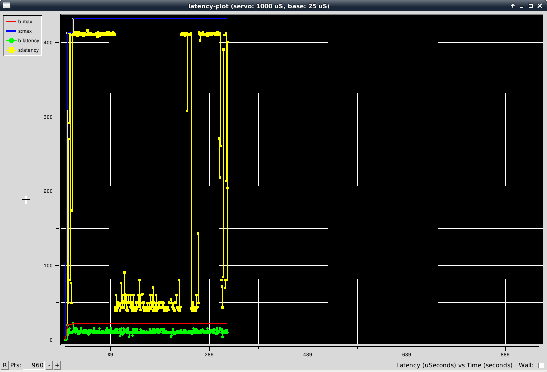

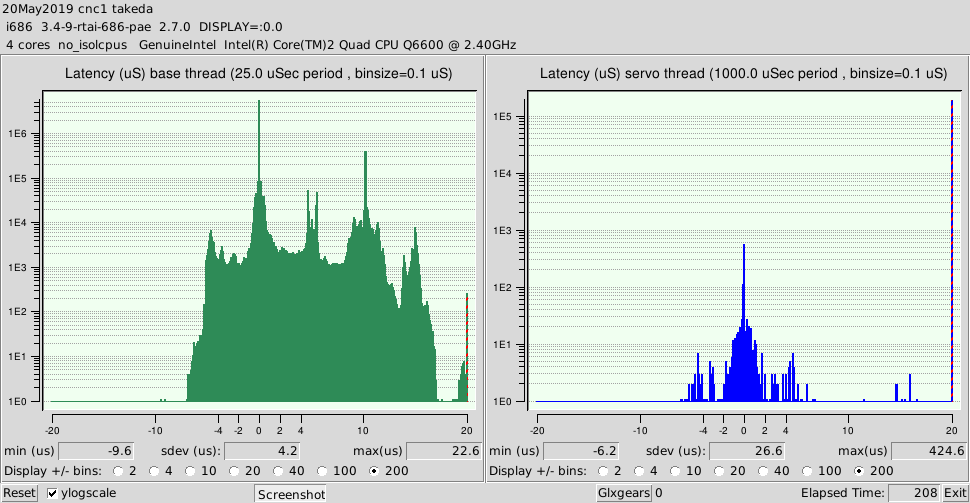

Changing to a PCI express GPU (as mentioned above) makes no difference. Still the same levels of max jitter.
I don't see how this could be relative to SMI as it does not make a difference the time vs max jitter. It's 425 micro sec on 1millisecond thread right from starting up the latency-test executable.
Also the BIOS has no such settings. I will add some screenshots.
