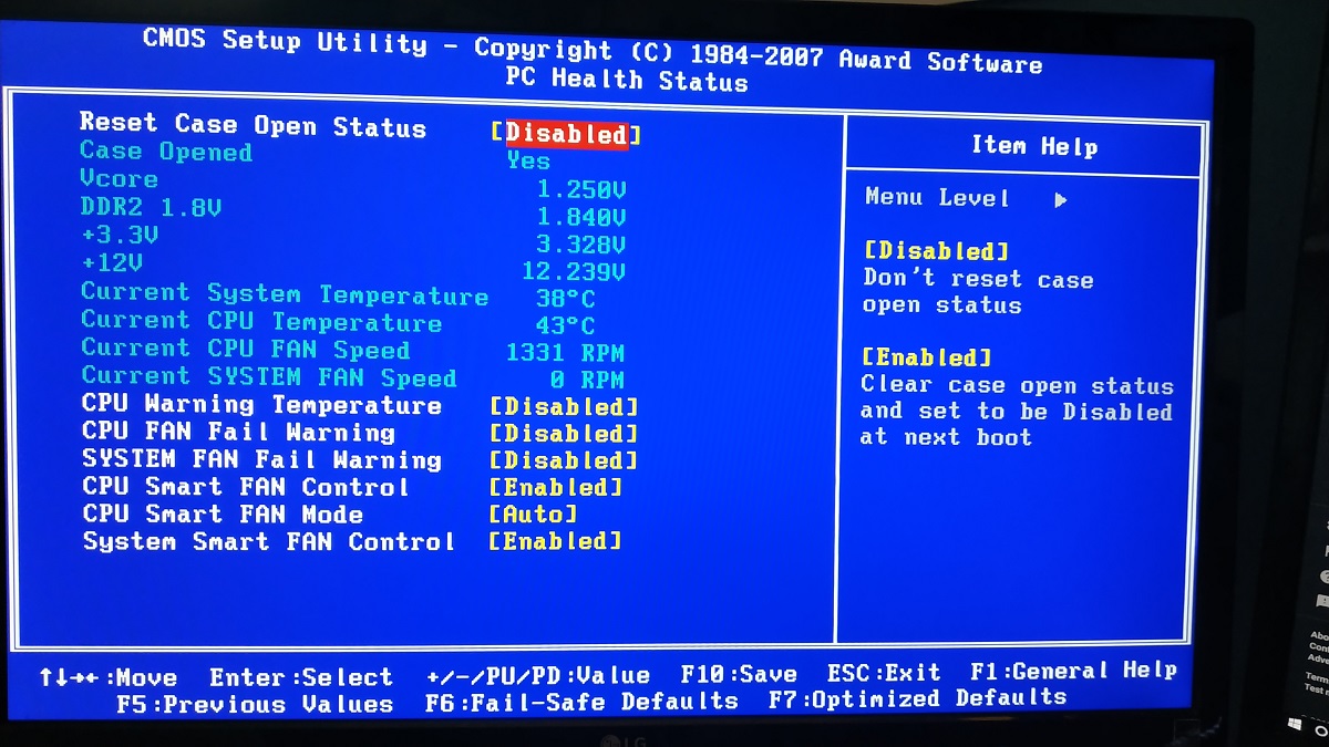

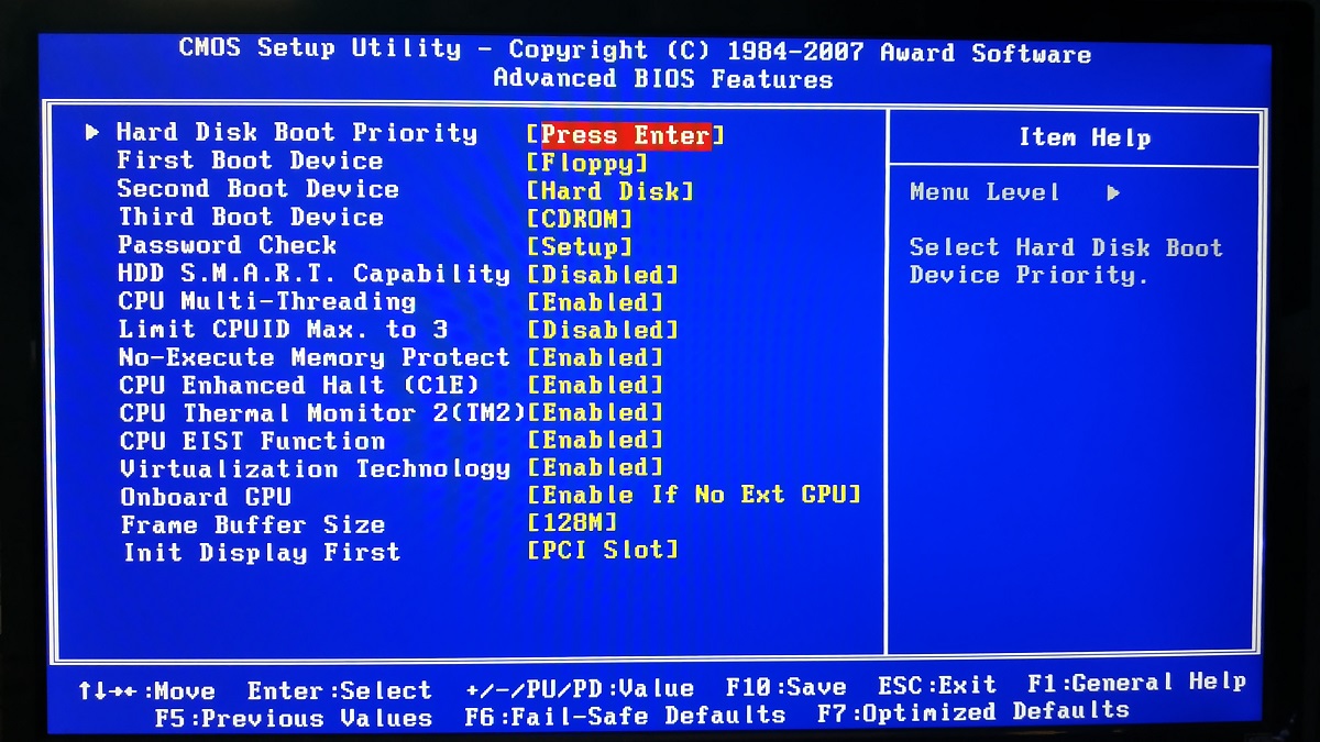

Replied by PCW on topic Latency problems on a fairly recent PC
Other things I would disable:
all fan control << re-enable if it does no help
CPU multi threading
CPU enhanced halt
CPU EIST <<< this by itself can be the issue
CPU multi threading
CPU enhanced halt

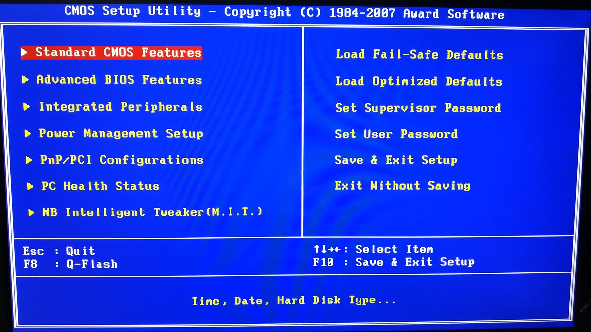

20 May 2019 16:46 - 20 May 2019 16:46 #134375
by petmakris

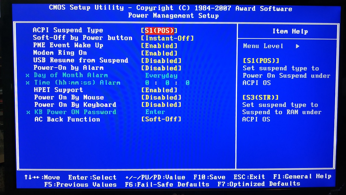

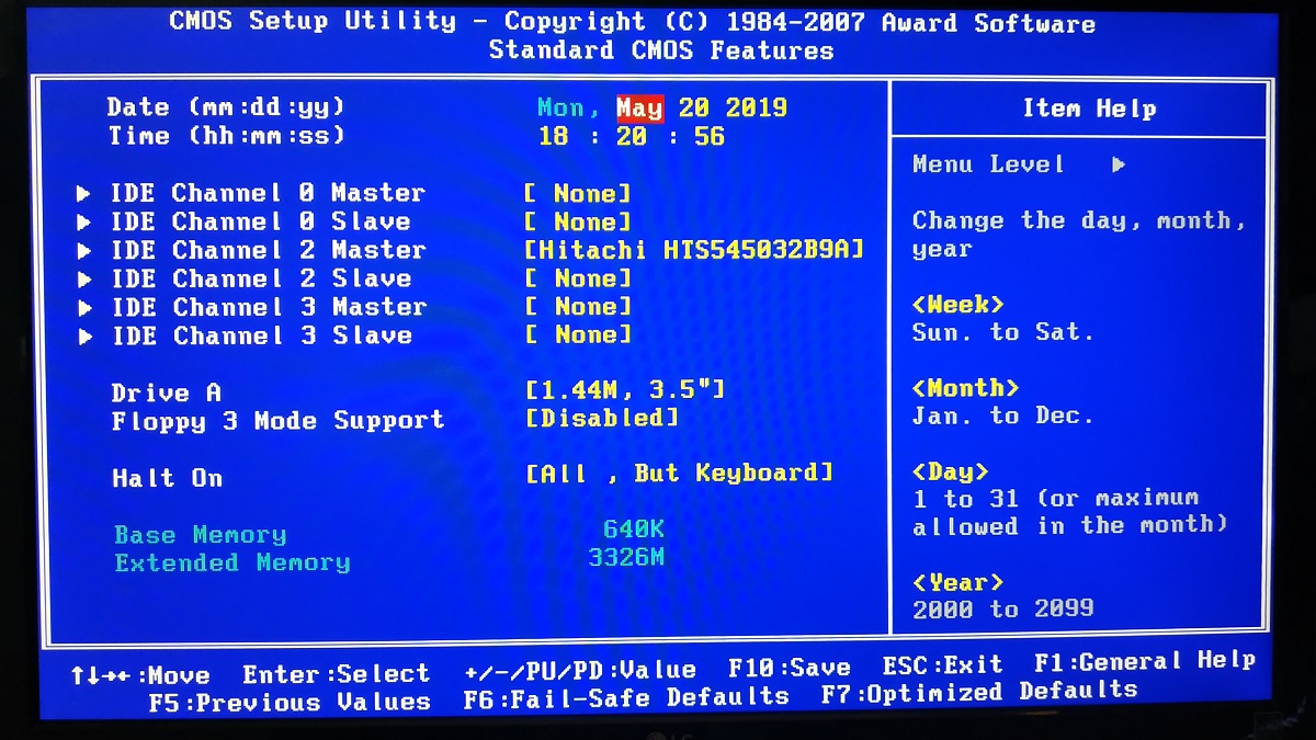

Can you provide a hint on how to disable EIST? I don't see such setting in the screenshots.
But.
I have good news!
Max Jitter (ns) 4197 Servo thread
Max Jitter (ns) 2784 Base Thread
Love it.
I tried multiple things in the BIOS before but did not work (some times I could not boot up)
I will shortly post a pack of screen that works for my setup.
Thanks guys again.

- Todd Zuercher
- Posts: 4785
- Thank you received: 1476
20 May 2019 17:10 #134378
Replied by Todd Zuercher on topic Latency problems on a fairly recent PC
If you still haven't found it, the EIST setting was on your 3rd screen photo above.
CPU EIST function [enabled]

20 May 2019 17:43 #134383
by petmakris
Replied by petmakris on topic Latency problems on a fairly recent PC
For the record.
The only settings needed as I can tell are
Disable CPU EIST function
CPU enhanced halt
I have multithreading enabled and I have configured the Grub2 setting to used the last core.
Jitter is low as is.
CPU enhanced halt
