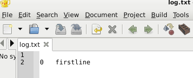

I made a short code example for your mars surface log file...
You could integrate this code in a component. Yourhal_line will be your input character text string in this case, could be
a complete g_code line.
Output :
Good luck !!
#include <stdio.h>
#include <stdlib.h>
#include <string.h>
#include <math.h>
char linebuffer[200] = "firstline";
int i;
//int main(int argc, char *argv[]){
FILE *file_write=fopen("log.txt", "w");
//Yourhal_line = linebuffer;
fprintf(file_write,"\n%d\t%s ", i, linebuffer);
i++;
fclose(file_write);
//}Output :
Good luck !!
